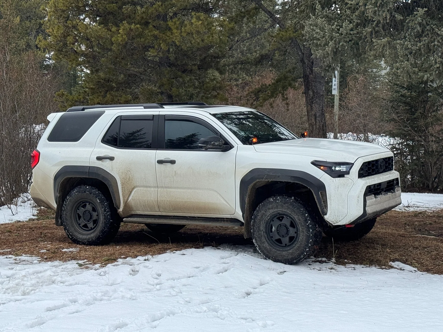

Updated with off-road testing trip review:
A day out testing the Old Man Emu & TIMBREN Offroad Bumpstops with my Daughter, and let me tell you it was fantastic!
We enjoyed a variety of trail conditions in higher and lower altitudes such as:
Pavement
Gravel
Soft Muddy
Icy & Hard
Deep Snow
our 4Runner took it all in and our Suspicion upgrade from Old Man Emu & Timbren made is a comfortable day exploring the out doors.
We had taken this same route with our stock suspension and the difference was night and day.
All I can say is I am very pleased with this upgraded package and now know we made the right choice for our 4Runner.
