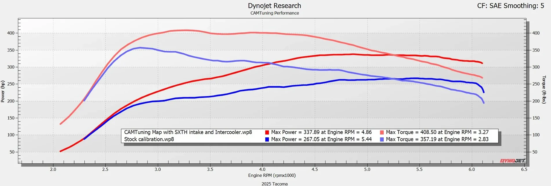

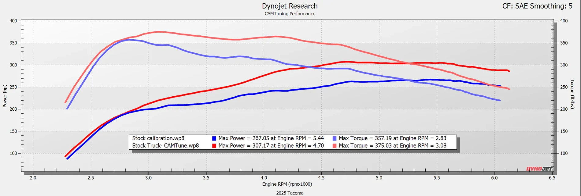

We are continuously logging and tuning a bunch of Tacoma and 4Runners at elevations ranging from sea level to 7000'+. As enhancements are made and new tables are revealed in Cobb's software, there will be improvements rolled out.
We have will continue to tune locally as well and will share dyno charts. If there's something you want to see, just let me know. This graph is on a 100% stock truck, vs stock calibration, on 91 octane.
2025 2026 4runner 6th gen We're Now Offering CAMTuning Performance Options For 4Runner 6th Gen! 1763261001256-nm
This is with SXTH's intercooler and intake and custom mapping on 91:
2025 2026 4runner 6th gen We're Now Offering CAMTuning Performance Options For 4Runner 6th Gen! 1763261315183-yh
