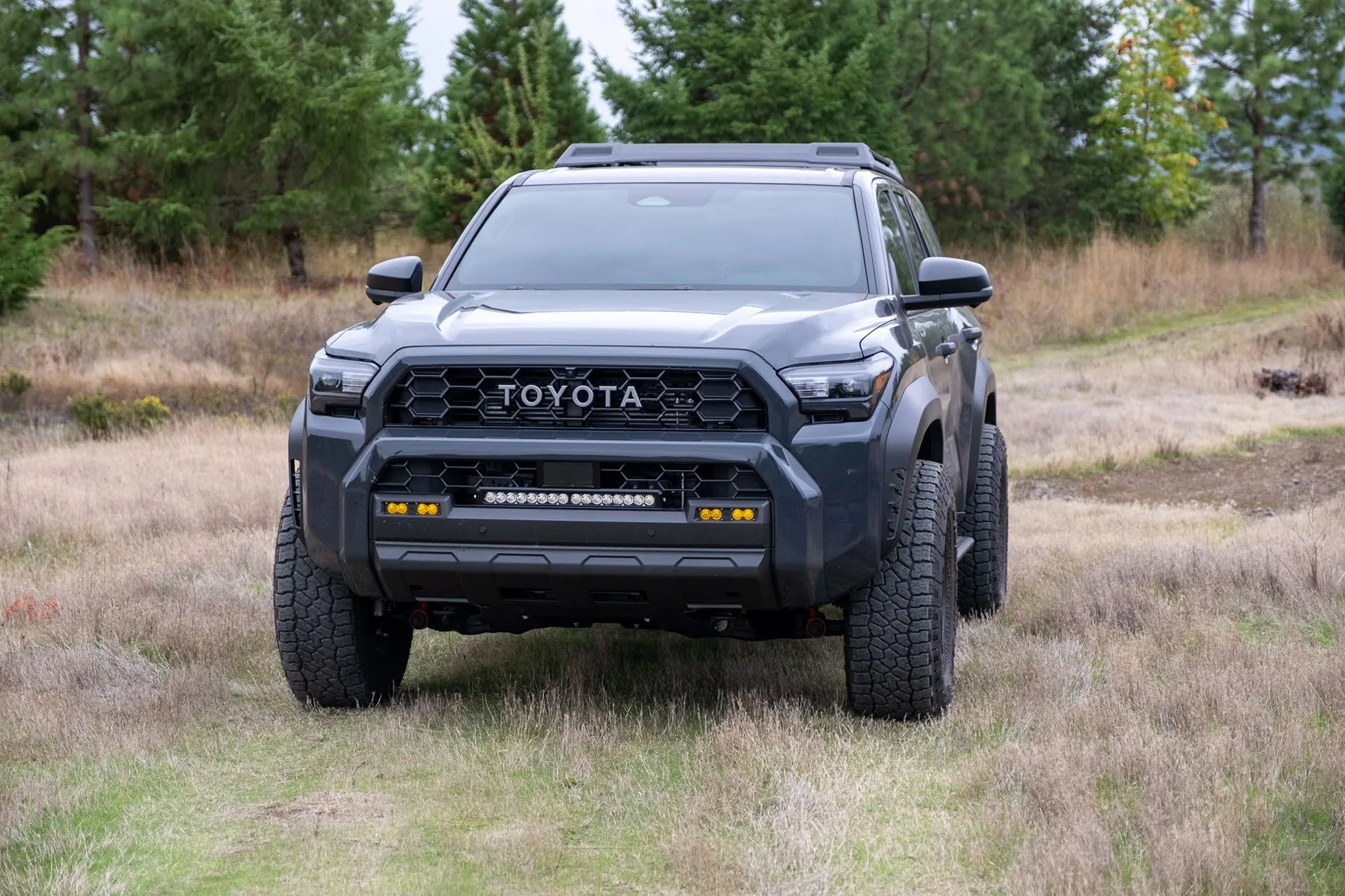

Find a friend who has already done it once to help. There is a lot of time spent just looking at how to take it apart. Once you've done it you can do it much faster the second time. It took 4 or 5 hours for me to do mine by myself but I also did the lower grille, added the lightbar, swapped out fogs, and had to do some wiring to make it all work the way I wanted it to with the Spod.
2025 2026 4runner 6th gen Grille Swap DIY install instructions video, nothing easy about it unless you do it every day. DSCF2134
