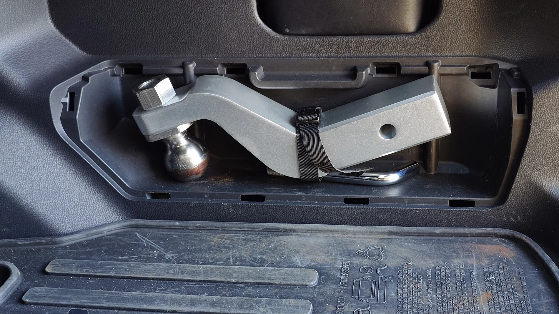

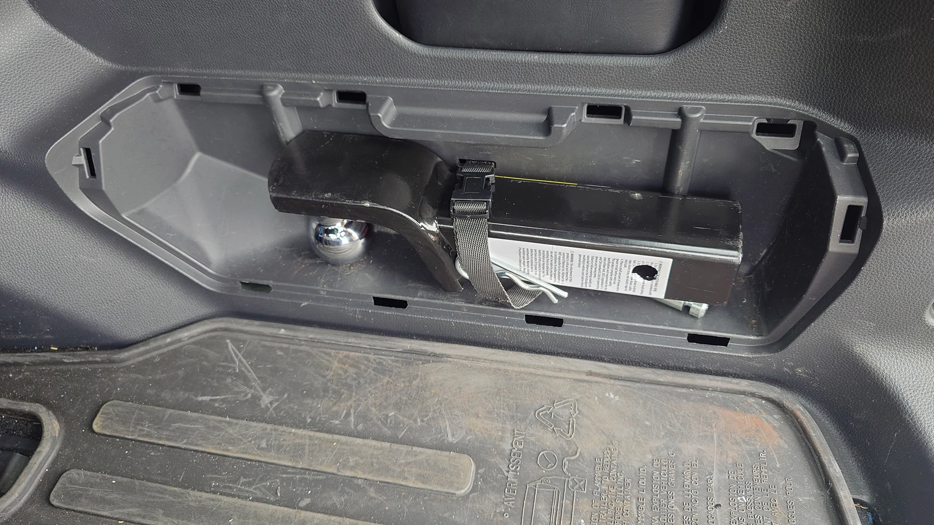

Awww yeah baby!
(updated video now includes removing and reinstalling the jack bracket)

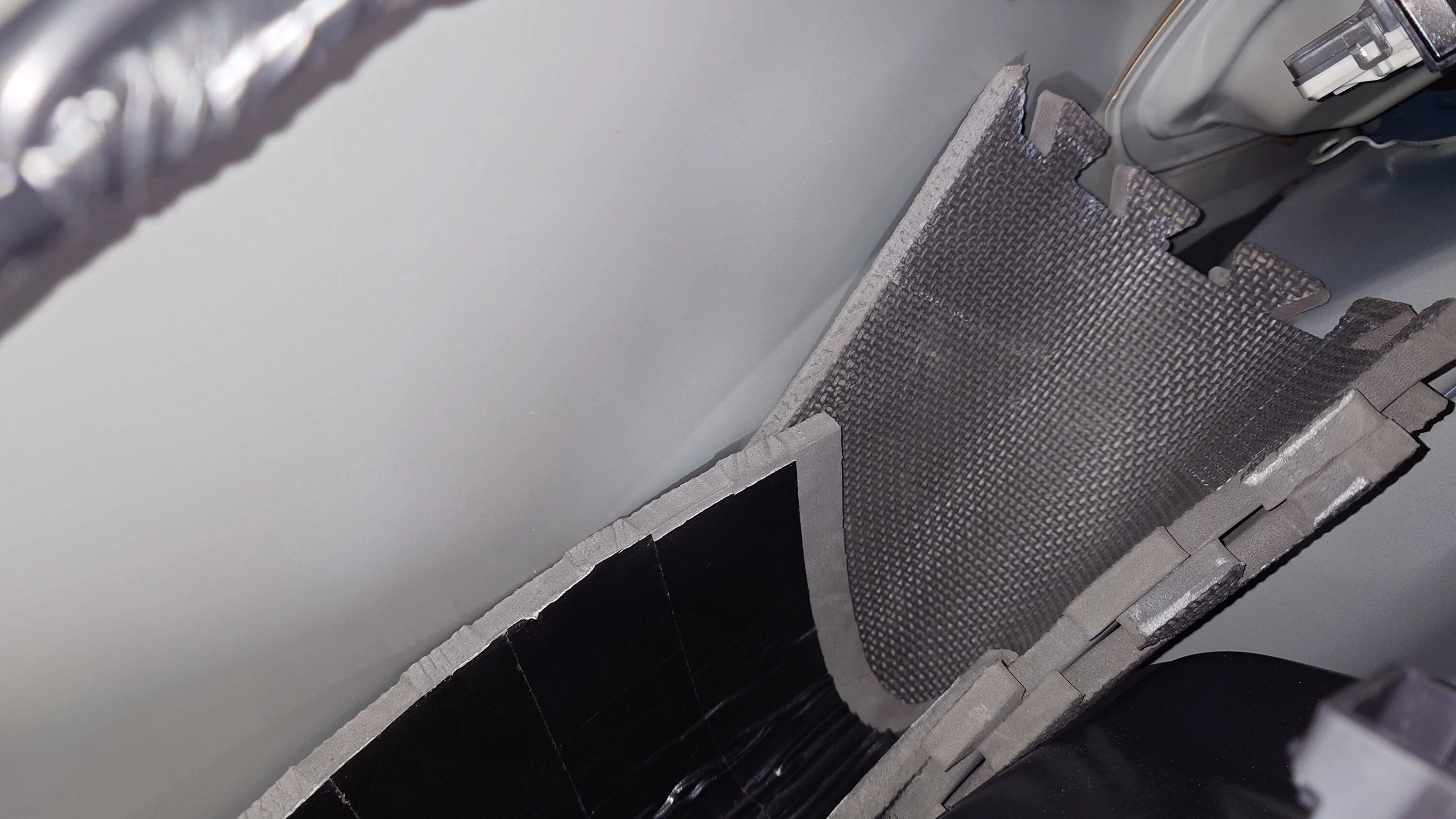

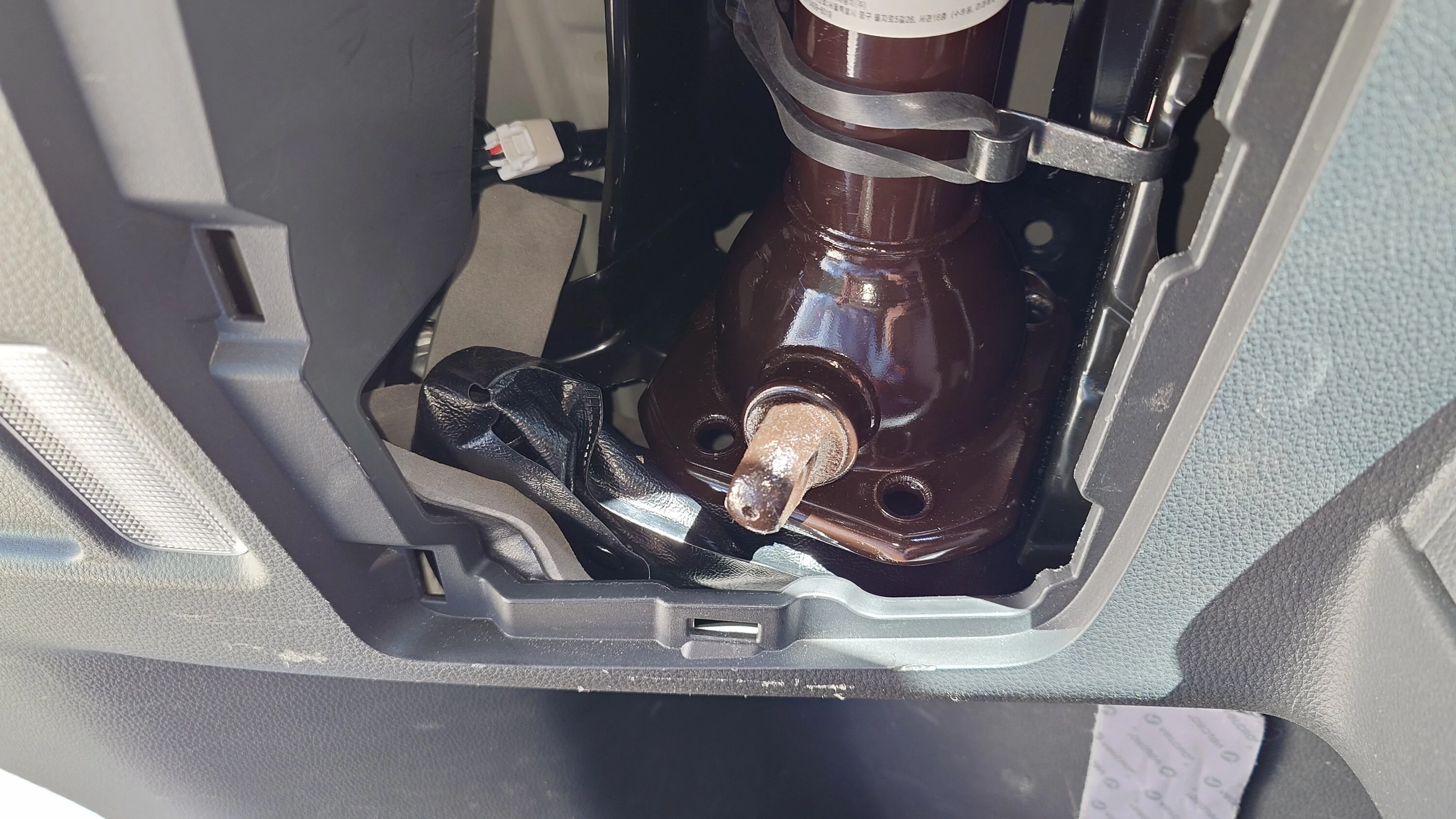

It's possible to stow the jack tools kit under the jack, freeing the jack tools cubby for your own use, which I use for a trailer hitch.
There is a cavern of space between the interior panel and the body.
So much actually the tire iron bag can fall all the way down if you let it.
You have to protect the body from the jack tools from the inside of course, but even so, the bottom area where the bottom end of the kit lands is actually behind the plastic bumper cover, not directly visible from the outside.

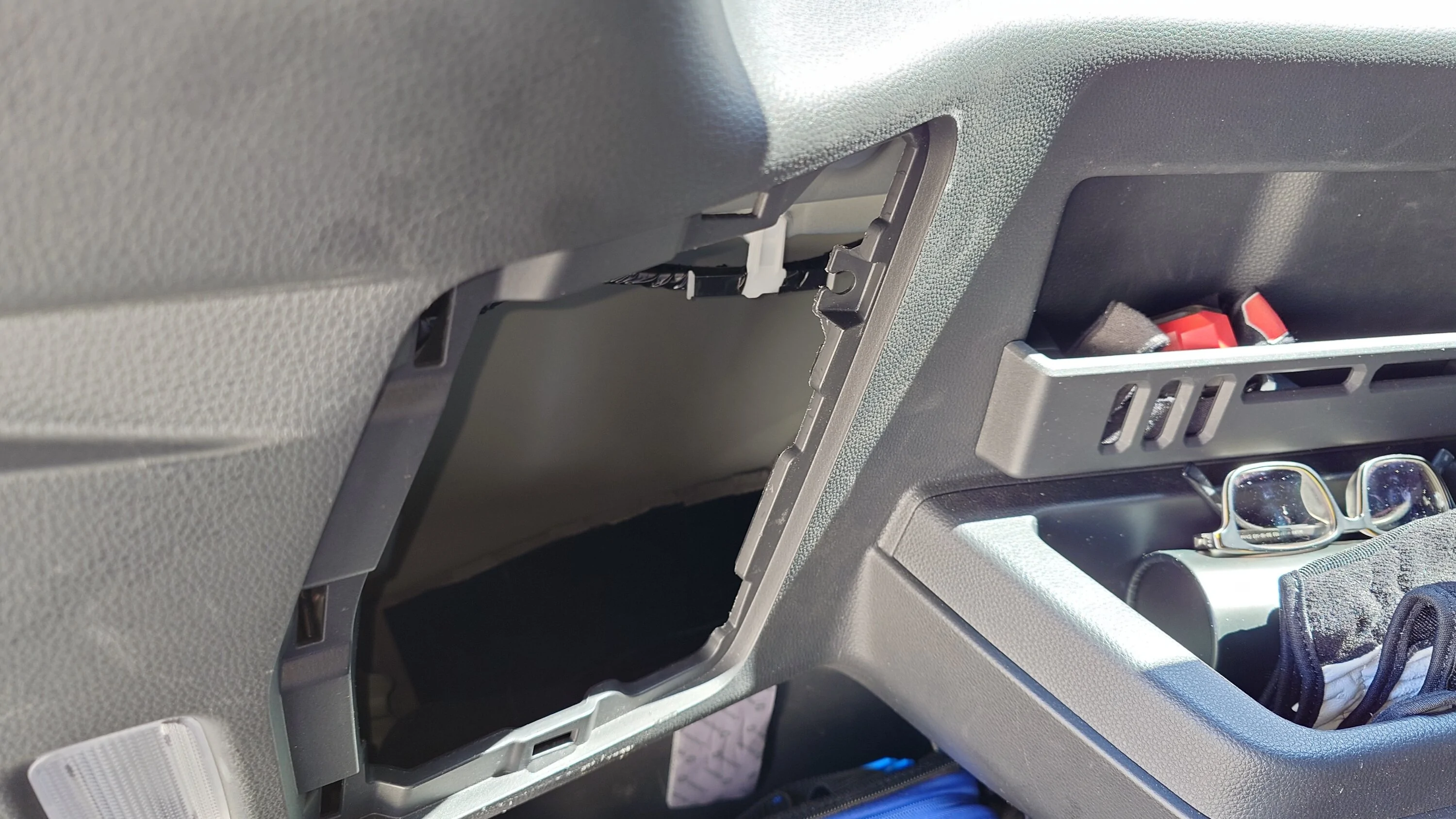

To get the foam in I was able to remove and reinstall the jack bracket without taking any part of the interior apart.
You get the 4 bolts out (Be careful not to drop any or you will be going to autozone to by the 59 inch wifi borescope with a maget tip. It's $68 and most locations have it in stock. Ask me how I know.), then lift up on the left side of the bracket to free the two metal hook tabs from their holes (it takes some force), then push the top to the left to slide the upper plastic standoff out, then push the right side down to slide the lower plastic standoff off. Then you can fish the bracket out of the opening.
To reinstall it's the same in reverse initially to get the plastic standoffs in, then just lay the left side in place and don't try to get the hook tabs in their holes yet. place a finger over the lower metal tab on the left so you can feel it and feel the hole it will pop in to. Then lift up on the whole bracket and strain it just enough until the bottom tab clears it's edge and pops in. The upper metal tab is easy after that. Finally reinstall the bolts.
While the bracket is out stuff any kind of large foam down all around where the bottom end of the toll kit lands. Especially you need to put some bulk to the right (toward the front of the truck) to prevent the tool kit from sliding forward (which would then allow the top to fall down). I used a few pieces of floor cushion like used in gyms around weights etc. Home depot or lowes sells them for putting in your garage or play room etc. And a few small pieces up around where the top of the tire iron rests just under and to the left of the jack.
With the jack out of the bracket, the gap in front of the bracket is big enough to fish the tire iron kit in. Then put the jack back in the bracket.

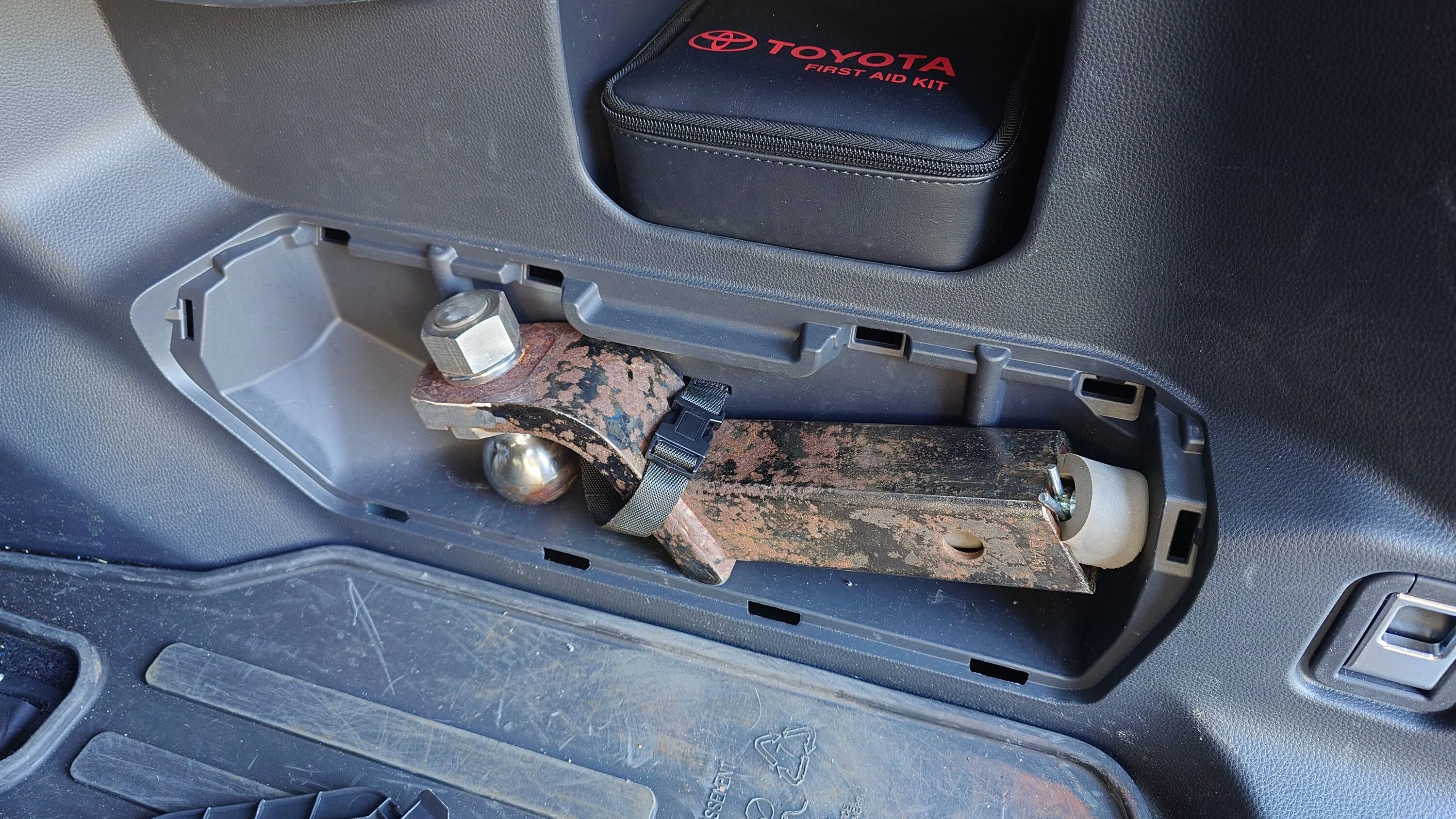

Then I was able to fit a trailer hitch in the jack tools cubby and still close the cover. It did fit with some slight flexing of the cover without modifying the hitch, but I did also decide to grind away a few high points to fit better, and doesn't affect anything about it's strength.
I had to ditch the anti-rattle bolt I had on there though.
I have a Quietite on order too.
https://www.amazon.com/dp/B07CQ6HWCC
That looks like it should fit just as well, and has it's own built-in anti-rattle. I did not want a quietite if I was storing the hitch on the exterior, like strapped under the receiver or strapped inside the spare the way I had before this, because the wedge draw screw would immediately rust and seize up in NJ. But stored inside the vehicle it's no problem.

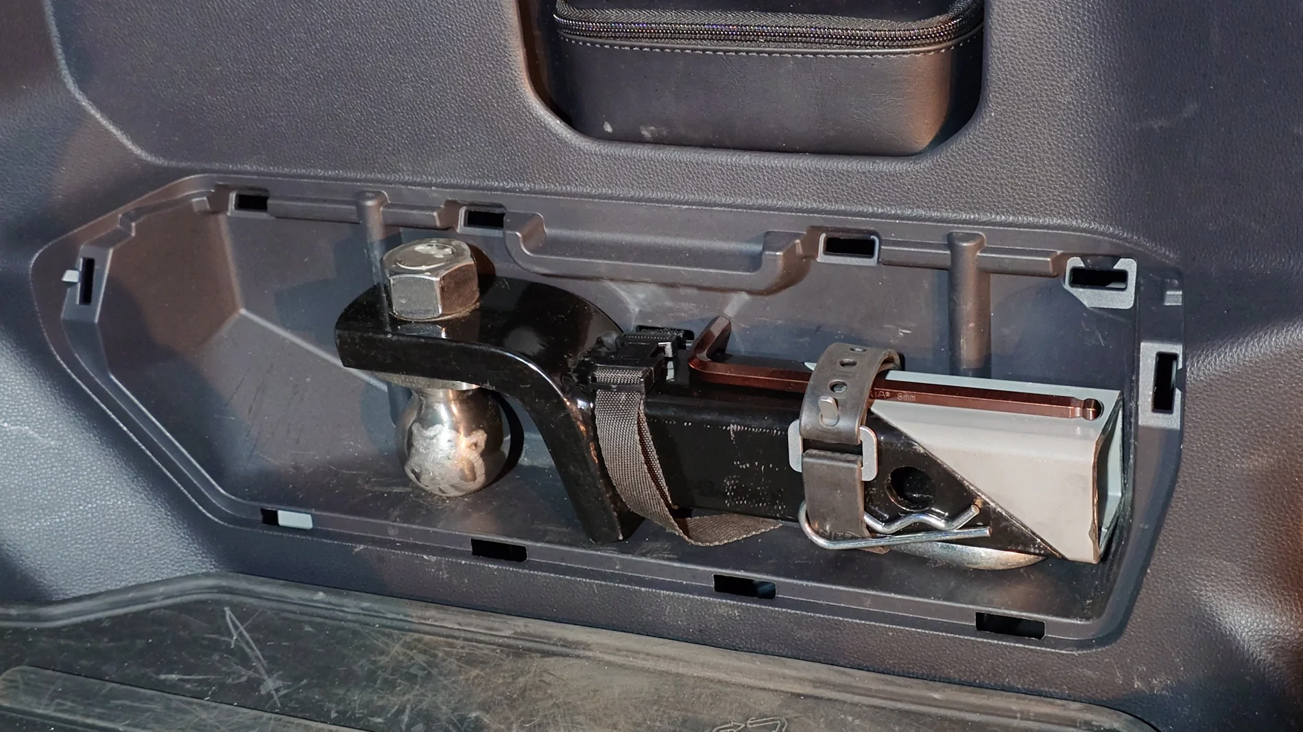

Quietite does not fit :/
At least not well enough to close the cover. I guess if you don't care about the cover then it fits in the spot well enough. Or if you don't mind carving up one of the vertical ribs on the wall it might be made to fit.
Apparently only just the right hitch will fit all the way inside the cover and I just got lucky with my old one.
It needs to have a 3" drop, and the total length needs to be 13 inches.
Also along the way I noticed that my old hitch is only rated to 5000 not 6000.
It's a shame. That quietite is pretty cool. I want some kind of anti-rattle, and it would be slick having it built in like that instead of haveing the big u-bolt & plate thing.

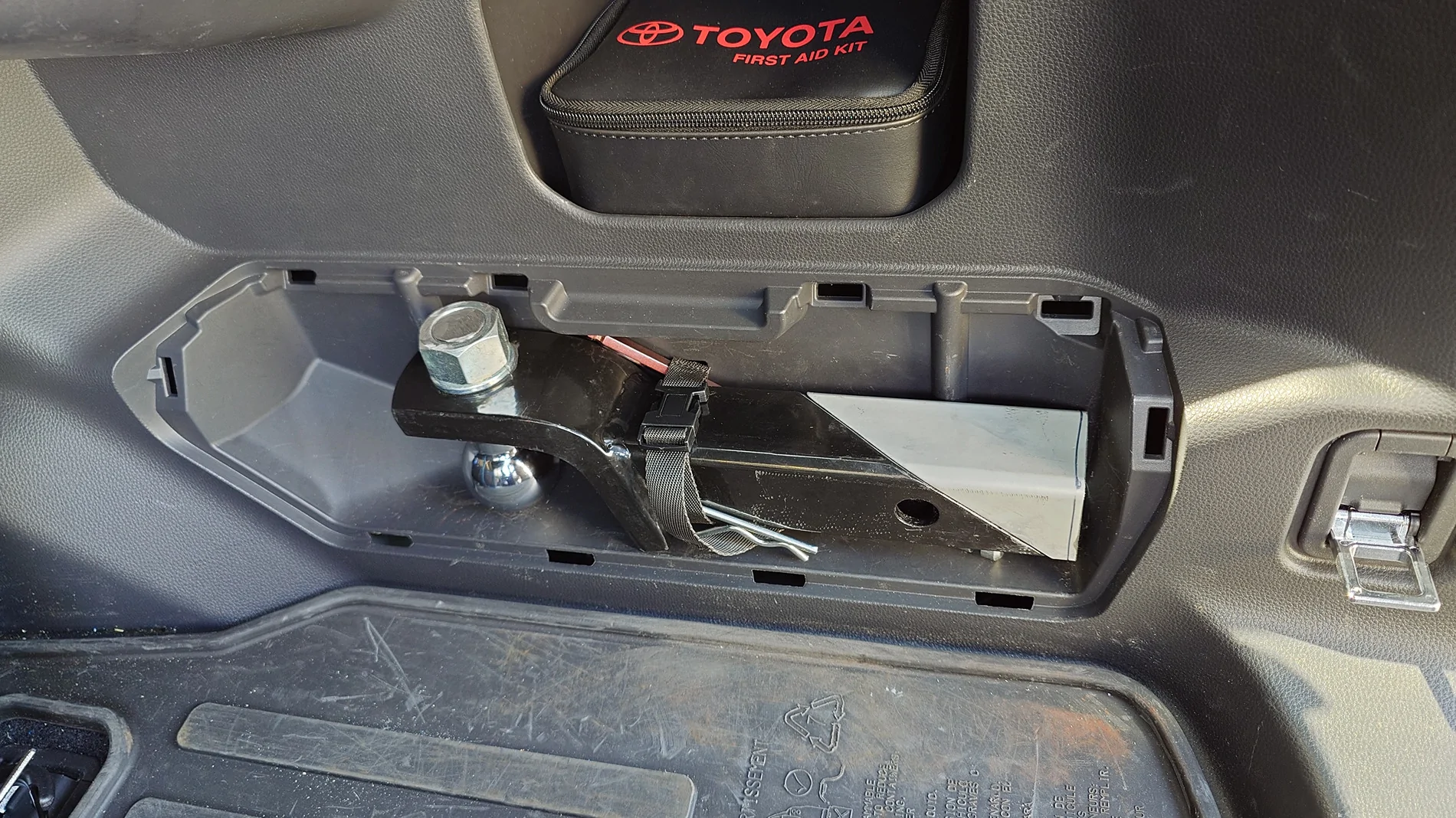

Actually the quitite might be hackable into fitting. It should be ok to cut off about 1/2 - 3/4 inch off the end without affecting it's strength, and that might be enought for it to drop into the cavity next to the rib. That same part of the thing actually sticks out the back of the receiver anyway when it's installed.
And cutting down the exposed threads on the ball might be enough for that part.
It's only a few minutes with an cutoff wheel in a grinder, but it means modifying the thing which is not something you can ever officially suggest.
bkw777
Brian
Jul 31, 2025
247
141
NJ
25 SR5, 96 SR5
Quietite
2 inch drop (apparently only comes in that one option)
7500lbs
I used a grinder to cut about 1/2 inch off the tail end. That much sticks sout the back of the receiver anyway when installed. And cut off the excess threads on the ball.
Even after carving it up it only mostly fits inside the cover. One of the clips is obstructed by the nut so you can't install the cover.
So it works but only if you're ok with leaving the cover off. And if you're willing to do that then there is no need to bother grinding it down.

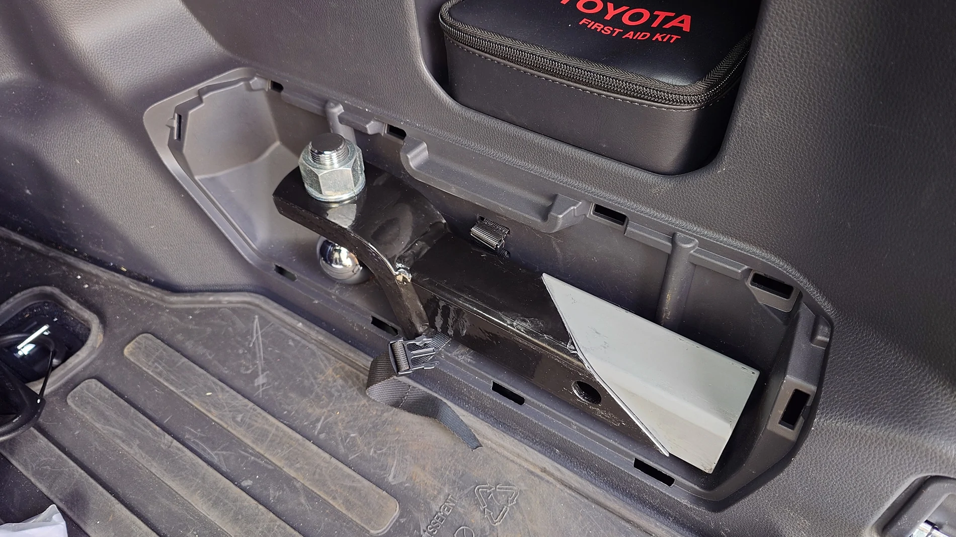

This one is nice and tidy, and rated for the full 6000lbs that the truck is.
(my old one in the original pics is only rated for 5000)
Walmart Hyper Tough LY-2012
The ball is welded so no nut to get in the way of the cover. The cover is clear all the way around.
No anti-rattle though.
It's supposed to be a kit that comes with a locking pin, but the pin was missing. It had no price marked but on-line it shows as $31. I asked for a discount since it was missing the lock & pin, and apparently the store had already marked it down to $10 but the guy didn't know that $10 wasn't the normal price and applied some standard discount, and I paid $7.
ah... It looks like it's probably discontinued, that explains it. The web site says "not available"
https://www.walmart.com/ip/HyperTou...ch-Drop-and-2-inch-Hitch-Ball-Steel/808163339
This looks the same but holy cow $75
https://www.amazon.com/Trailer-Welded-TOPDKY-Receiver-Square-Head/dp/B0BHW76XBK
Maybe there are other sources of the same thing like aliexpress or something.
Curt makes some welded ball hitches too.

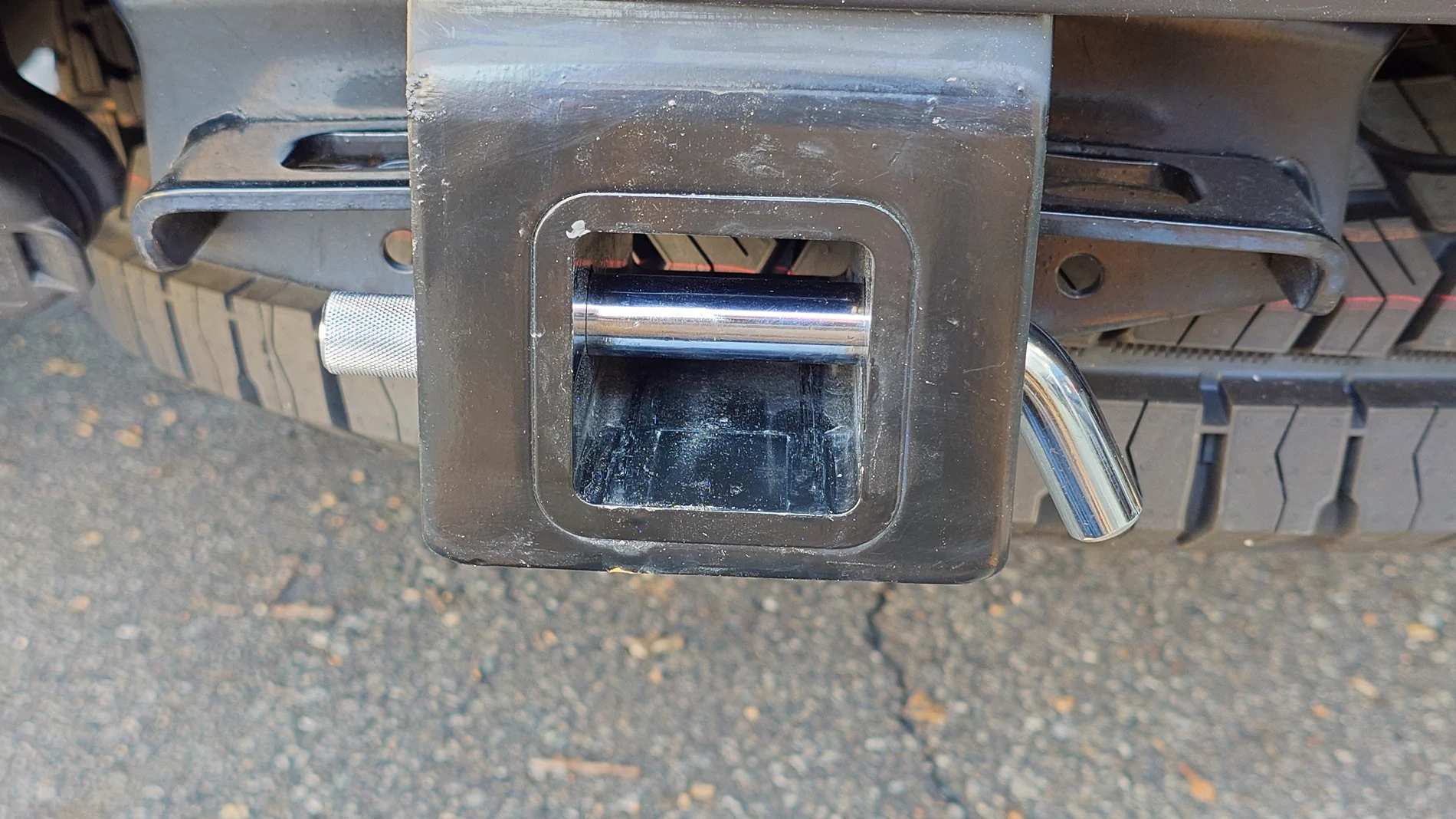

One last detail still in shipping, a pin that doesn't have a seperate loose retainer clip, or any other loose parts like lock keys.
This is hard to find because we have a stupid unnecessary non-standard wide receiver.
This nice stainless one that I *wanted* to use, does not fit:
amazon.com/dp/B000COX0MY
We need just over 3-1/2 inches of usable length. Pins made for 3 inch hitches should work but most of those are just standard pins with removable retainer clips. But this one looks like it should work:
amazon.com/dp/B0DT5PQ9DG
The item description & pics are useless but there is a review that includes a pic with a ruler showing 3-3/4 to possibly 4 inches usable.

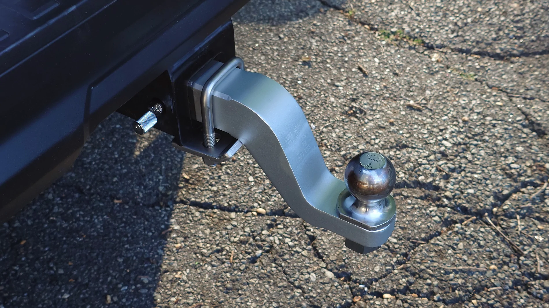

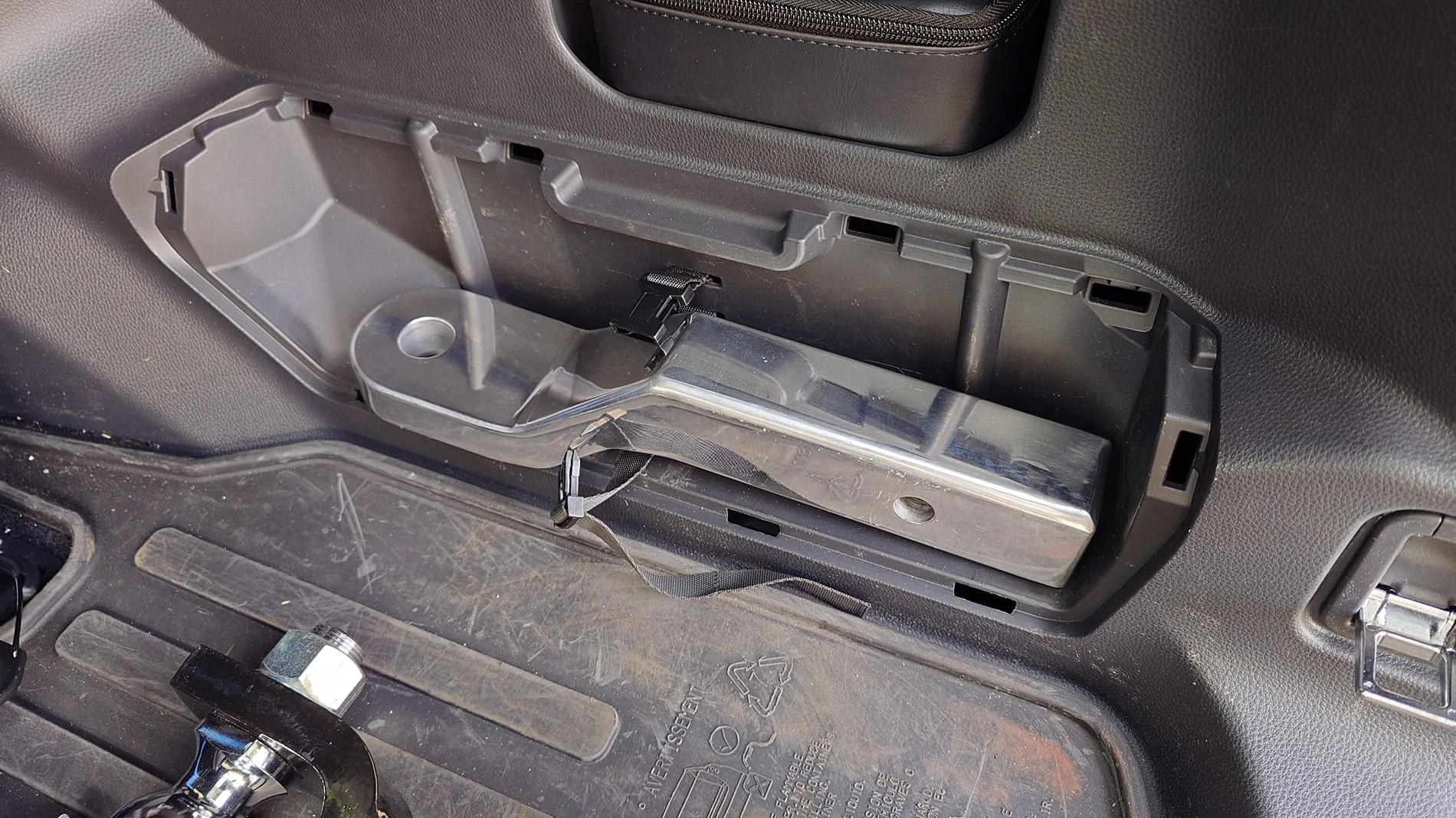

The pin arrived and it fits perfectly.
Also managed to fit a 4 inch drop in there and still close the cover. It's a Curt 45361 aluminum one that has the unique property that it's the same 2 inch width the whole way, so it can just lay right over the ribs and you're free to position it wherever needed to clear all the various obstacles. It's resting on top of the pin here intentionally so it angles up, which is needed for the ball nut to clear. The hitch is good for 8k and the ball 6k. Same as before the ball nut only fits without the lock washer.
