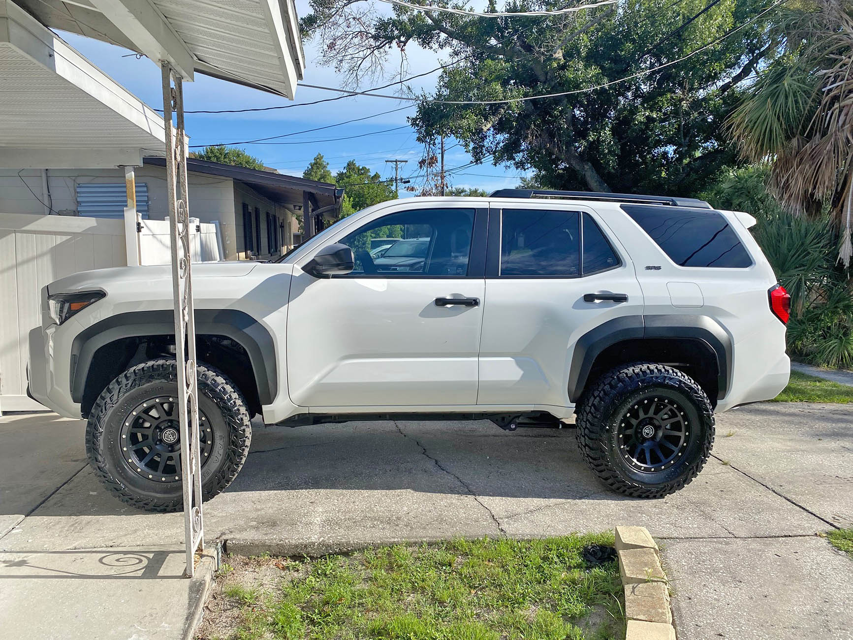

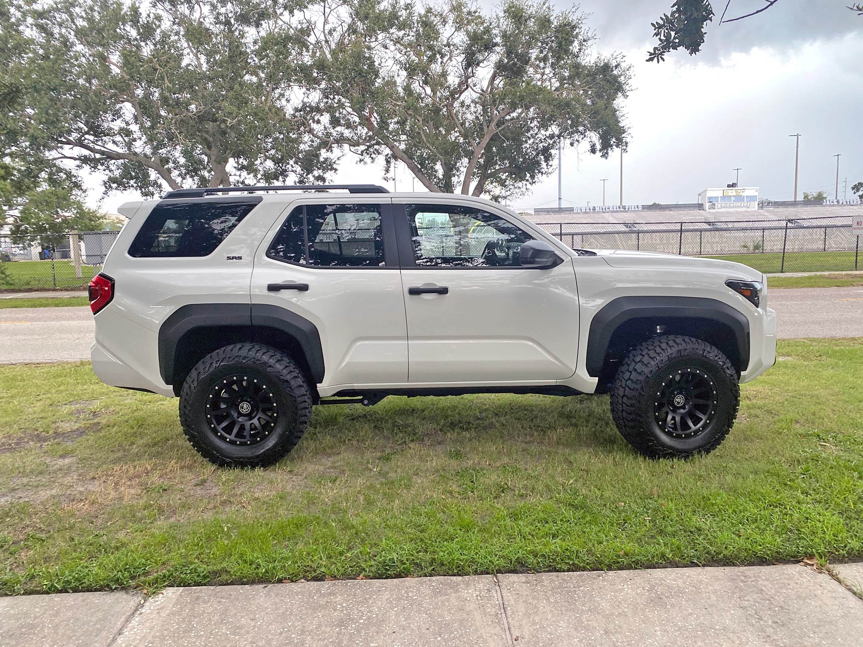

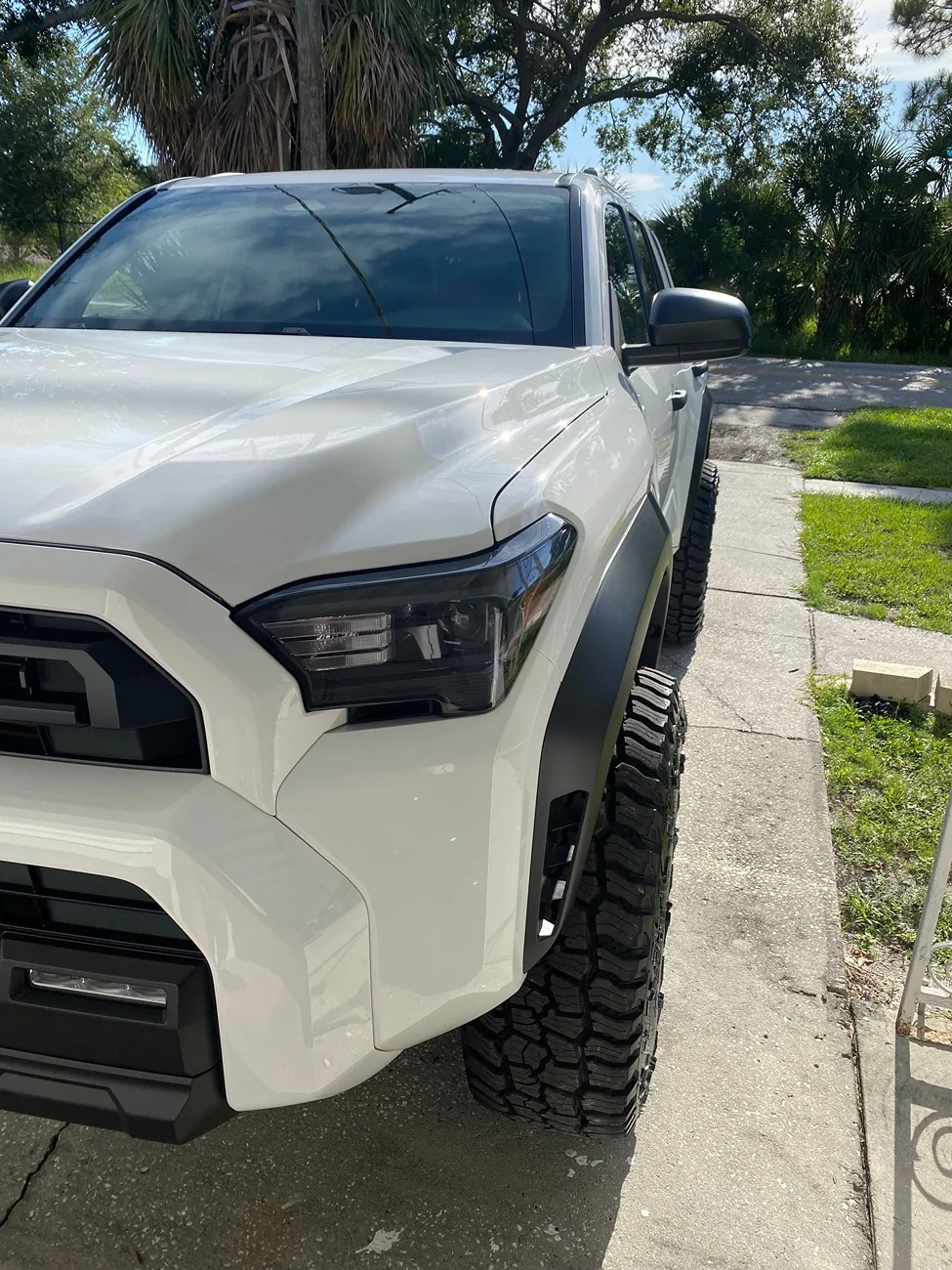

Hey everyone,
Has anyone fit 35x12.5R17 or 315/70R17 on with 0mm offset wheels? I’m currently running 295/70R17 Baja Boss on Icon Compression wheels (0mm offset) and Readylift 2.5" lift.
I already took off the crash plates and pushed the fender liner forward, just don’t want to trim any bumper.
2025 2026 4runner 6th gen 35’s with 0mm Offset Wheels (bumper trimming?) IMG_8639
2025 2026 4runner 6th gen 35’s with 0mm Offset Wheels (bumper trimming?) IMG_8640
2025 2026 4runner 6th gen 35’s with 0mm Offset Wheels (bumper trimming?) IMG_8660

Are you rubbing with the front bumper at full lock?
gadawgs27
Eric
Aug 16, 2025
Tampa
Not rubbing right now, but I had to trim off the plastic clip that was holding the front fender liner.

How much did you end up trimming? any pics? went with 35x11.5 and ill probably have to trim some as well. Pushed the liner up but still have some rub
gadawgs27
Eric
Aug 16, 2025
Tampa

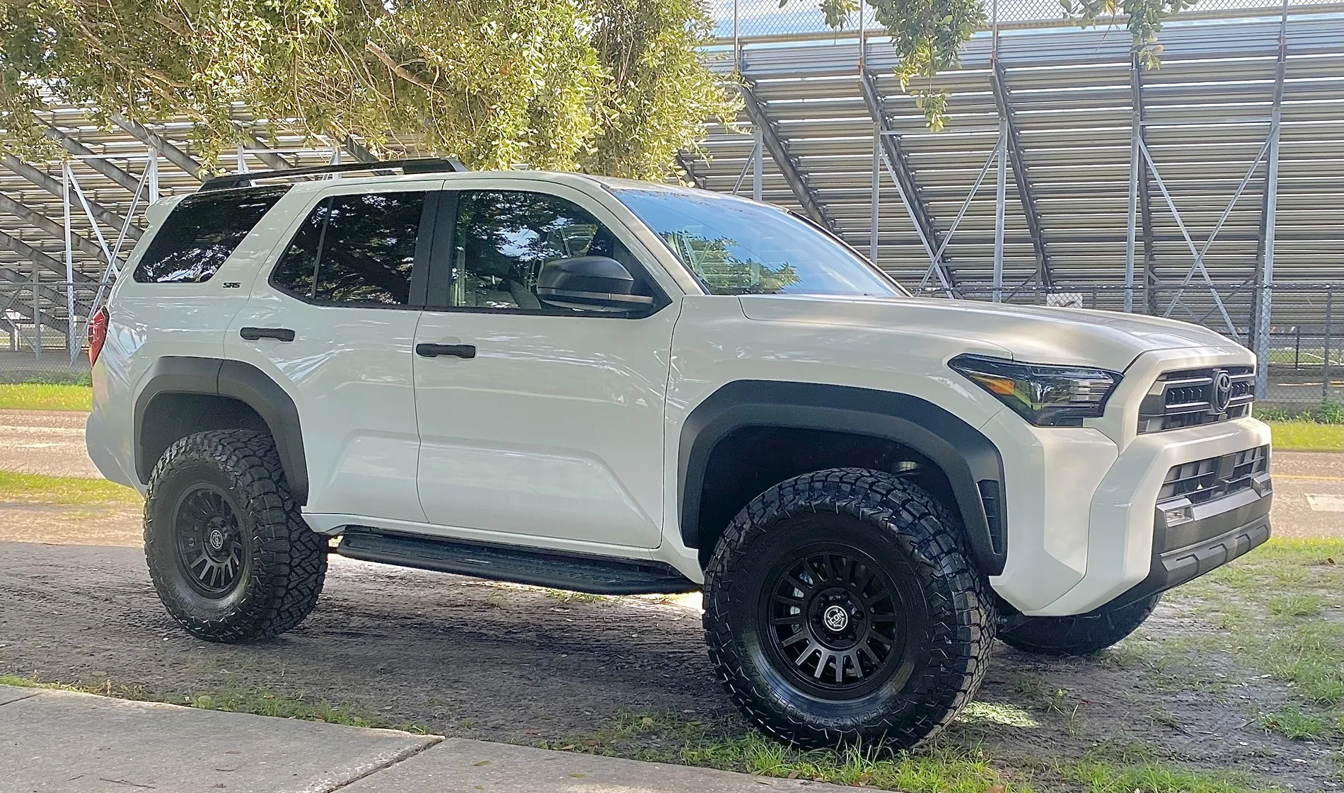

I ended up getting a whole new setup lol. 17x8.5 Icon Recon SLX +25 mm offset with 35x12.5R17 Nitto Recon Grapplers
2025 2026 4runner 6th gen 35’s with 0mm Offset Wheels (bumper trimming?) IMG_8791
