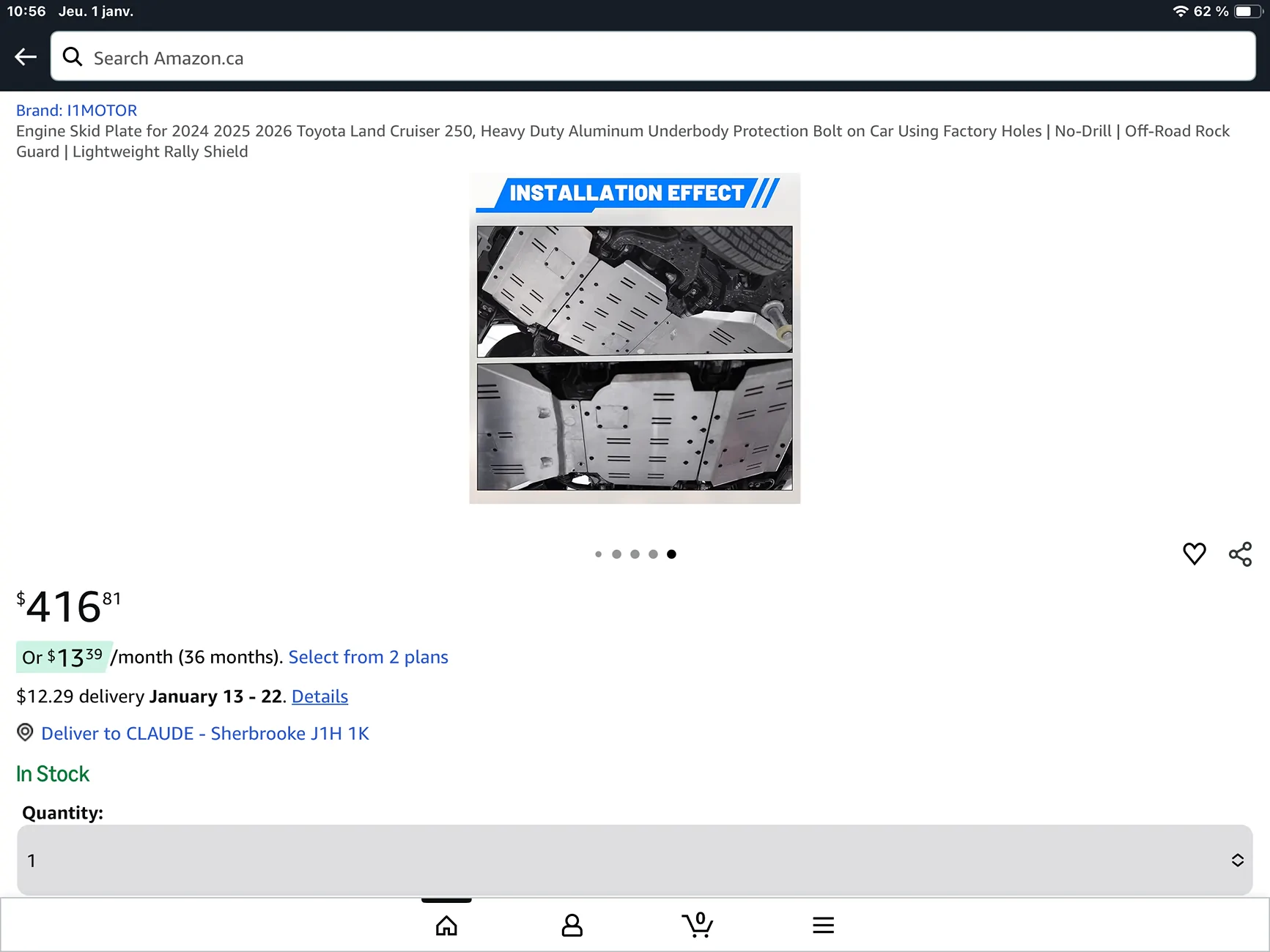

Any thought on these protective plate ? Its met for the LandCruiser so I wonder if they will fit.
