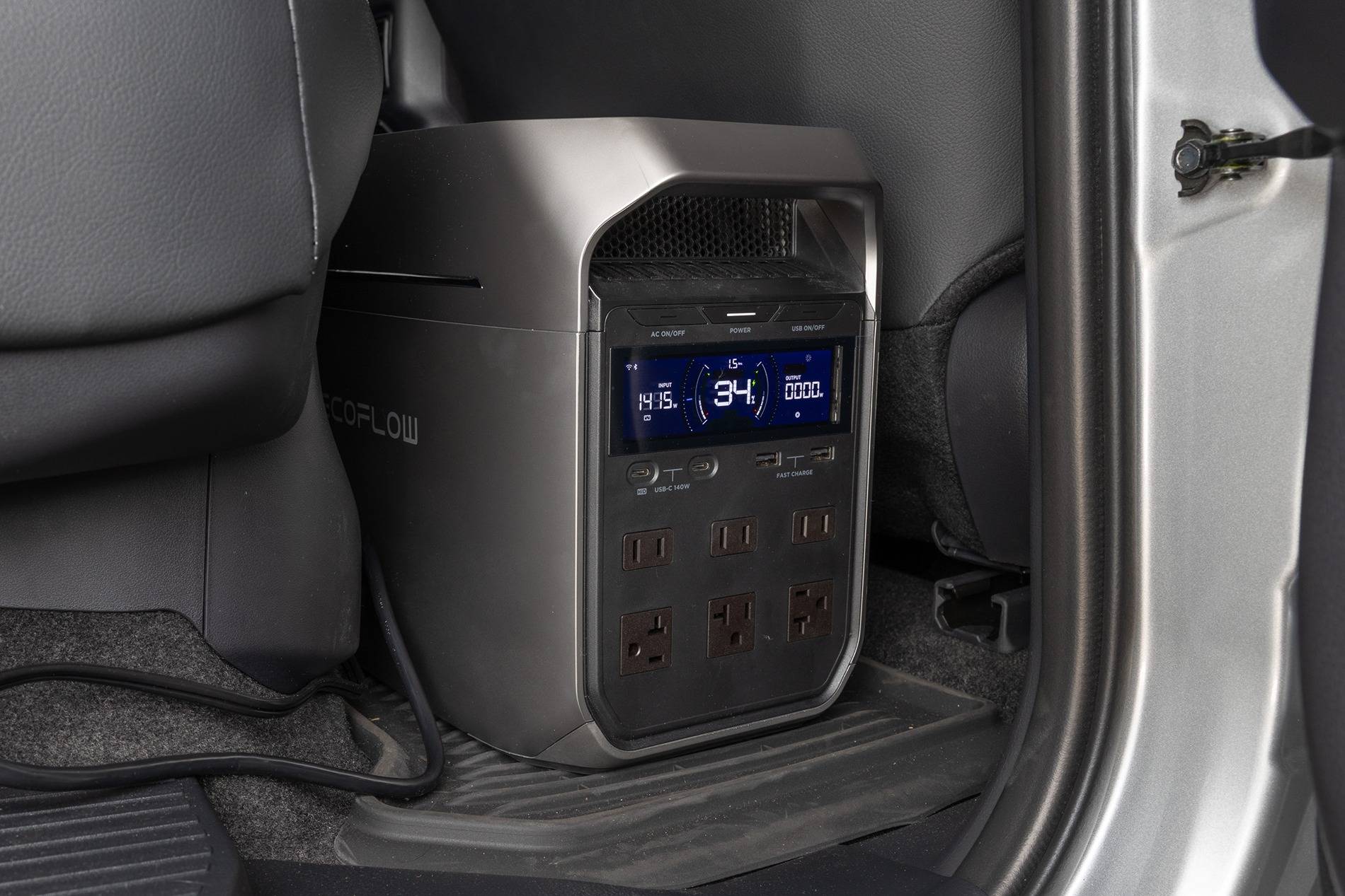

I've been using the 2400W inverter to charge an EcoFlow Delta 3 Plus, and the most it seemed to put out was about 1400W, and it has in incredibly loud fan running the whole time. See my post about that here.

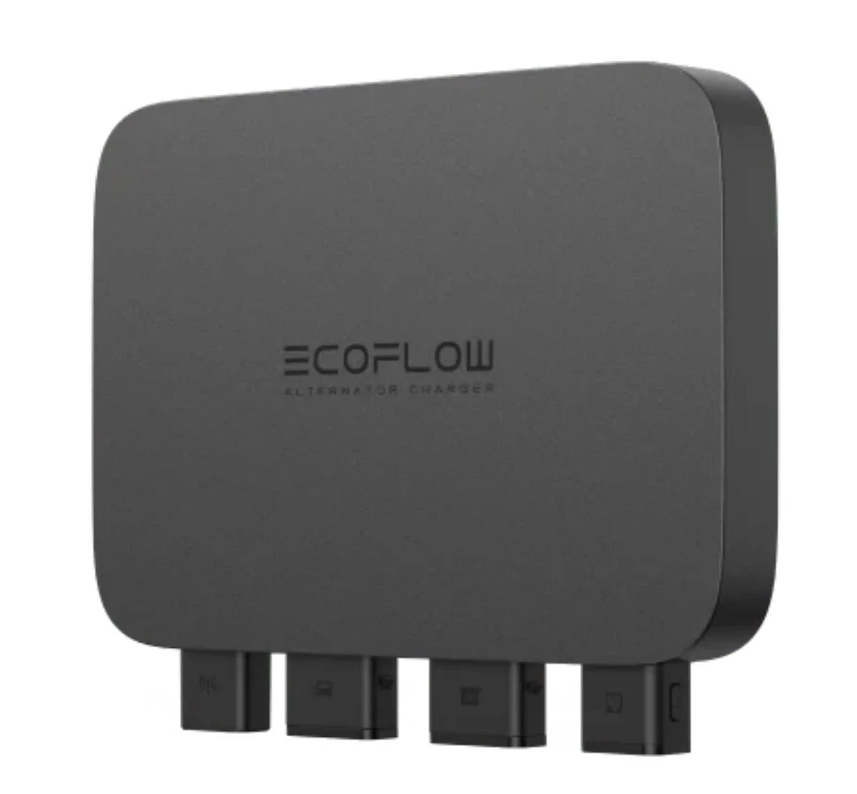

I am planning to install one of these EcoFlow 800w Alternator Inverters and skipping the Toyota 2400W inverter entirely. They are on sale right now, and I ordered one yesterday. I confirmed with EcoFlow that they don't have a fan and make no noise at all.
https://alnk.to/5Q7lnCk
2025 2026 4runner 6th gen 2400 watt inverter in the hybrid not turning on. Screenshot 2025-05-30 at 7.32.46 AM
I'll share my results once I receive the EcoFlow Inverter and get it installed.
