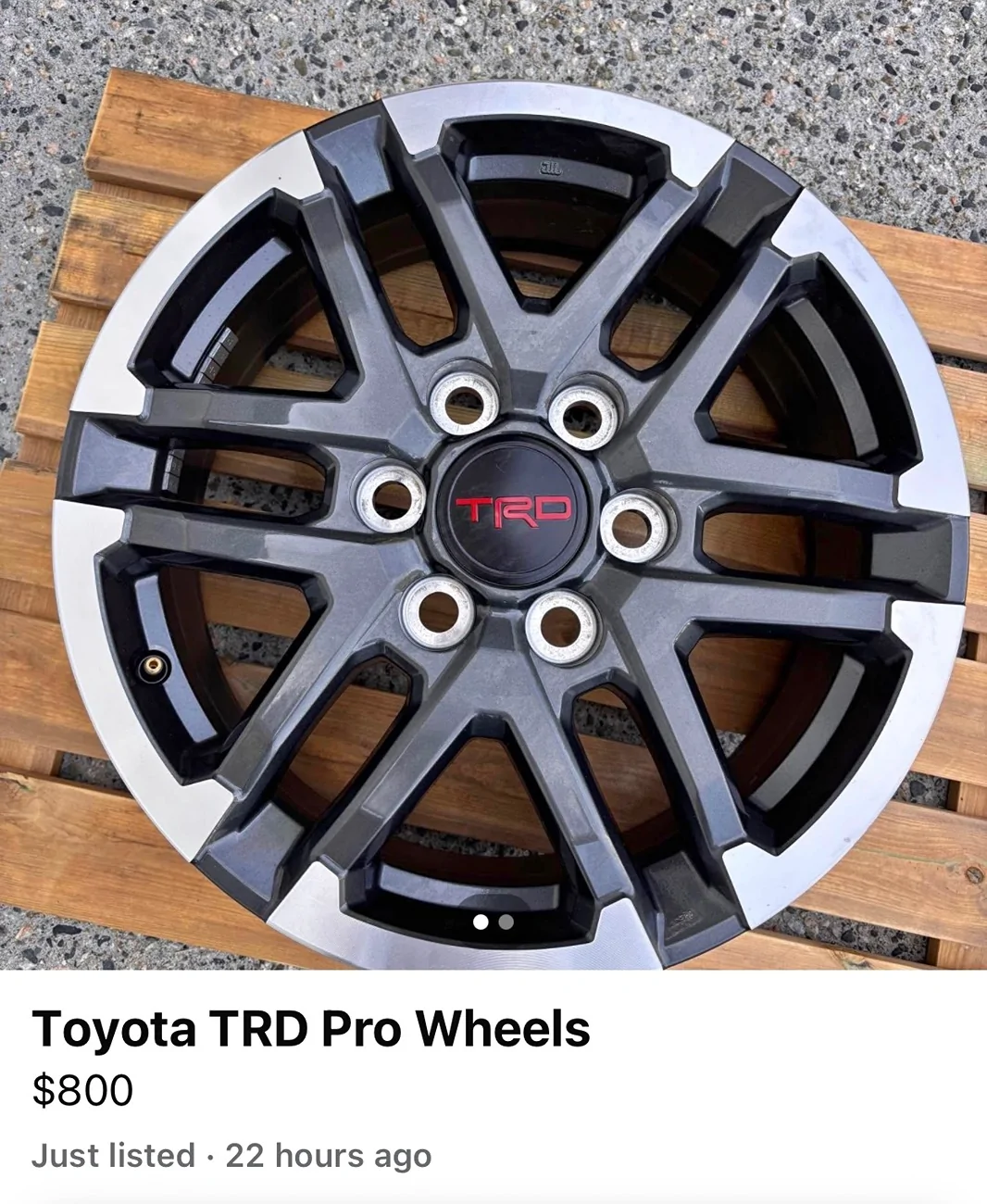

Hi Matt,
Check on Facebook marketplace for rims. I’ve seen some on there, that are 18 inch. This came off a 2025 Tacoma.
2025 4runner 6th gen Winter Tire Size options for 2025 4Runner Limited 1754160352269-e0
