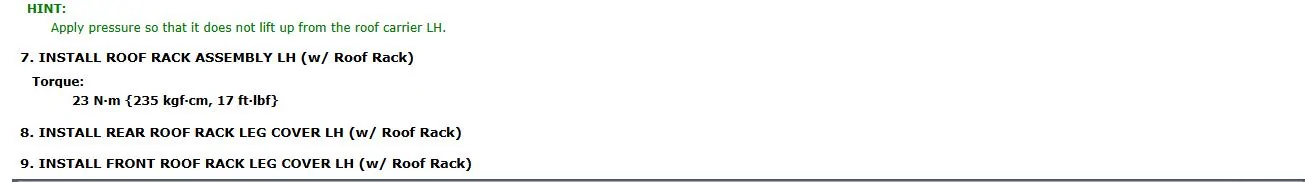

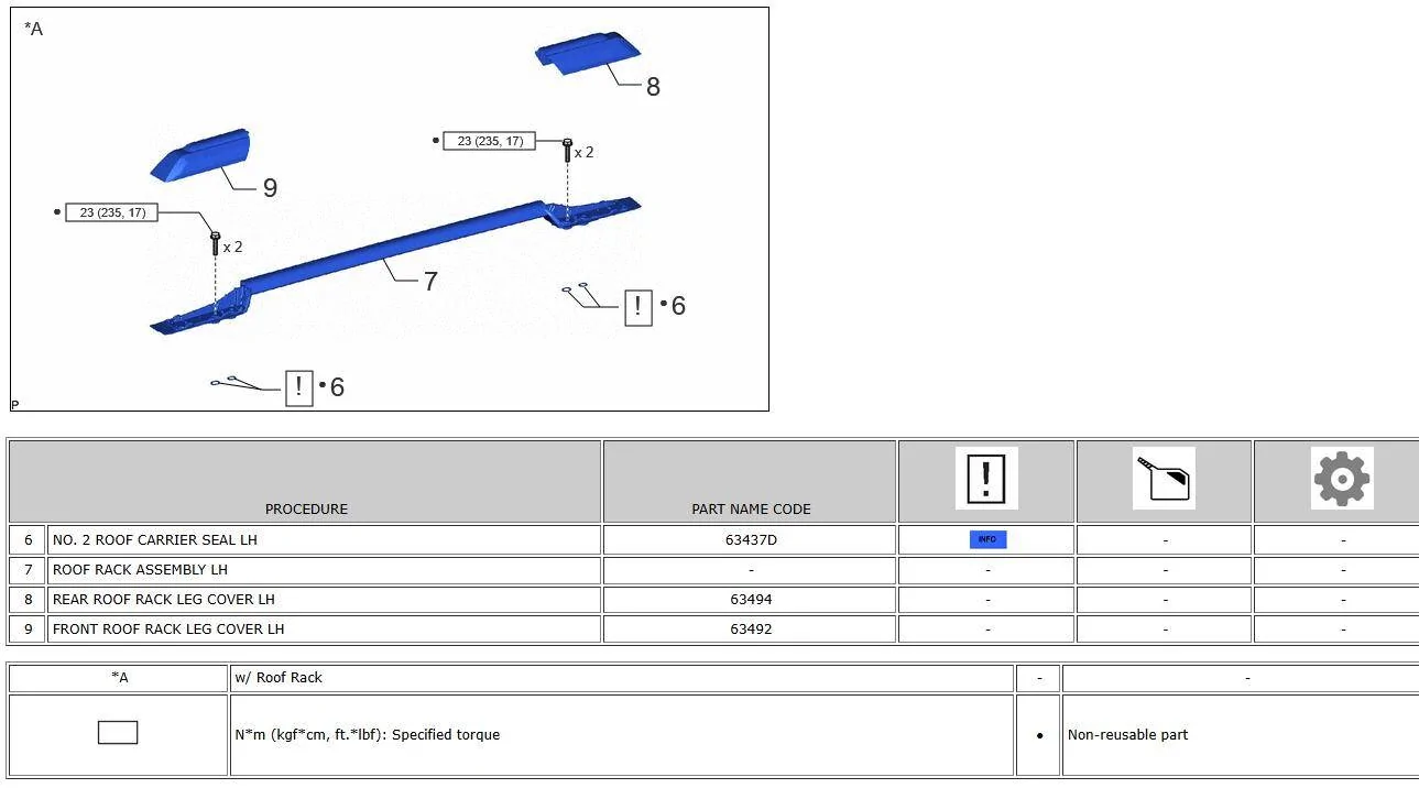

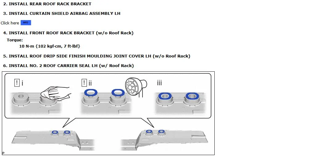

After posting earlier today, I found a parts dept. guy that very kindly went into the Technician's data programs & found installation instructions with torque specs for the roof rails (actually called “roof rack”). It states 7 ft. lbs. for no rack & 17 ft. lbs. with the roof rack/rails.
2025 2026 4runner 6th gen Torque Specs for OE Toyota Roof Rails? Installation Roof Rack-Rails • Page 3 of 3 • 2025 Toyota 4Runner
2025 2026 4runner 6th gen Torque Specs for OE Toyota Roof Rails? Installation Roof Rack-Rails • Page 2 of 3 • 2025 Toyota 4Runner
2025 2026 4runner 6th gen Torque Specs for OE Toyota Roof Rails? Installation Roof Rack-Rails • Page 1 of 3 • 2025 Toyota 4Runner
