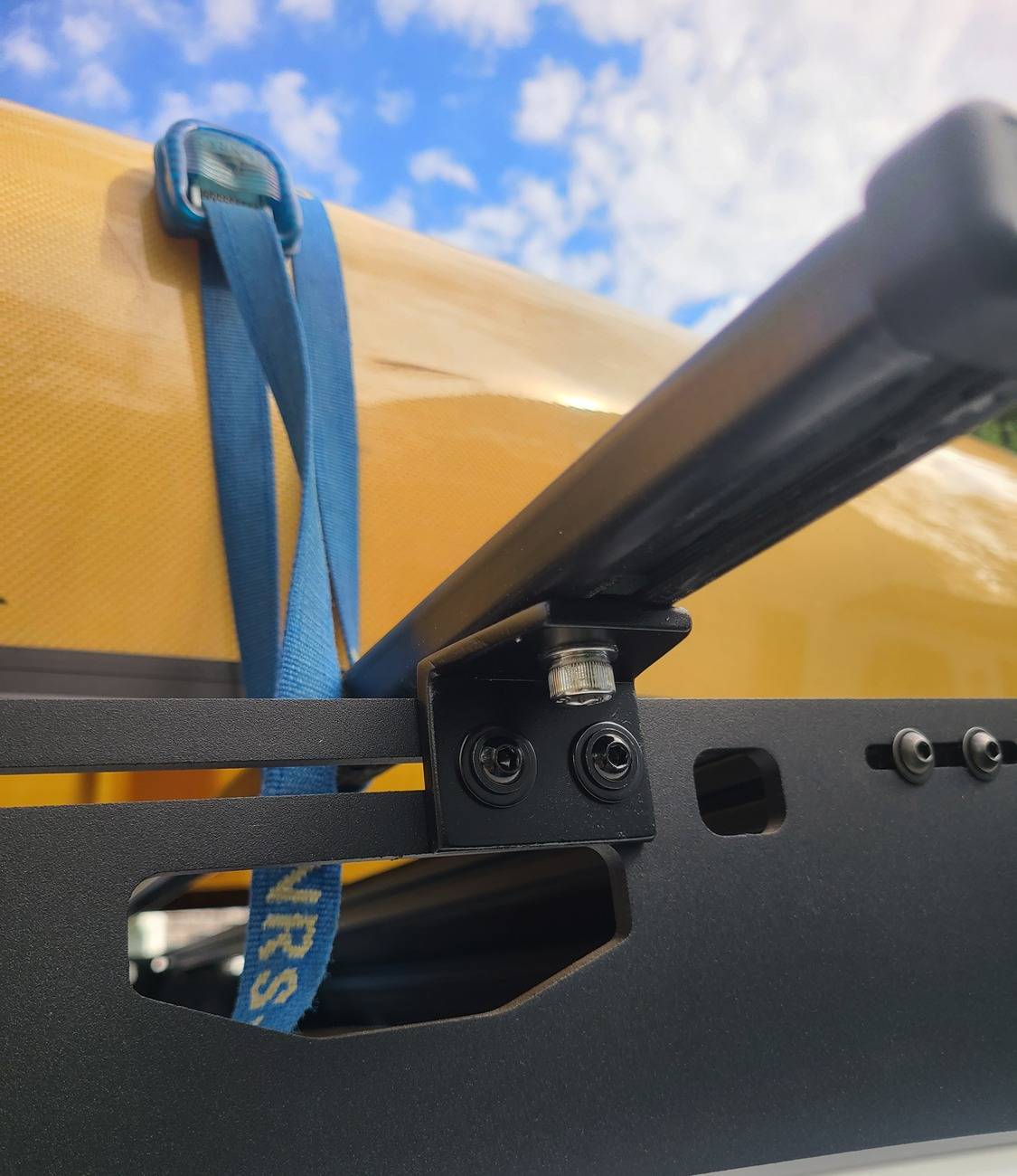

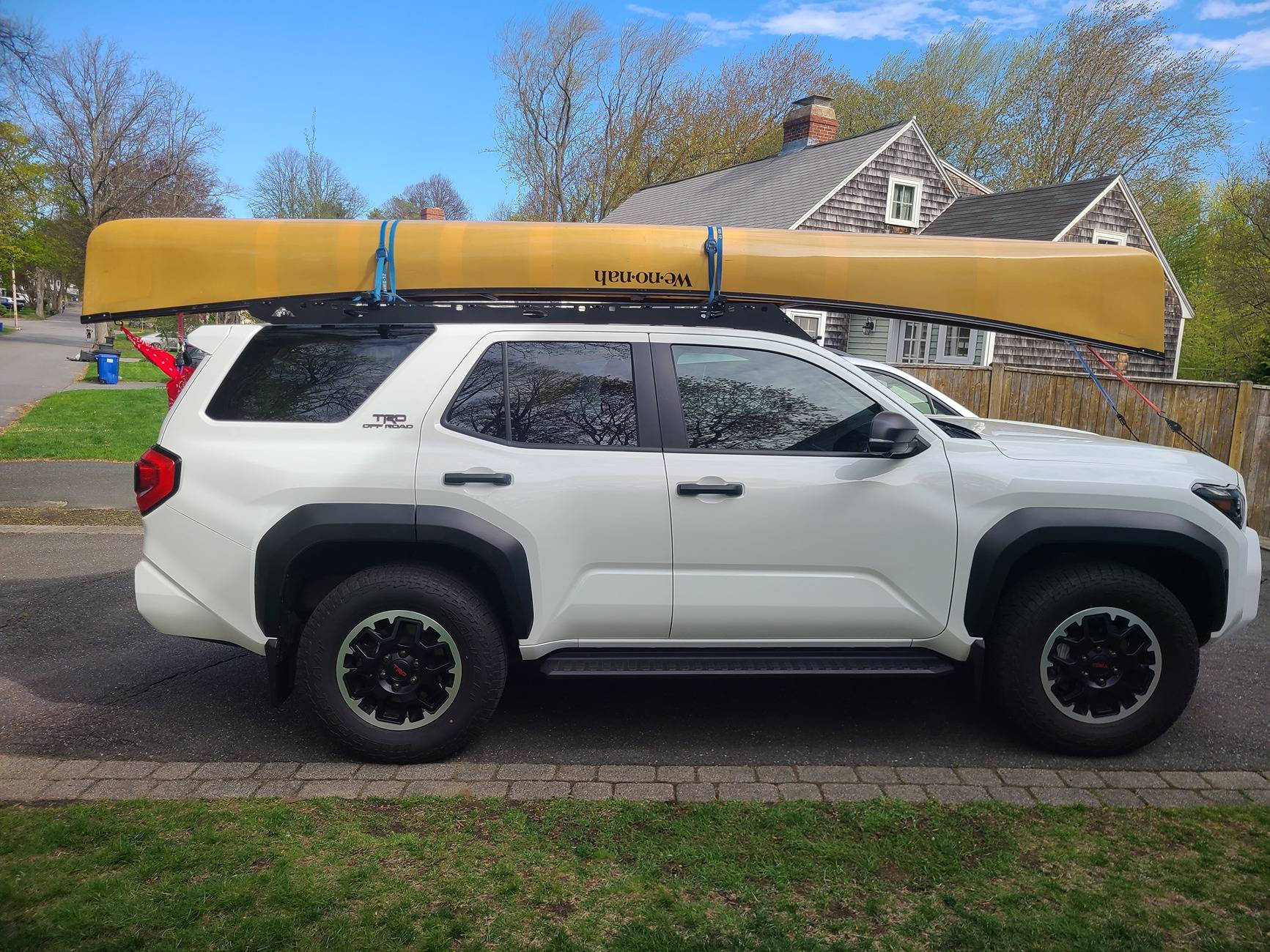

I made these adapters from 1.5-inch aluminum angle stock (0.125-inch thickness). They allow me to bolt Thule load bars on my Sherpa Capital rack. Great for canoe carrying.
