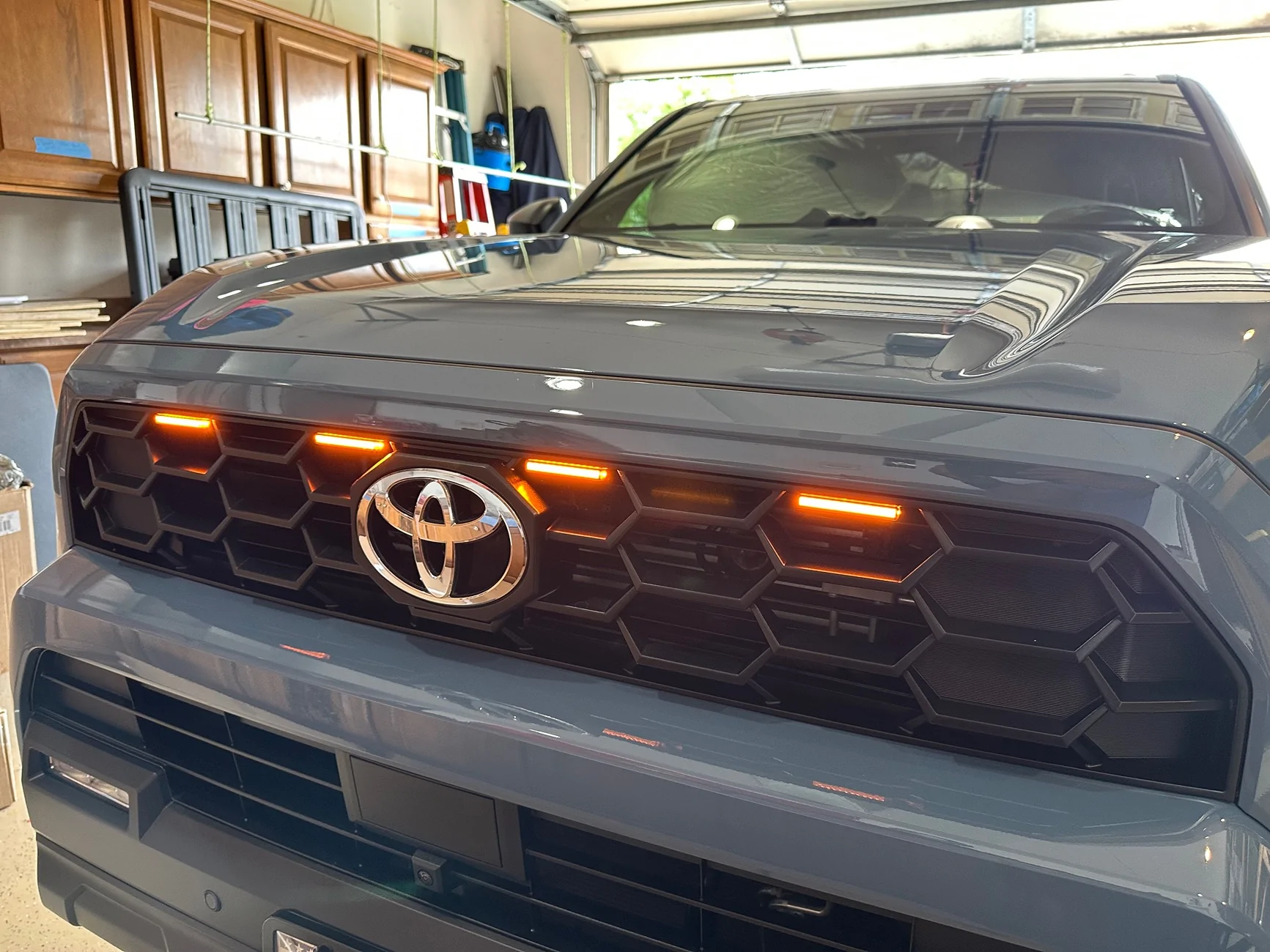

Why did you install them so low?
If you watch the video, it looks like they only clip into the bottom floor. I prefer them up top like yours, but I think yours are the stick on ones.

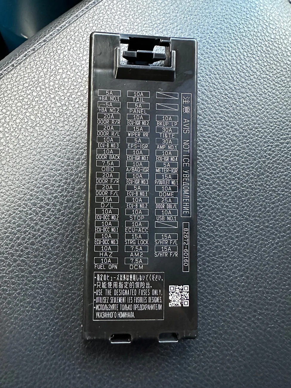

I ran mine inside to the taillight microfuse that way they only turn on when my running lights are on.

Just extend the wire into the cabin through the fire wall, under the steering column and behind the center counsel. Add an ATM fuse tap inline, find the “tail” fuse and plug it in. There should be some videos on YouTube.
