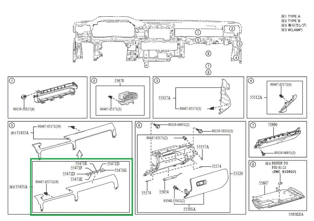

Hey folks, does anyone know the part number for the toyota script emblem that goes on the TRD PRO dash?

See the attached register assembly, I've highlighted the part numbers with a green box.
How would I got about searching for this? Sorry for the questions. I just searched the part numbers on the Toyota parts website and got nothing.

I researched this yesterday and found that the emblem itself isn't available, you have to buy the entire trim panel to the tune of several hundred dollars.

Old thread but I believe these are the part numbers for the TRD Pro dash trim with the Toyota emblem:
55435-35040-C0 (right side)
55436-35050-C0 (left side)
