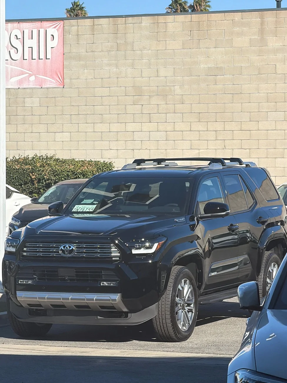

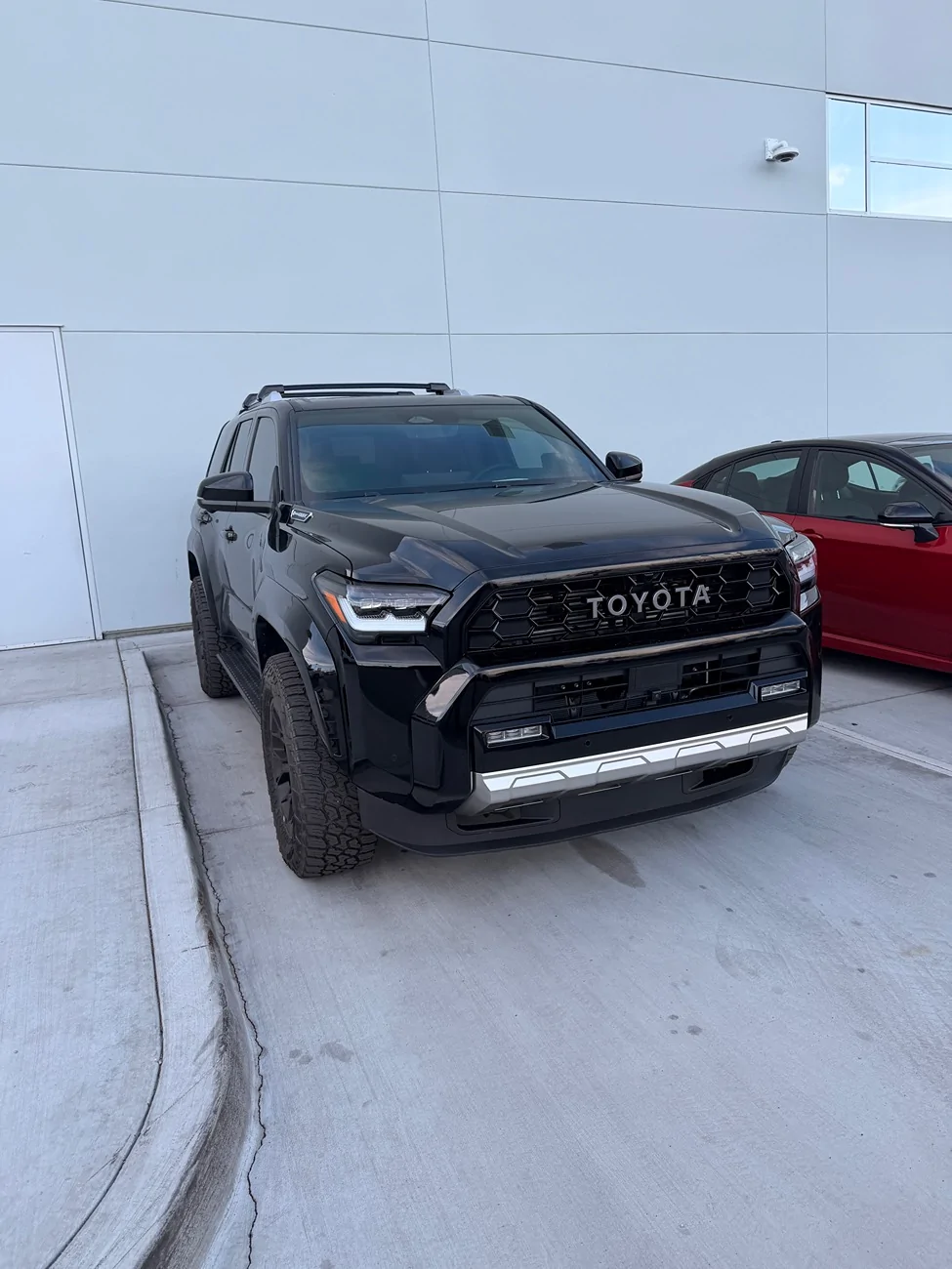

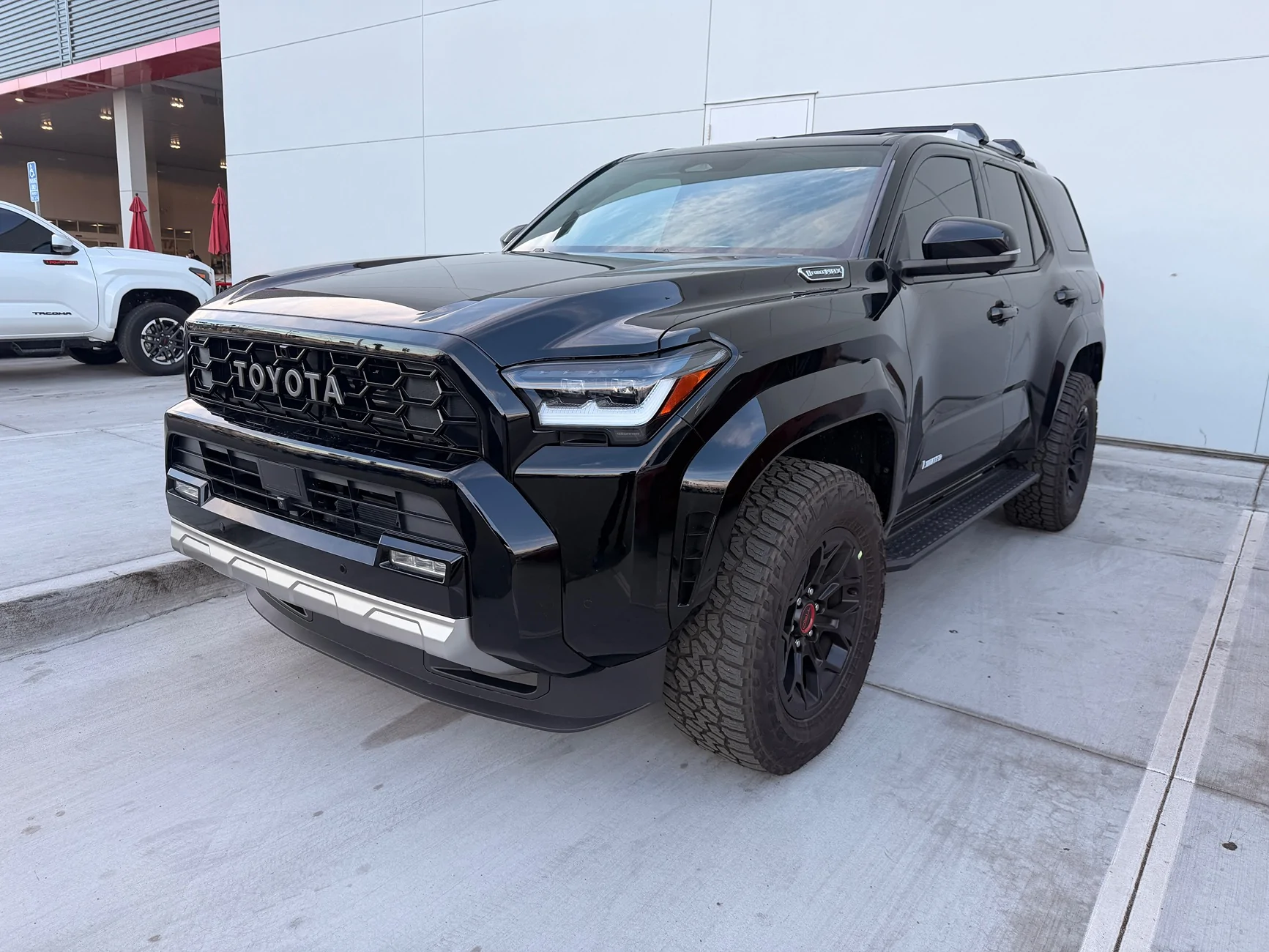

Limited here. Swapped for trd pro 18”s w falken wildpeak at3. Dropped psi to 34. Better ride
Swapped to heritage grill (toyota dealership did it)
Ceramic tint
Coming soon : predator side steps and arb roof rack
Yes. Going for the pro look while still having comfort and ride of the limited. Gonna wait on suspension or lift due to avs as well

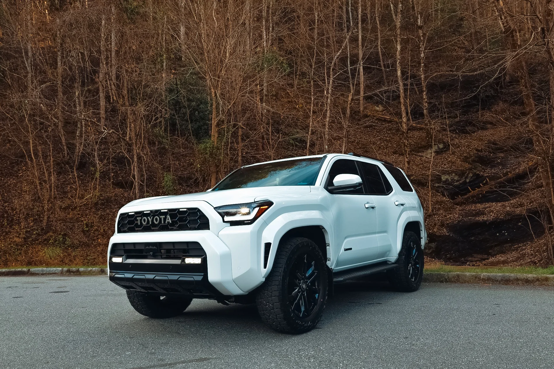

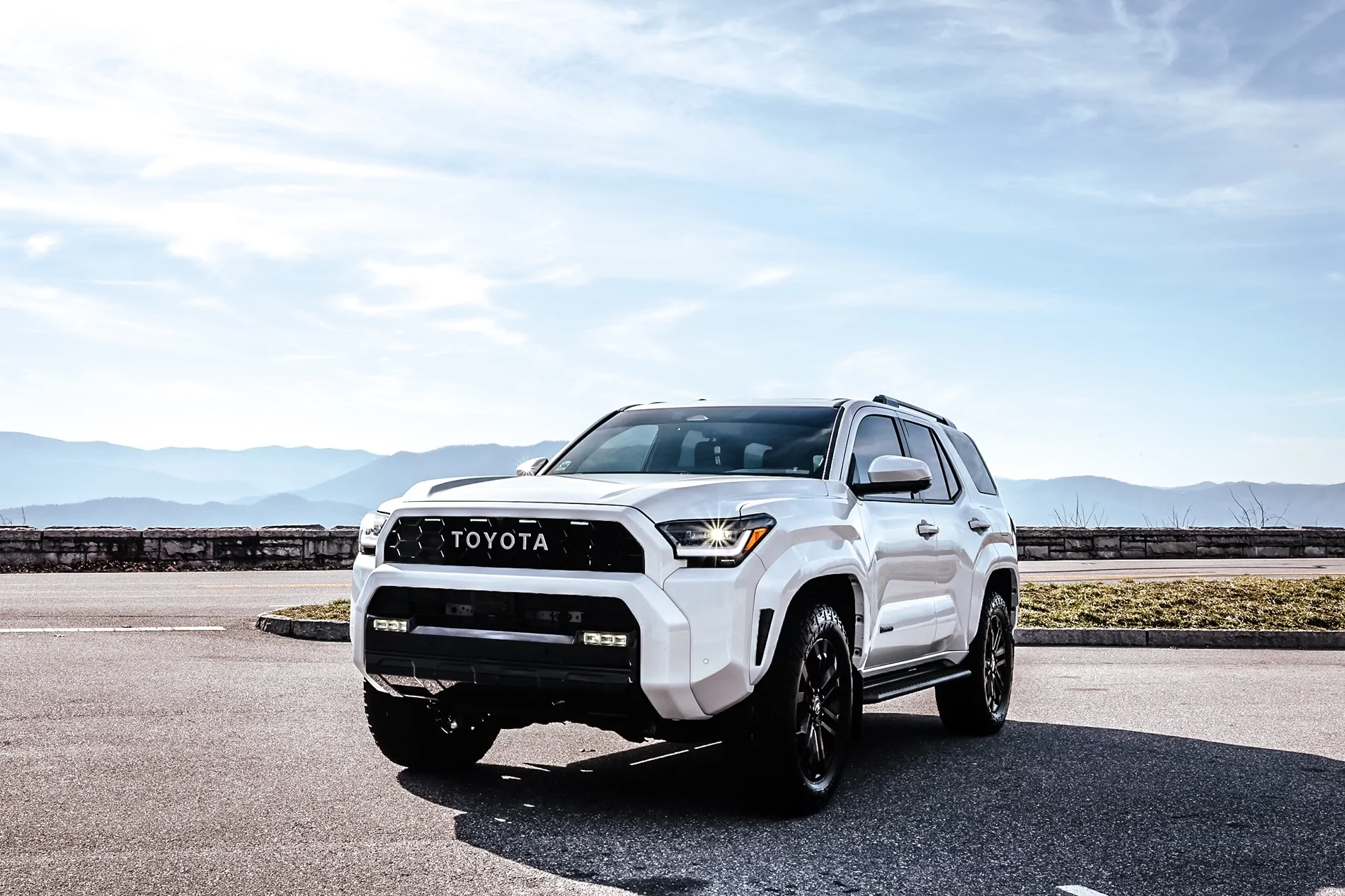

I do! I never posted an update, but here’s everything I did and parts and some pics of what it looks like now;
Heritage grill Part Number: 53101-35170
Platinum Front Valance Gloss Black - OEM part 53911-35510
Platinum cover rear number lower - OEM part 52169-35100
Glossy Black Badge Tailgate Insert - OEM part PT948-89253-12
Bronze overlays - PT948-89250-15 (painted black 2000 grit sandpaper, krylon fusion satin black 4 coats krylon fusion gloss 2 coats)
Pro tail lights OEM part number 81551-35420 and 81561-35420
OTT tune
TRD pro roof rails
LASFIT floor mats
275/60 r20 115t Fallen wikdpeak at4w
raptor lights https://a.co/d/d4xuWlm
powder coated the stock rims
Beatsonic 2nt
Heritage grill Badge Overlay White Part Number: PT948-89250-15

This looks AMAZING, thank you! I’m thinking about plasti-dipping some of the parts until Toyota runs another the sale. A little nervous about the matte not looking nearly as good as thing. My top grille is the matte one too. Not sure what to do haha

Looks great!
Did you have to do anything to the suspension to fit those tires ?thank you

Did you have to mod the suspension to fit those 275/60/20s thanks
