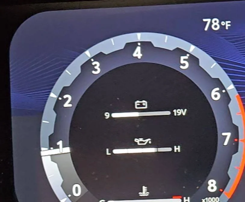

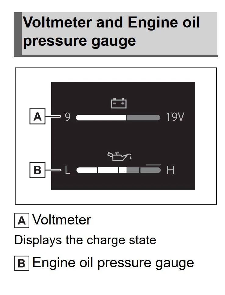

Referring to this meter display in the 12.3” screen:
Mine (non-hybrid ORP) has been consistently staying below the midpoint of the display:

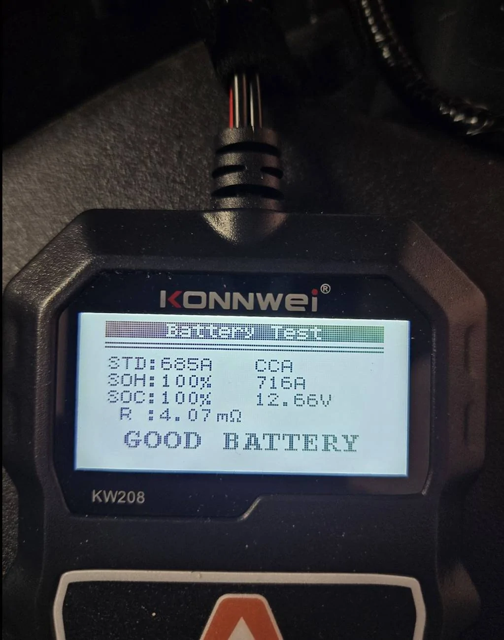

I’m not a fan of the non-numeric dash displays and I wondered if I had a battery or charging issue since I’d think they’d design the display of something as generally stable as battery voltage to be smack-dab in the middle when it’s OK. A while back, I picked up a meter that measures battery health and tests the cranking and charging system, so I ran the 4runner through the paces. The battery in my ORP is a flooded (lead-acid) type, rated at 685 CCA. Here are my results:
Battery test:
(SOH is "state of health" and SOC is "state of charge"; R is the internal battery resistance in milli-ohms)

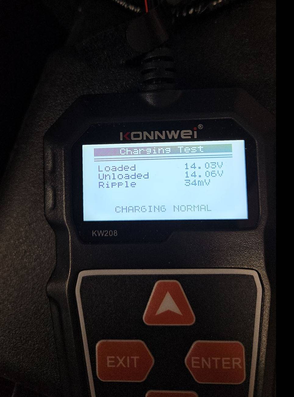

Charging system test:

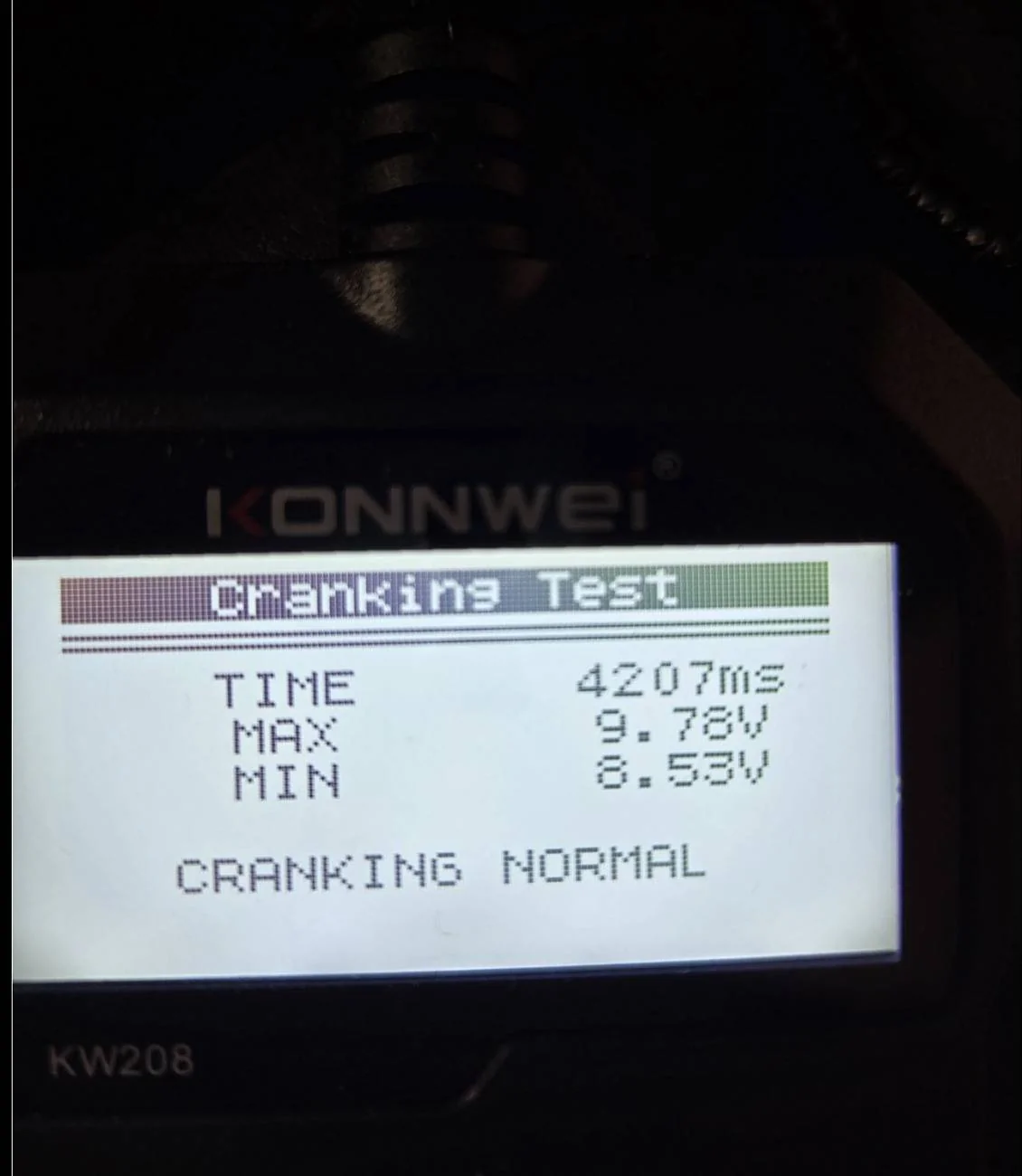

Cranking (starter) test:
So I guess it’s perfectly fine that the voltmeter consistently shows it being in the lower half of the dash display (between the minus sign in the battery icon and the left side of the battery case in the icon).
If you have a non-hybrid ORP, is your voltmeter also always in the lower half too?

most oem's will show battery meter within the middle section (same goes for temp gauge). oem's have learned over the years that if you dont show it in the middle or close to the middle people will come in an complain when it was within operating specs (not low or high, more so during the 3/36 timeframe and waste dealer/tech time for nonsense)

My voltage looks the same as yours. I'd much prefer a numeric digital read out. My solution was just adding one of these. Toyota could do better with the digital dash options.
