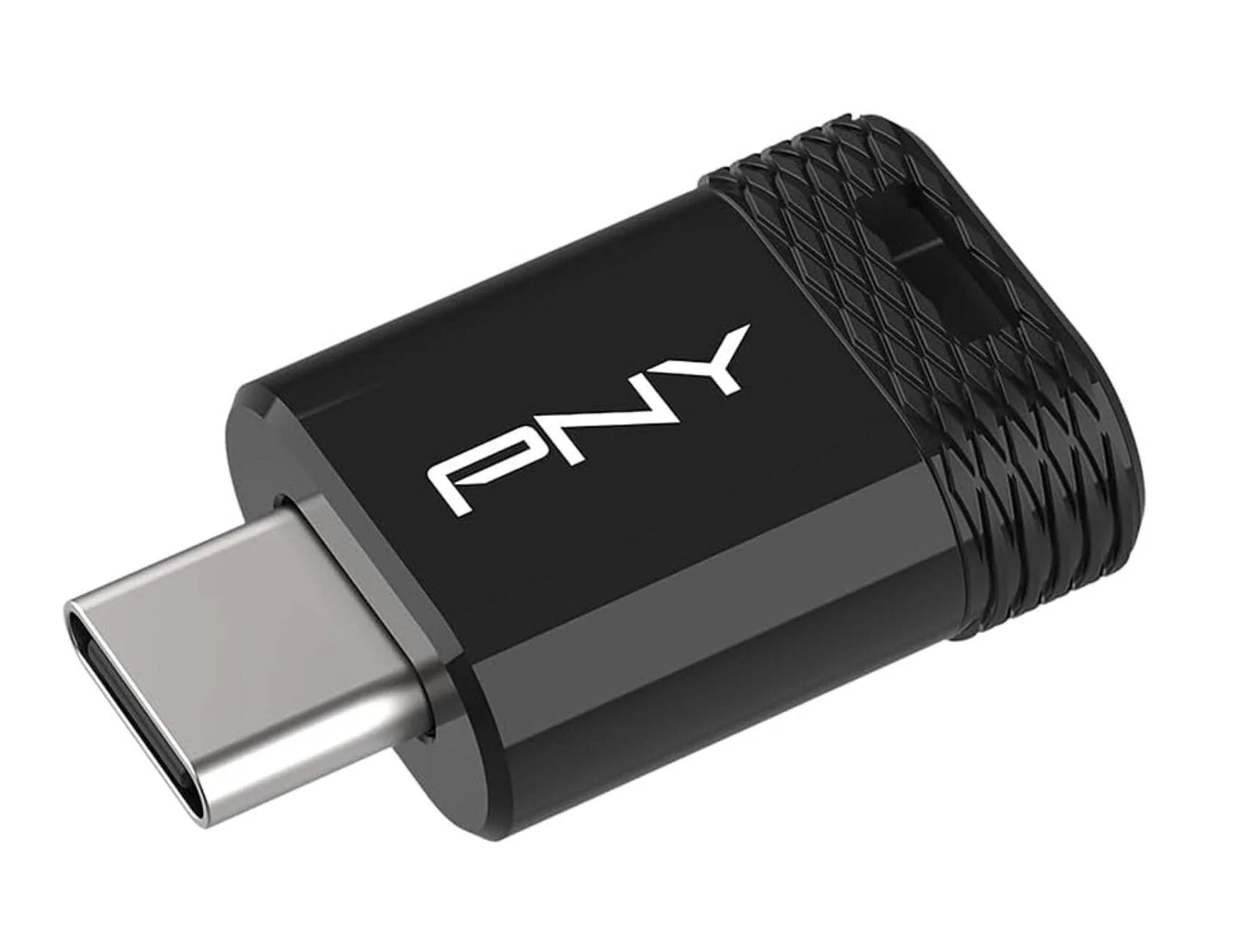

Once you plug the USB-C stick in, go into Music and click the Source button and it'll show up there based on the volume name.
I picked up one of these PNY Elite-X Fit Type-C USB 3.2 Flash Drives with 256GB capacity because it can hold a lot of music and has a very compact profile that blends right in with the rest of the interior. Mine has 2,200 audio CD's ripped to MP3, with room to add more...
I just plug it in with the PNY logo facing away so it's all black

According to the manual, the 4runner supports a maximum of 32GB USB stick for music. Can you confirm that you can see more than 32GB of music files using this 256GB USB flash drive plugged into the 14" monitor's USB-C slot?

Yes. It works just fine. I have 180GB of music on my memory stick and it indexes and plays the MP3 files no problem.

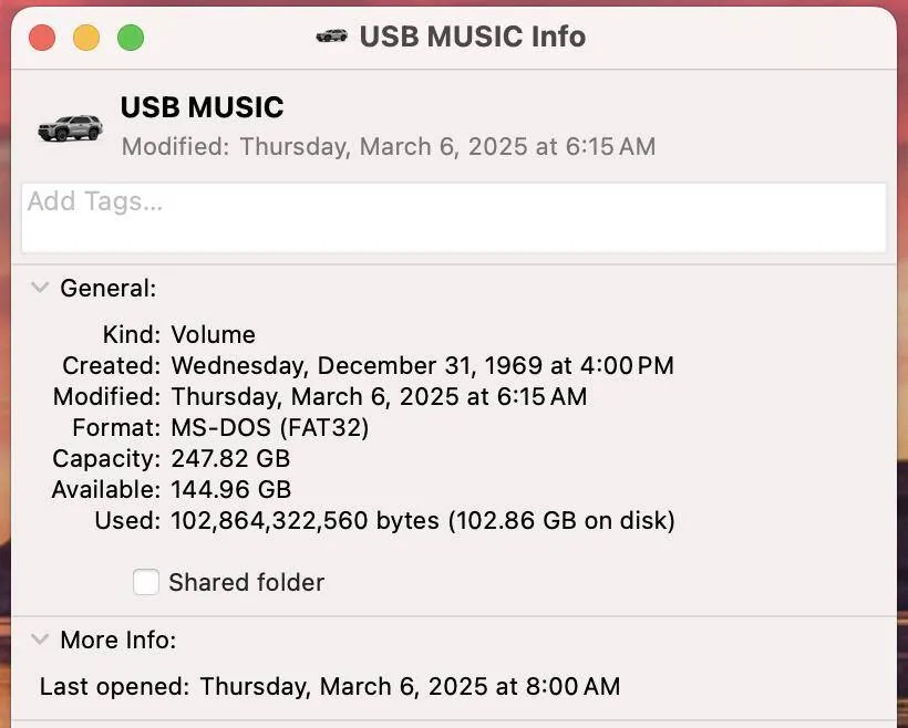

My memory stick is formatted FAT32 (done using Disk Utility in MacOS 15). As far as I know, there isn't a 32GB limit on FAT32, so it works just fine.

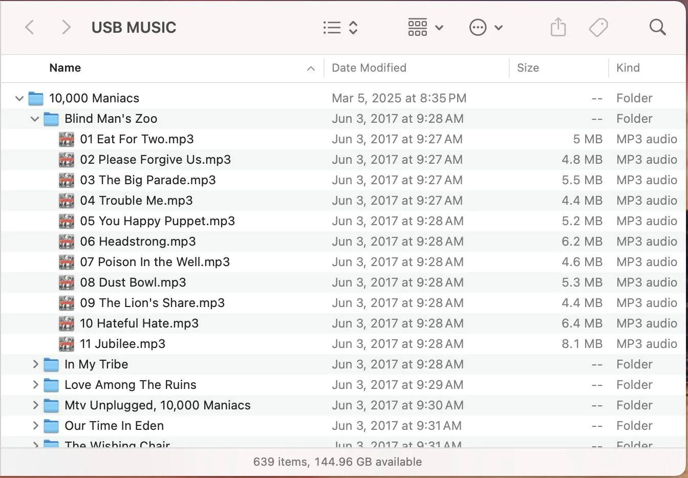

The master copy of my music collection is stored on a NAS in FLAC format, but I ripped all of it (2,200 CDs worth) into MP3 format, which is what I copied onto the USB memory stick. The folder structure is as you describe:
Artist > Album(s) > Tracks with a folder.jpg file with the cover art.
When I ripped the FLAC files to MP3, I also embedded the album artwork into each of the MP3 files, which helps it show up on the infotainment screen, although, Toyota also seems to use the Gracenote database to pull some of that info, too.
Here are a few screenshots to answer your questions:

Thanks a lot for that info! I just looked it up and the 32GB FAT32 limit is a windows thing, but you can apparently get around it with a 3rd party tool called Rufus.
Did you convert everything to mp3 just because the size, with all files as FLAC, was >256GB of the flash drive?
That conversion must have taken hours! What mp3 bitrate did you convert to?
If I also convert all FLAC to mp3 and embed the album art, I'd have to find a utility. Hmmm, I have dBPowerAmp and it looks like it can convert FLAC to mp3 with embedded album art. Hopefully as a batch.

Thanks again for the tip that the 32GB limit in the manual isn't accurate. 256GB USB flash, formatted FAT32 using Rufus, is up and running. It comprehends FLAC files fine. I put a few M3U playlist files in the root directory but it doesn't seem to recognize them. Bummer. I guess I could create an artist called "AAAplaylist," then subdirs playlist1,2,3 etc, with copies of the songs in each playlist.
