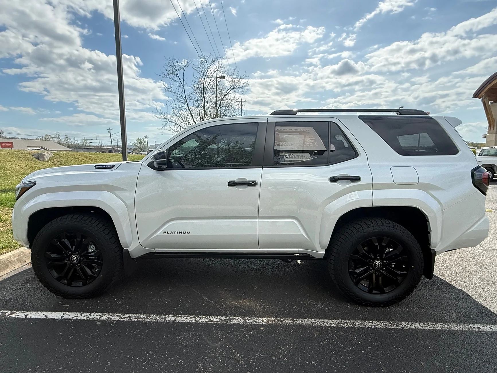

Could you give me a little more detail? 😄. Just joking, awesome answer! I’m used to having rear lockers, so that was my “concern”, if you want to call it that! I was thinking an ORP, but my wife wanted more luxury. I also liked the idea of full time 4wd so if she’s driving in snow or rain, she doesn’t need to worry about what setting to be in. I did tell her that if we bought it, I would immediately put better tires on it. 😄.
2025 2026 4runner 6th gen Full time 4wd ATRAC. IMG_4140

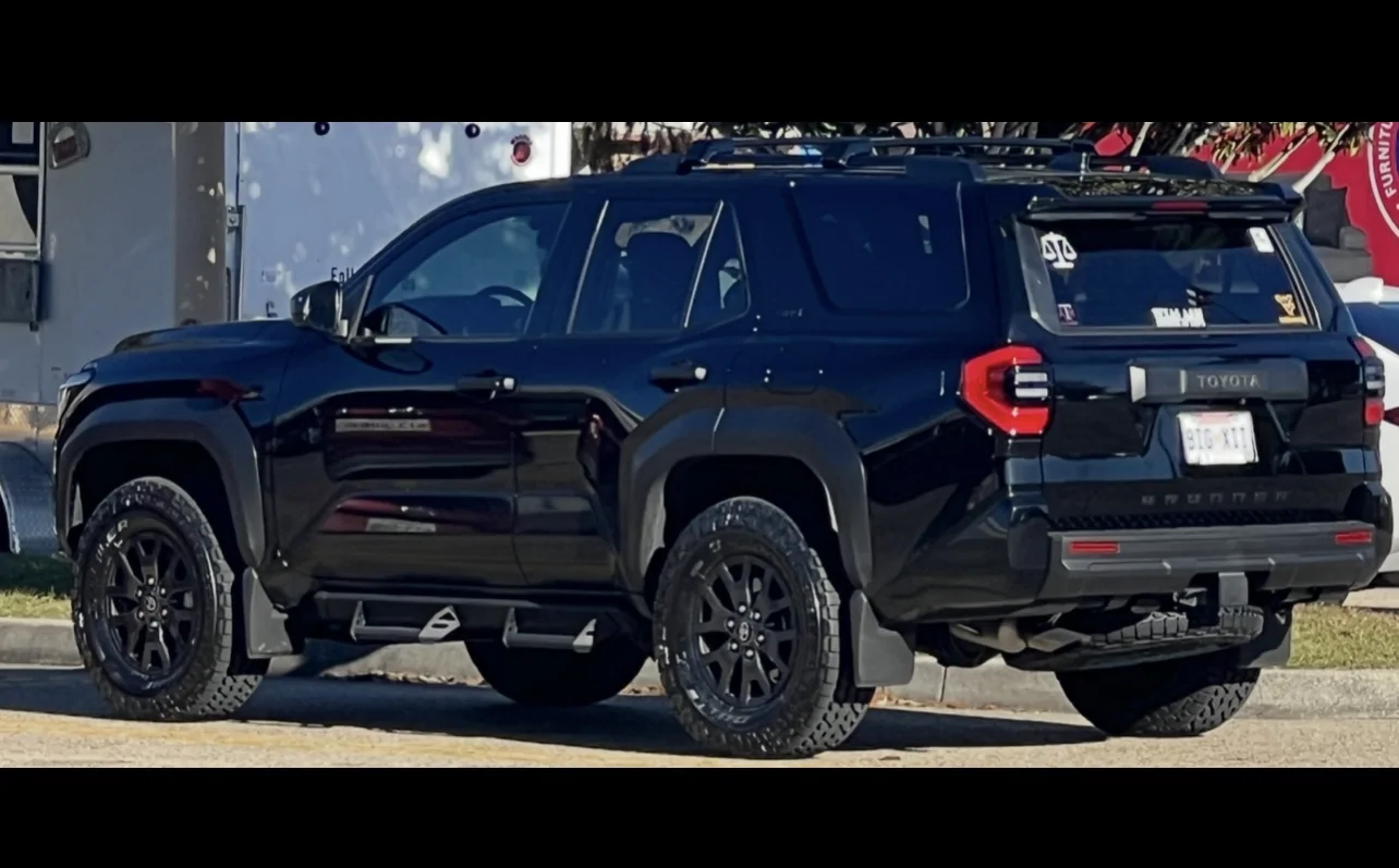

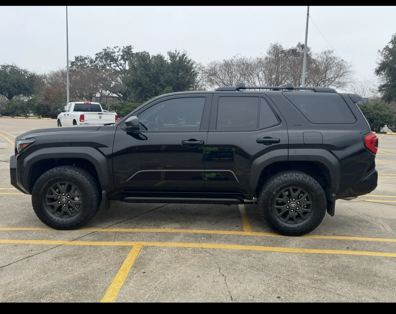

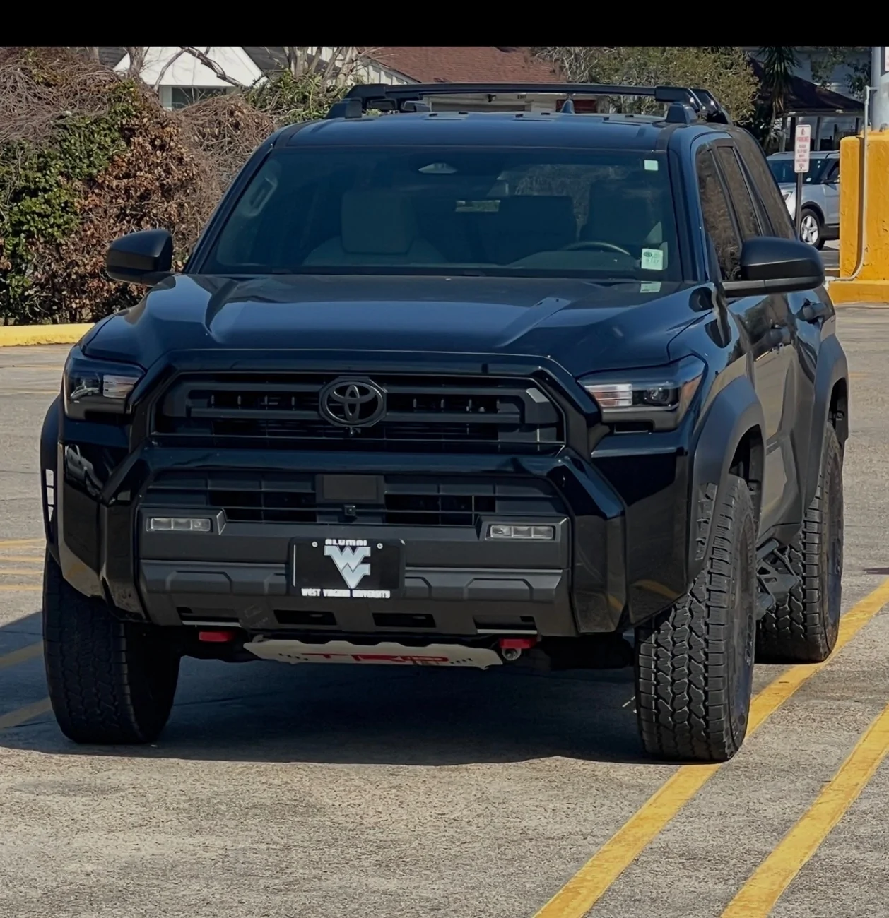

😂😂😂😂😂😂😂😂..thank you..that platinum is super nice..i think it's the 3rd most expensive Trim just behind the TH AND TRD PRO...I purchased the 2025 SR5 4R w/PT4WD...i'm at the PHEASANT LEVEL..😂😂😂..however, i modified my rig...here are some pictures..1.5 inch leveling kit, front, rear diff, and transfer case skid plates installed, removed the predator steps and placed oem rock sliders & front tow hooks, removed all of the 245 70R17 tires and placed 285 70 R17, and Purchased a full spare with 285's...also, i installed front camera so i can see what i'm crawling over. then, i removed all the oem interior mats and purchased LASFIT..and Finally, i installed leather seat covers from a 3rd party that matches the leather in ORP..black..I also removed the SR5 emblem..lol..
