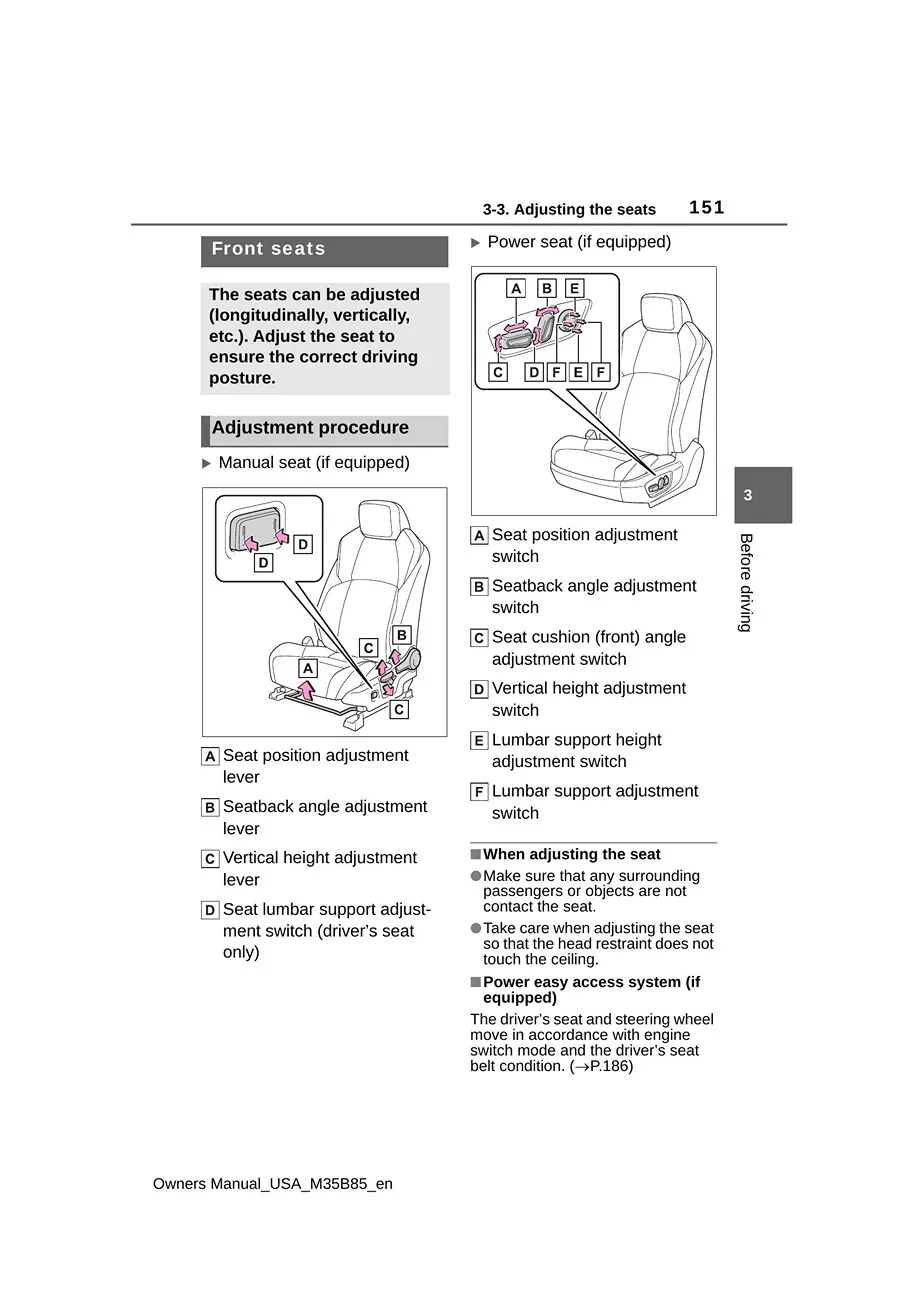

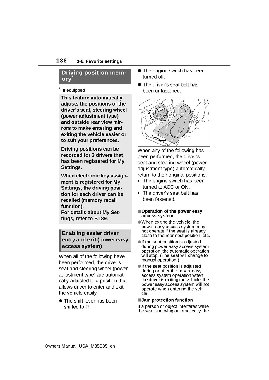

This is not my work. It has been borrowed from:
https://4runner6g.com/threads/how-to-set-power-seat-memory-settings-on-2025-4runner.631/
How to Customize Driver Comfort and Save Your Seat Preferred Positions
(Reference: 2025 Owner’s Manual, pg. 151, 186)
Link to Owners Manual: https://trail4runner.com/wp-content/uploads/2025/03/2025-4runner-owners-manual.pdf
The 2025 4Runner offers multiple ways to adjust seating comfort with available power front seats and driver memory presets. Whether you're tackling long road trips or hopping in after another driver, here's how to fine-tune and save your seat settings.
Power Seat Adjustments (pg. 151)
Adjustments vary slightly by trim, but most 4Runners with power seats include the following controls located on the side of the seat:
  • Seat Slide: Moves seat forward/backward
  • Seat Height & Tilt: Raises or lowers the seat and tilts the front edge for leg support
  • Seatback Angle: Reclines or straightens the backrest
  • Lumbar Support: Expands or contracts lumbar cushion to support lower back
  • Vertical Adjust (Driver’s Seat Only): Controls total seat height
Make all adjustments while the vehicle is stopped. Avoid pressing multiple seat switches at once.
Seat Position Memory System (pg. 186)
Some trims offer a memory function that stores preferred settings for two drivers. It saves:
  • Driver seat position
  • Steering wheel position (if equipped with power tilt/telescoping)
  • Outside mirror angle
To set memory:
  1. Turn the engine switch to ON
  2. Adjust seat, mirror, and steering positions
  3. Press and hold the “SET” button, then press memory button “1” or “2” until the system chimes
To recall:
Press the desired memory button while the door is open or the brake is pressed
Memory-linked settings can also be paired with specific smart keys so the vehicle auto-adjusts when unlocked.
2025 4Runner Power Seat Adjustments and Memory Settings Diagram
Refer to pages 151 and 186 of the Owner’s Manual for seat control locations, memory buttons, and programming instructions.
2025 2026 4runner 6th gen Electronic settings issues - seat adjustment, air conditioner, etc. Power_Seat_Adjustments_Diagram_01-01
2025 2026 4runner 6th gen Electronic settings issues - seat adjustment, air conditioner, etc. Power_Seat_Adjustments_Diagram_02-01
