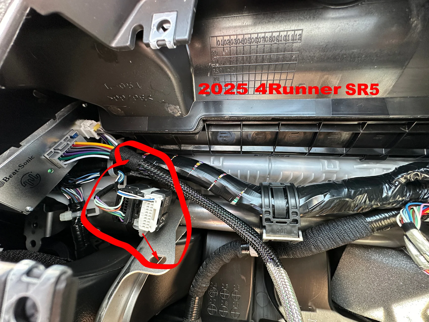

This is under the dash of the 25 4Runner SR5. There are two plugs just parked, and I am trying to unplug the white one, but I can't figure out how to do it. Any help would be much appreciated.

if i remember correctly if you dont have a clip (yellow circle) but you do have a hole (green circle)
you can slide a small flat head to unclip it. but be gingerly about it, its easy to crack break those clip/housings
