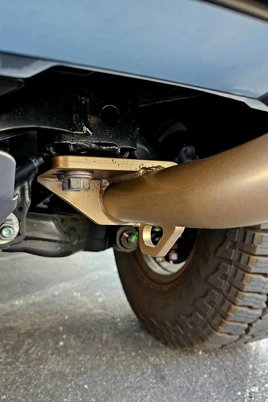

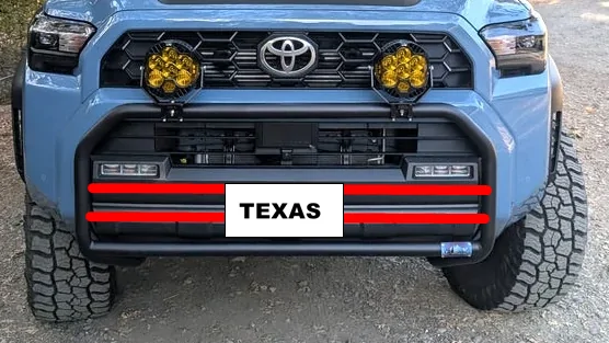

My two cents:
I don't like the Sharp edges on that hole.
I would never use a soft shackle on that.
You will have to have hard D shackle mounted and most likely use a bridal technique to pull evenly on the front of that Bush bar.
Just my two cents
Yeah I see what your saying, I don’t plan on taking this truck through the most difficult terrain though and the extra insurance of the bar in the city I live and work in where no one knows how to drive works for me.
