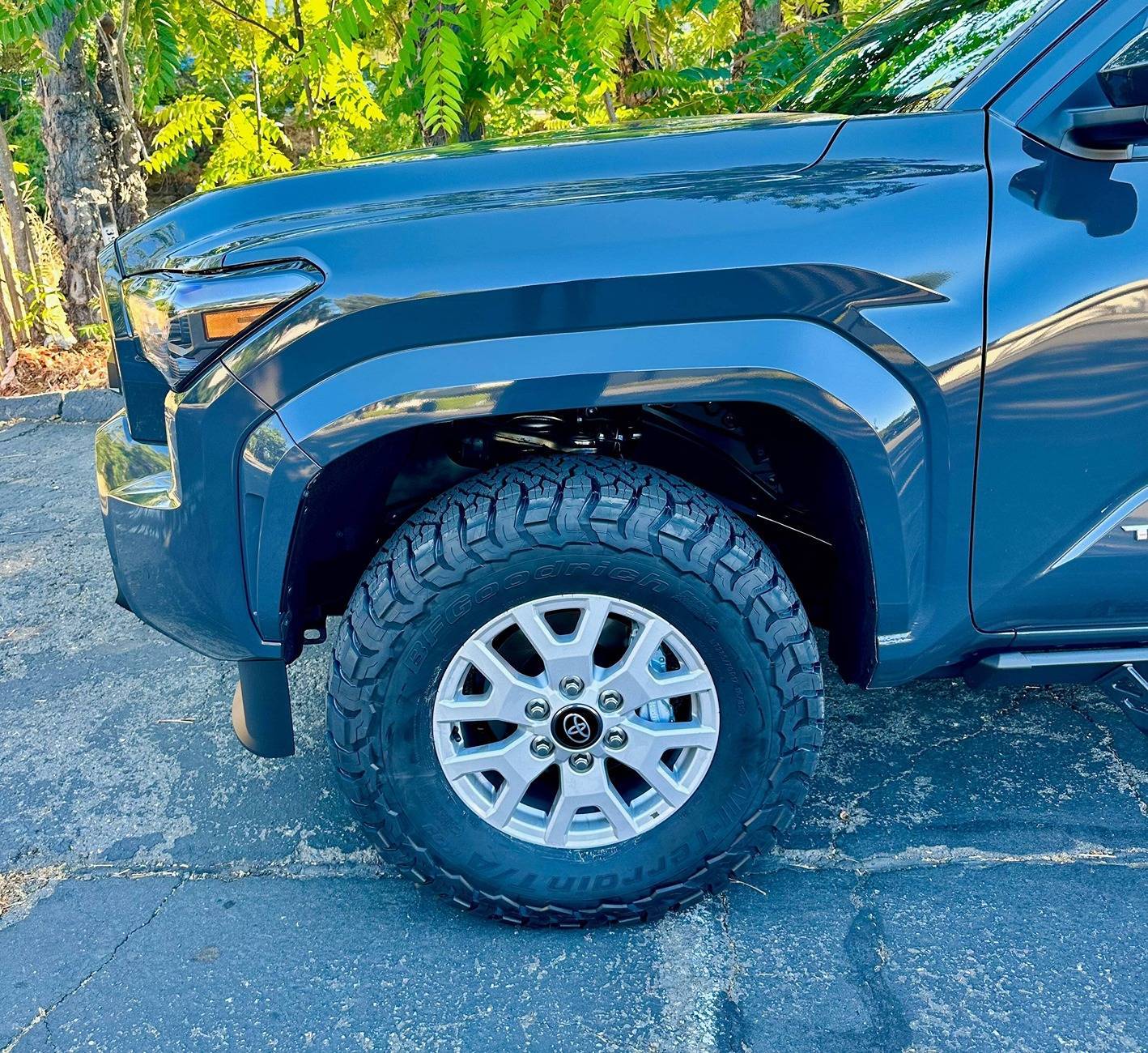

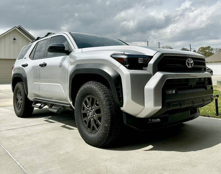

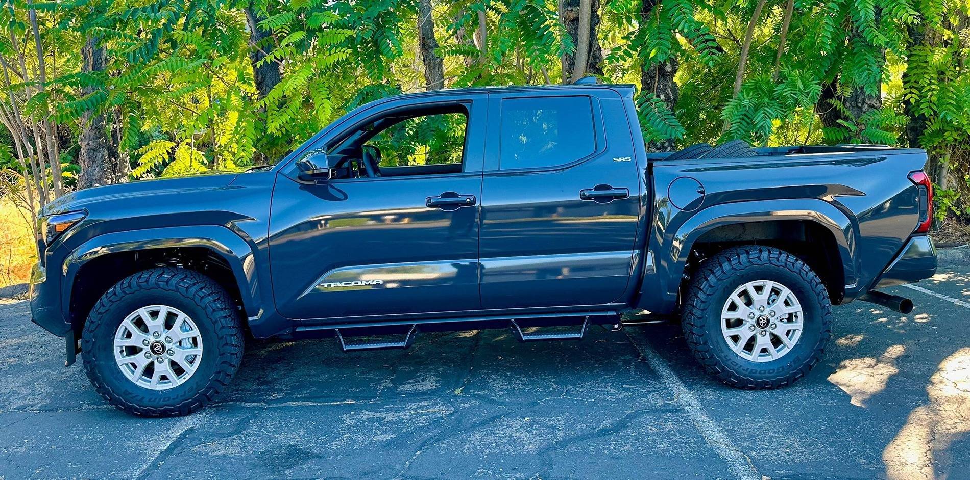

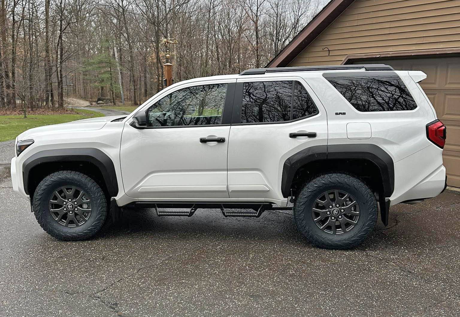

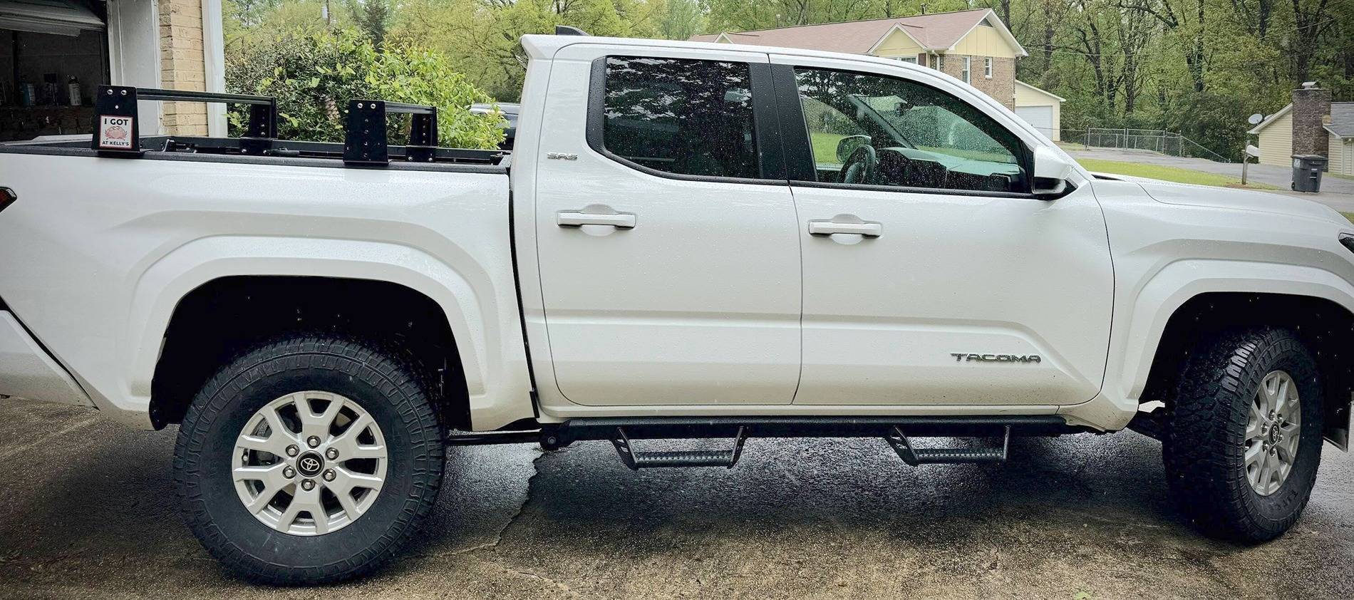

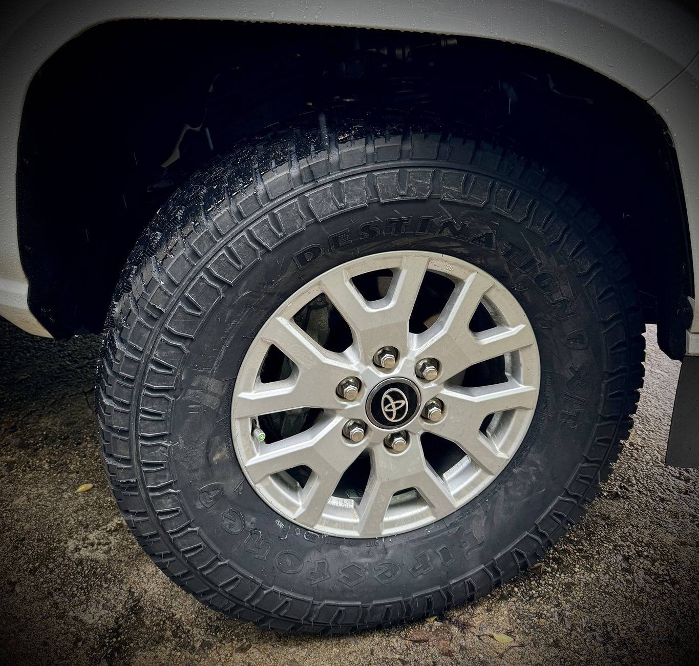

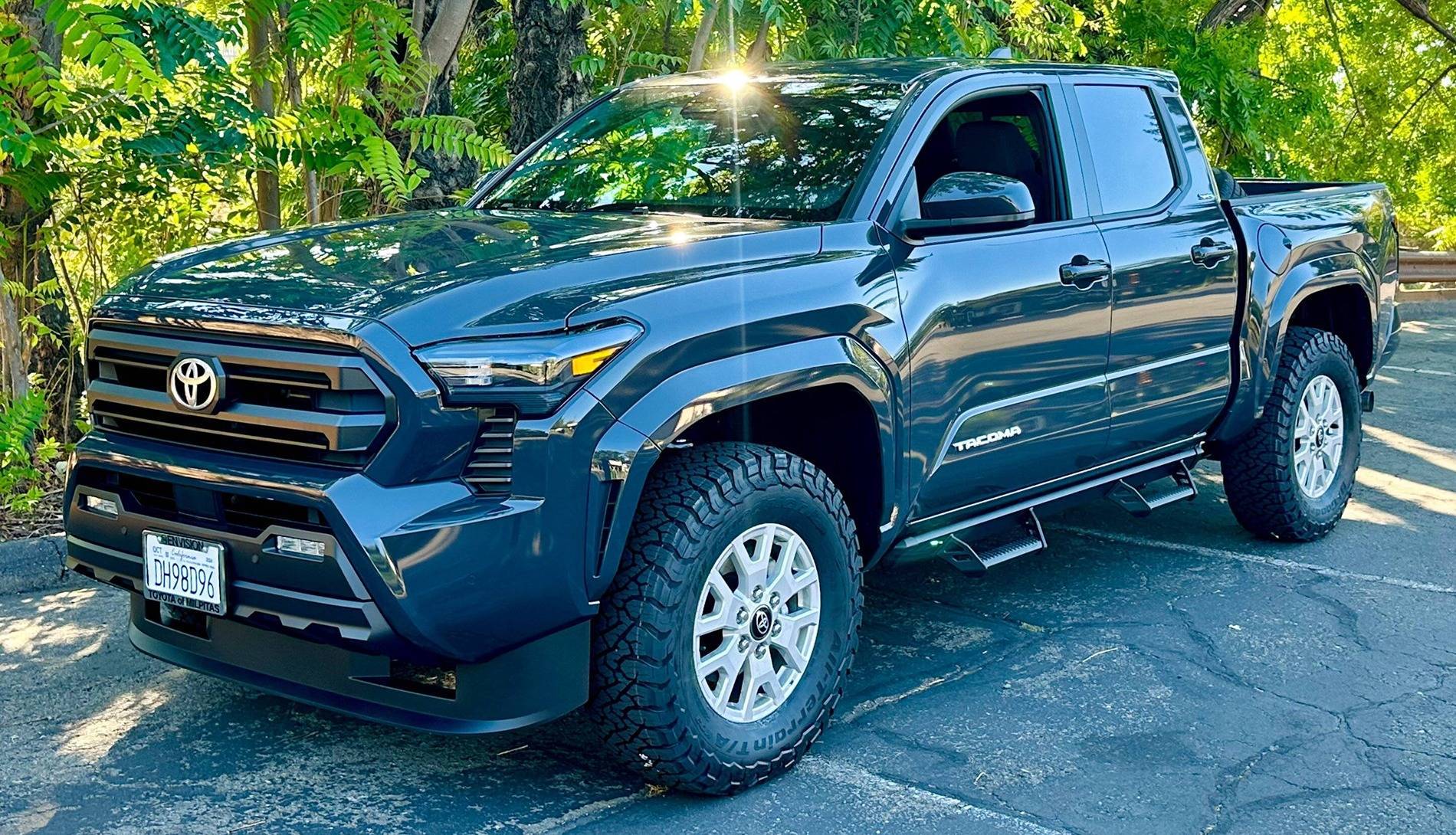

You can fit up to 33's on factory SR5 17" wheels.
Here's two examples of 33" tires on stock SR5 wheels on 2024 Tacomas (same fitment as 2025 4Runner) without modifications and no rubbing:
285/70R17 BFG KO3 tires (source)

285/70R17 Firestone Destination X/T tires (source)

Appreciate it! I like the look of the tacoma with KO3 better than the firestones
