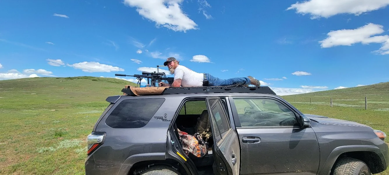

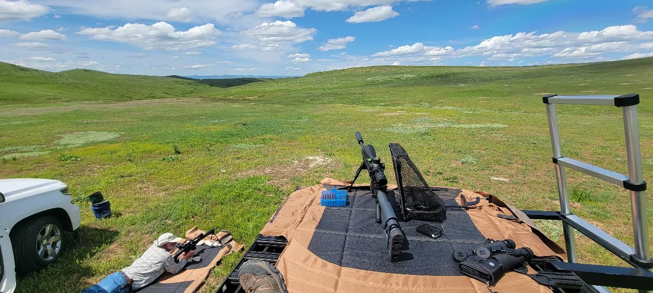

I used my Sherpa full rack on my 21 for a hunting platform. Cut some 3/8" plywood into couple feet sections so I could put it in the back easily. Used small c clamps in the field to keep it from moving around in the field when on it. Built a standoff that hooked on the side rail I could lean a collapsible RV ladder against it and not hit the body climbing up and down. Worked great. Didn't want a ladder on the tailgate

Can't find a good pic on the ladder side
2025 2026 4runner 6th gen ARB 3/4 Rack as standing platform for photography? 20220609_144043
2025 2026 4runner 6th gen ARB 3/4 Rack as standing platform for photography? 20220609_143237
