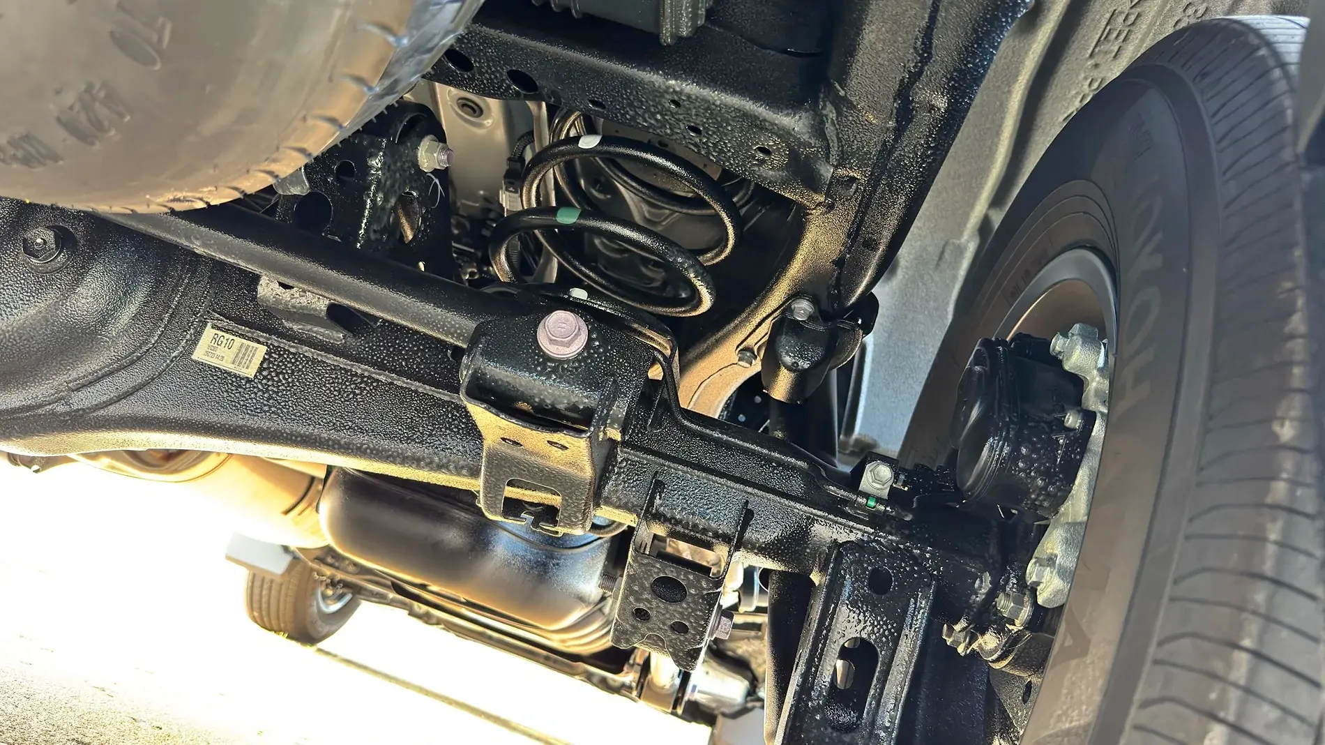

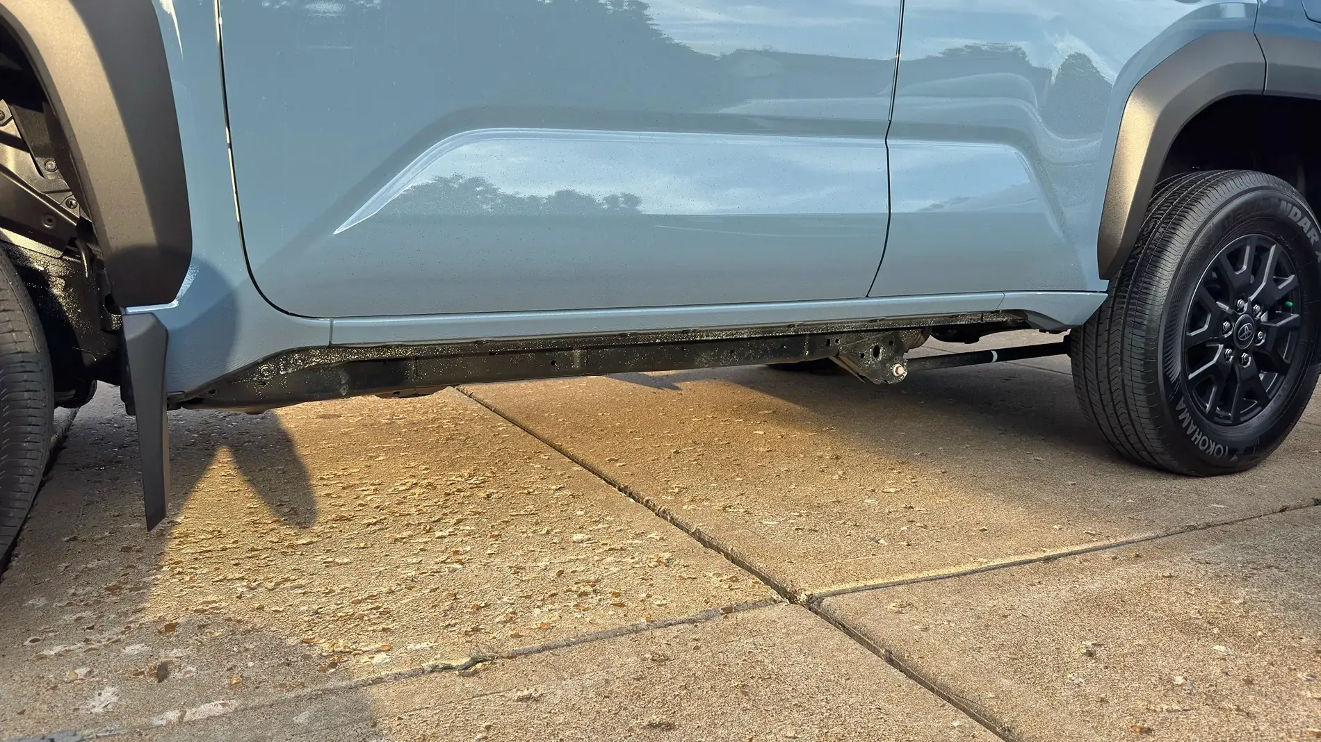

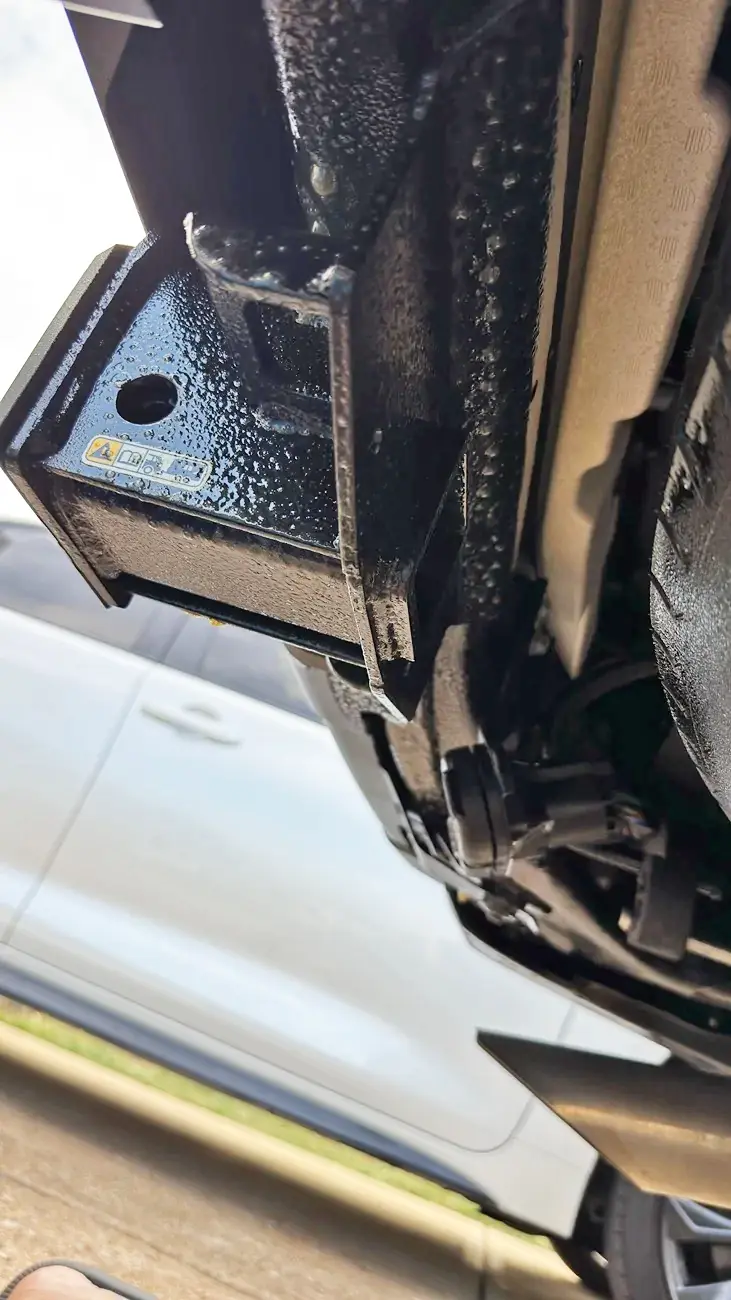

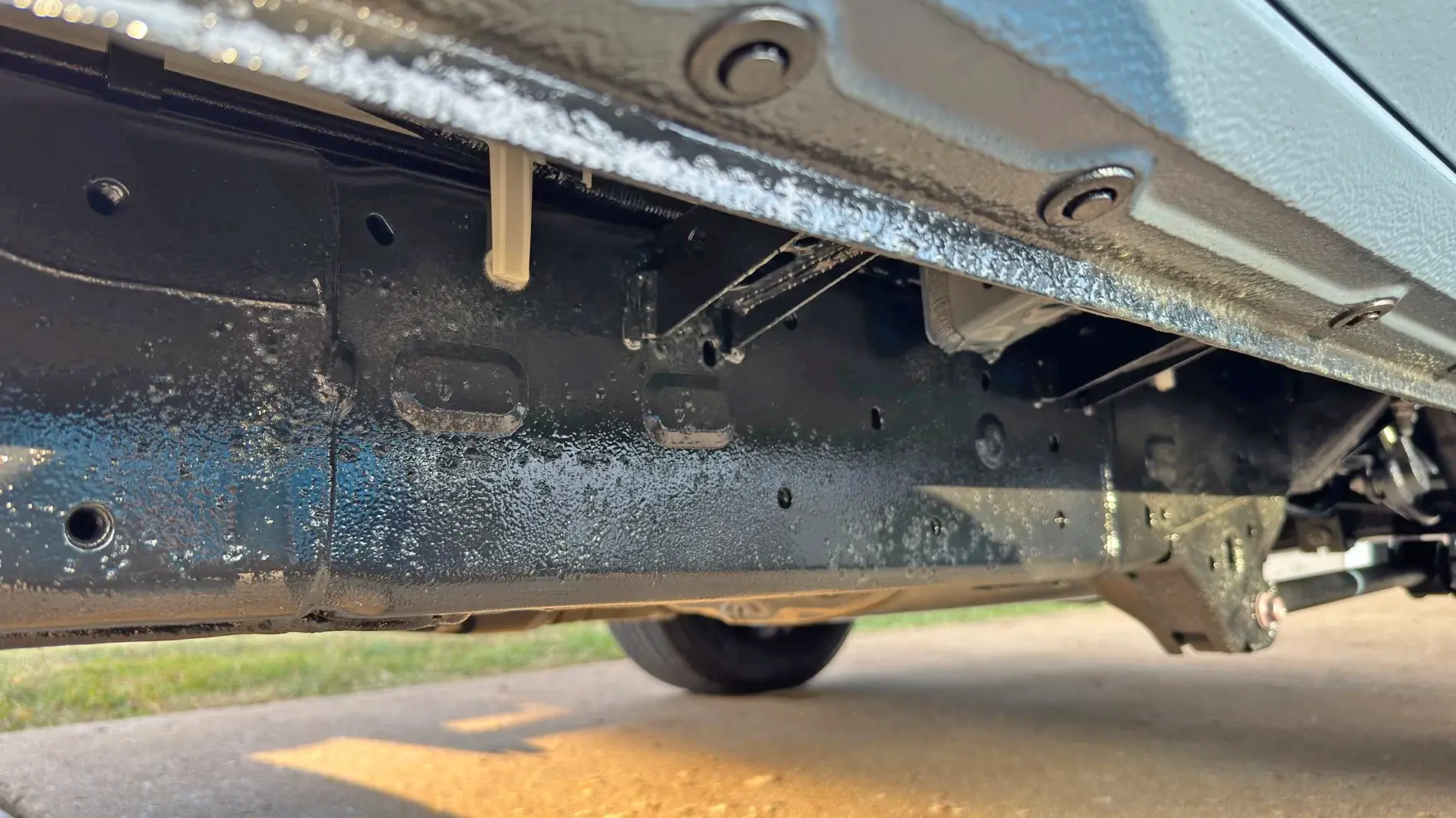

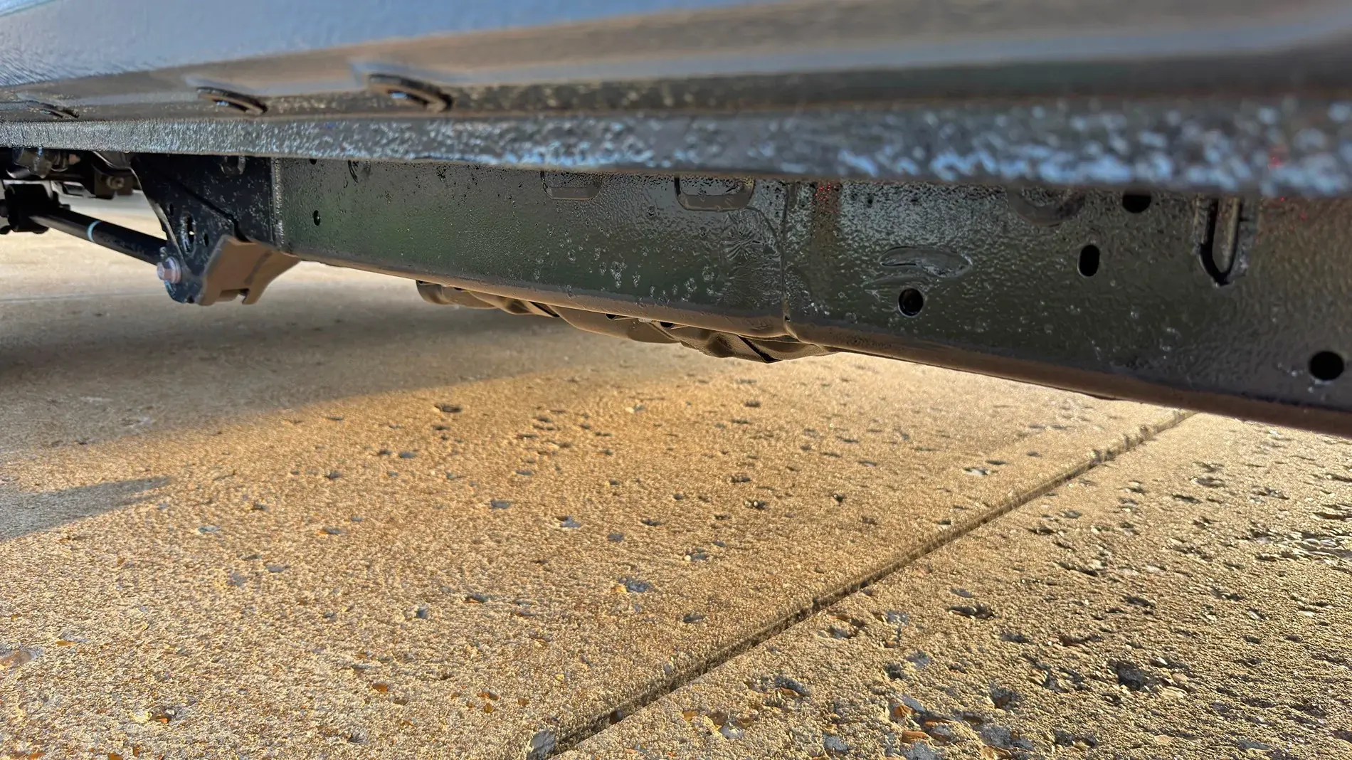

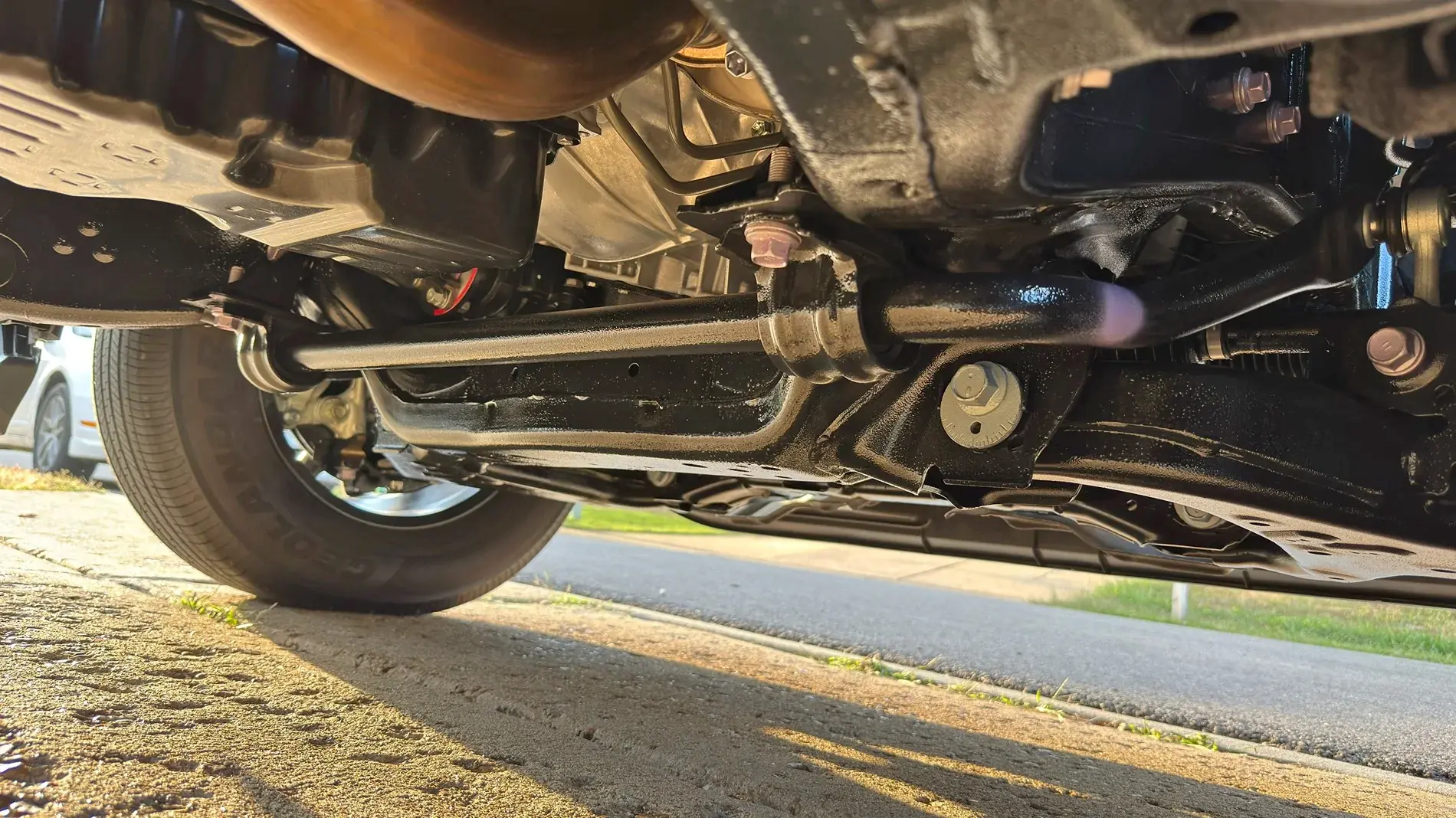

Prepped the SR5 for the winter with Blasters Surface Shield. Did it myself with the kit below linked below. I’m no means an expert on application and I just followed “Repair Geeks” how to guide on apply it correctly.
Here my tips
- Prep correctly
- Take your time
- Wear personal protective equipment. Over spray will happen
- Have fun making your 4Runner last longer.

Yes I took down the spare tire and pulled back the wheel well covers with the tires off. Job took about 3 hours total. And well worth it in my opinion.

I used jacks so I can take the wheels off while I sprayed the wheel well and put the wheels back on. With the car on jacks and tires installed. Then I shimmied my way under car. Lol.
