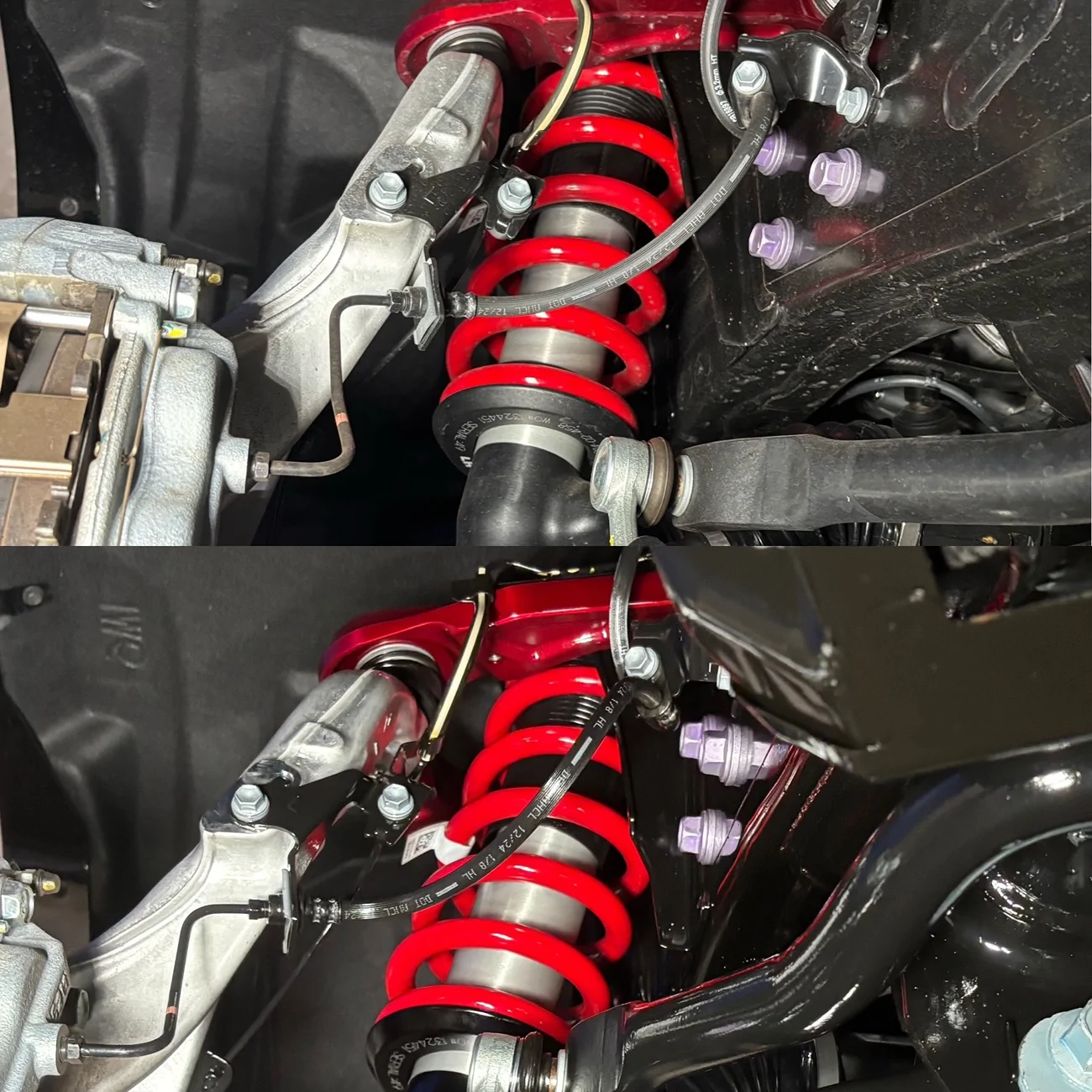

I had CryoMode remove the wheels, skid plates and do an industrial grade ceramic coat over the entire undercarriage, frame rails, suspension and tow hitch. Supposed to last 10 years. Water beads like crazy and clean up is a breeze. Pick any spot in the following before/after pic to compare. They got everything and into every crevice they could possibly shoot. Highly recommended.
2025 2026 4runner 6th gen Undercoating thoughts? IMG_7612_Original
2025 2026 4runner 6th gen Undercoating thoughts? CC6E7B34-AB61-4E55-AF4C-433D8171F09F

I'm having a hard time believing ceramic undercoating will last ten years..
