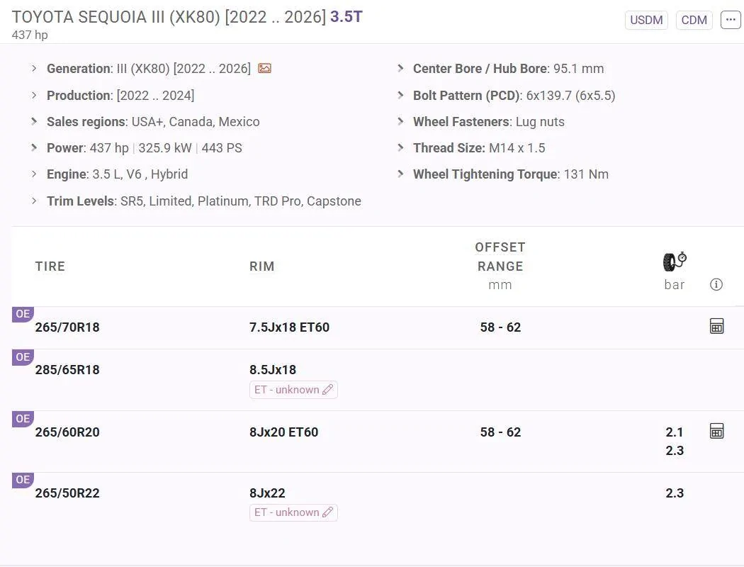

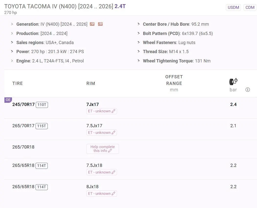

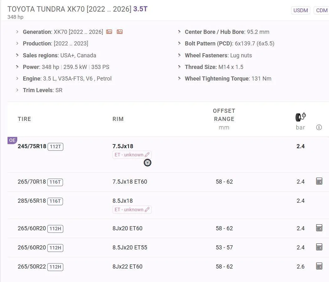

So the 2024 4Runniner 20" OEM wheels are:
Bolt Pattern:
6-139.7 (same as 5th gen)
Lug Nut Size:
14x1.5 (different than 5th gen's 12x1.5)
Hub Bore / Center Bore:
95.1 (different than 5th gen's 106.1)
so i am guessing toyota standardize all BoF vehicles to have the same specs?
if i remember correctly the 2024 tacoma and 2022+ tundra and the 2022+ sequoia use the same specs
i have our 2023 tundra wheels and tires still mounted in the garage and they look 100% better than the oem platinum gloss black wheels.
i want to swap them out but was concerned that the specs are not the same but from what i can see, they are the same.

Interesting... this opens up a ton of wheels choices for the 2025 4Runner then, as long as their offsets work.
1,844
1,029
i am guessing most oem offsets +58-62 are to keep the wheels/tires within the wheel wells per fed rules.
i know i have a +20 on the 2023 tundra and the tires stick out about 1in past the wheel wells.
here are the specs for my wheels
Fuel Flame 6 D823 (20x9, 106.10 Bore, +20 Offset, 6x139.7 Bolt Pattern, 5.790 BSM, 2500 lbs Rating, 41 lbs, Lug Conical, Milled Candy Red)
i had to hubcentric rings installed to get them on but the wheels came with them
