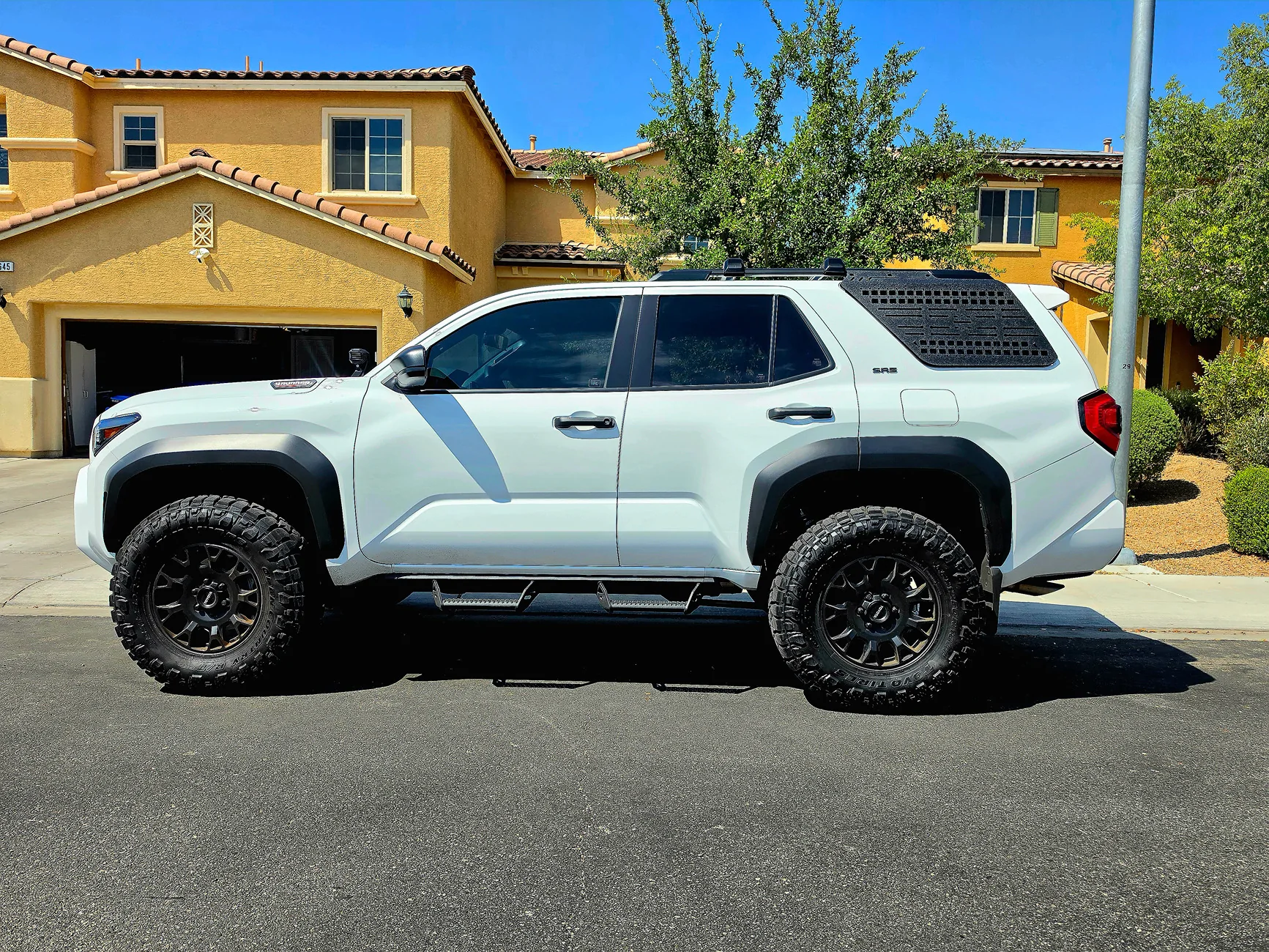

Im running Bilsteins 5100 all 4 corners with 2" rear OME springs with 35s.
2025 2026 4runner 6th gen 2026 4Runner SR5 – Westcott Lift + TRD Pro Wheels – 285/65R18 or 285/70R18? Toyo or Falken? 20260716_102349
