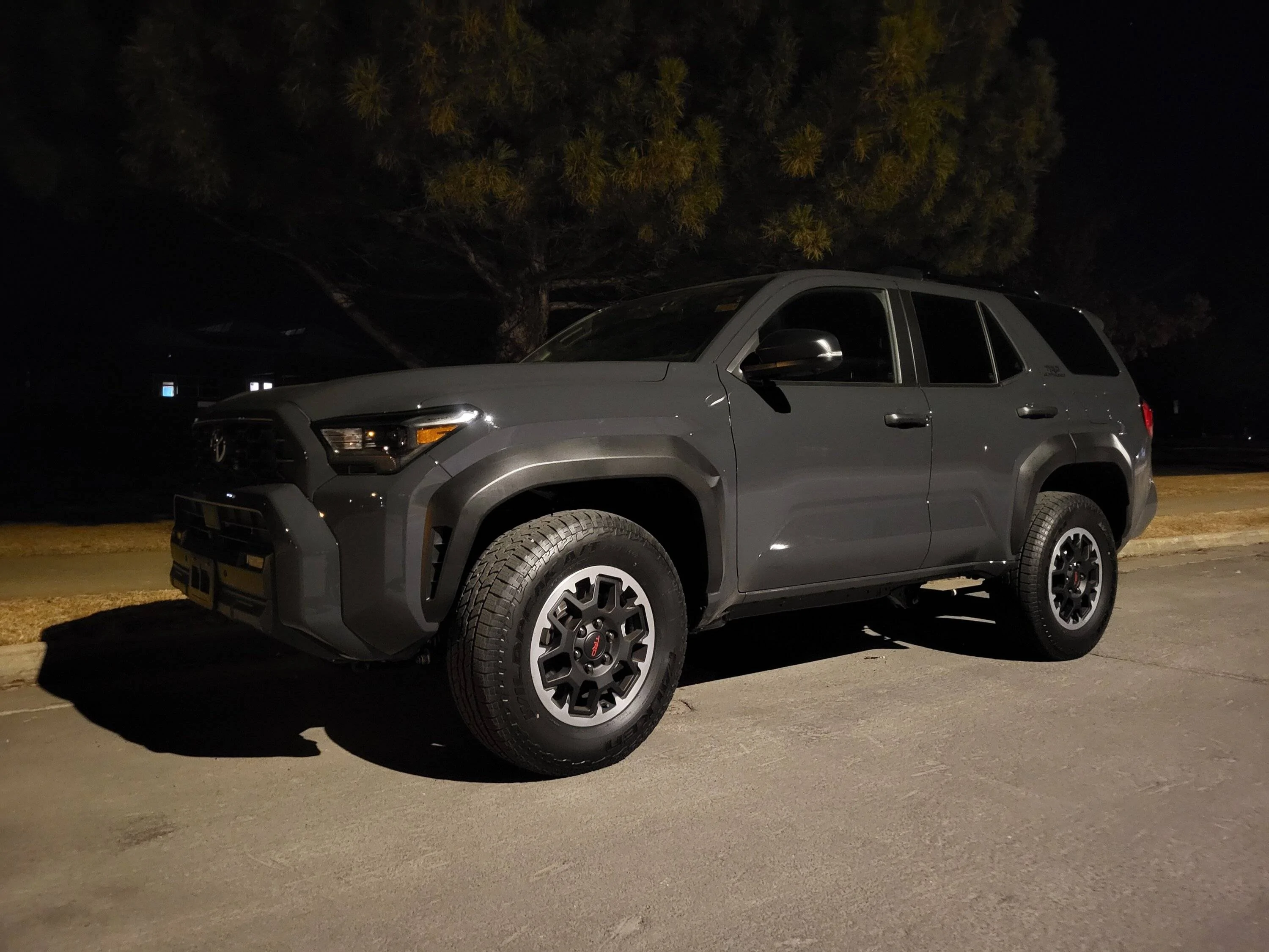

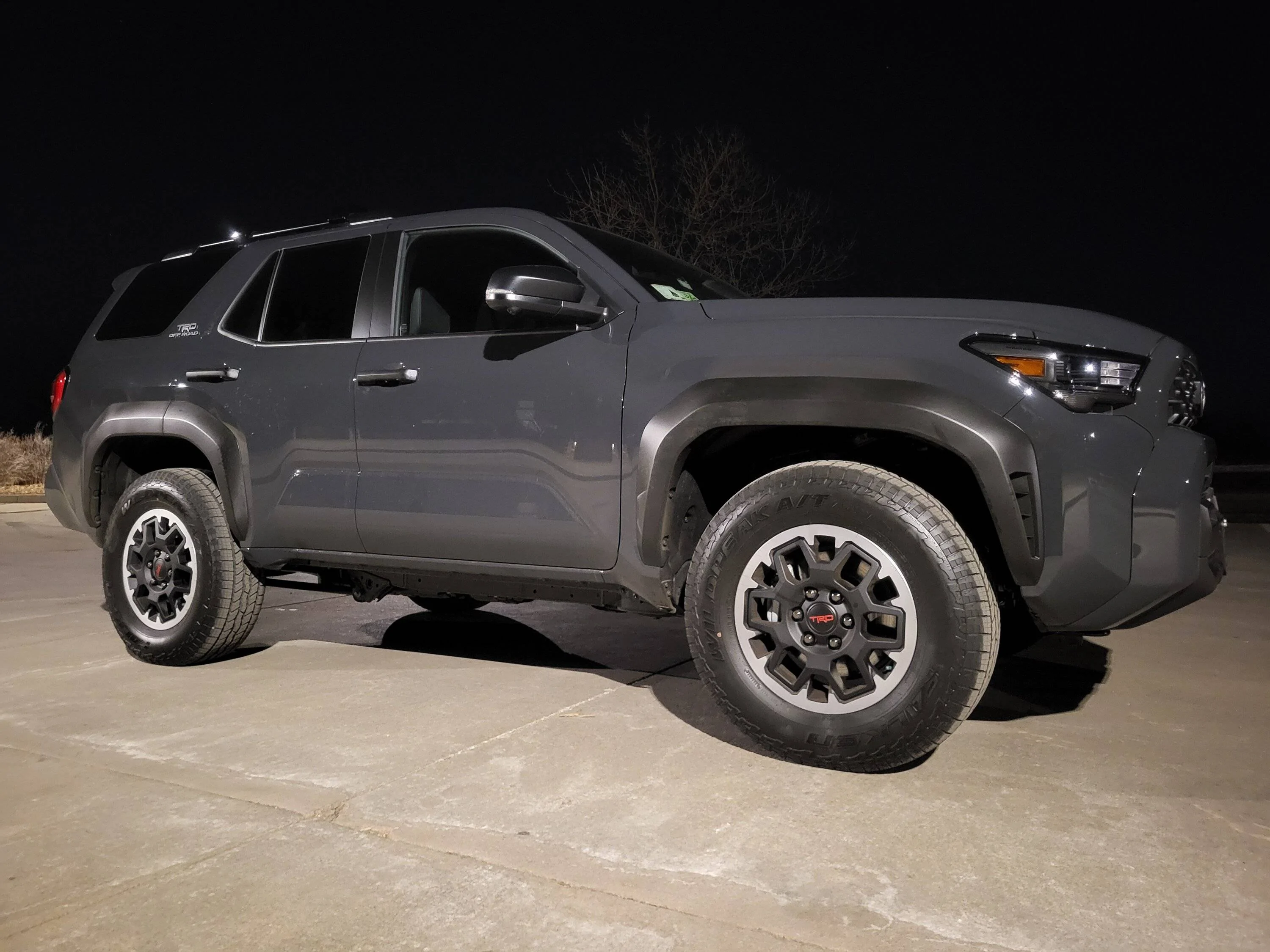

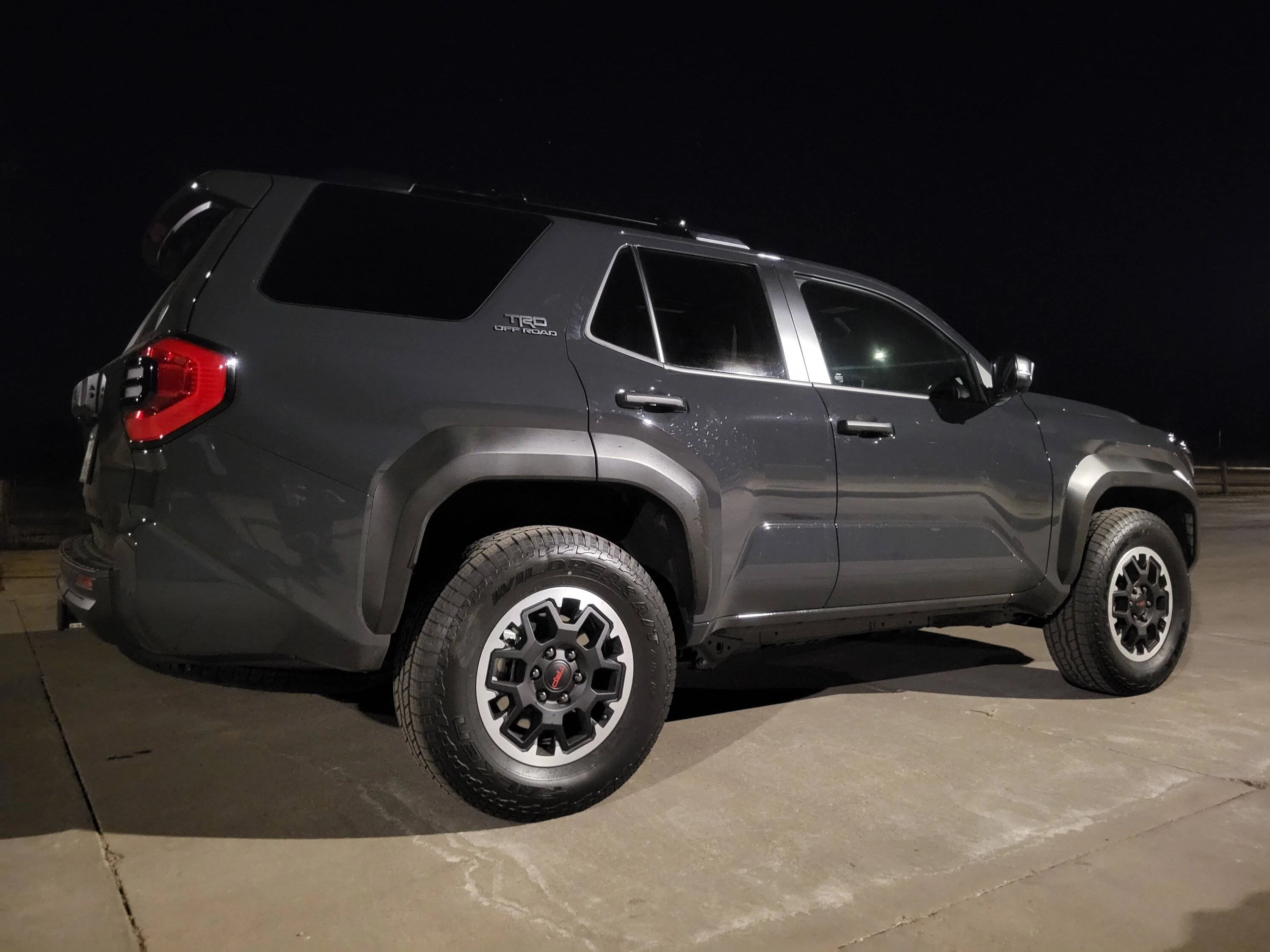

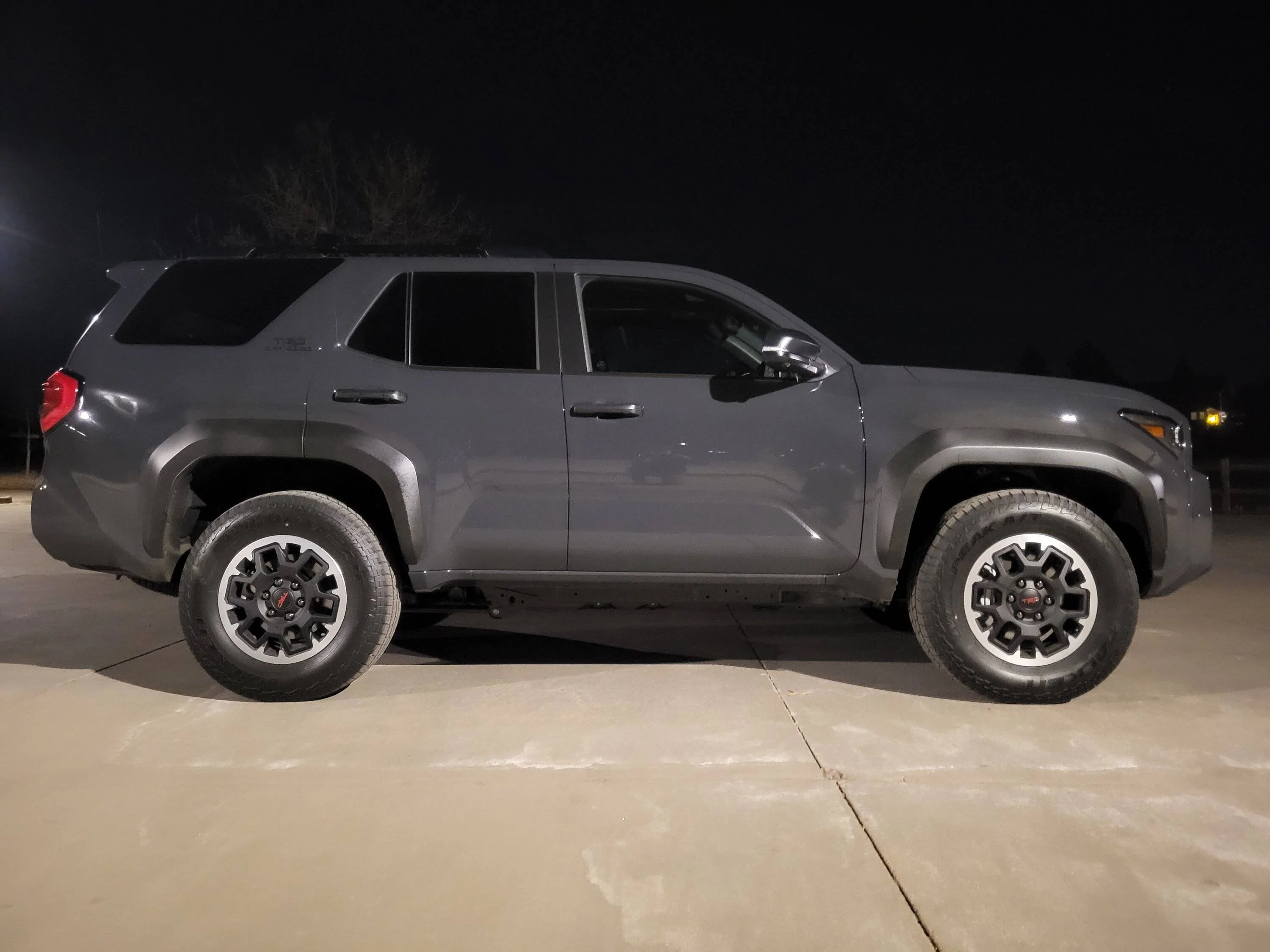

I took the chin and steps off this evening. This just takes a few minutes. On the chin (I think its called an air damn), there are nine 10mm bolts holding the chin on, and then two plastic clips you can release with your fingers after removing the bolts. The steps (running boards) have six 12mm bolts each. I'm going to keep the 9mm bolts with the chin in case I ever put it back on. I reinserted the 12mm bolts on the side so I don't lose them. I thought it was interesting that the steps are mounted to the body and not the frame. I'm now curious how the Toyota rock rails are mounted (as well as aftermarket rock rails/sliders).
I mainly just wanted to see what this looks like. I don't plan on buying rock sliders quite yet. But I think I'll just leave the chin and steps off. I think it looks better, I don't need the steps, and the I would eventually remove the chin or damage it on the trail. Here's what it looks like...

Looks super svelte and sporty like this. The steps you removed were the Predator Tube Steps? Or flat running boards?
