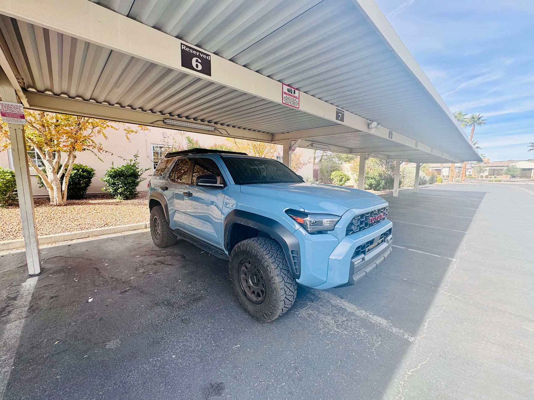

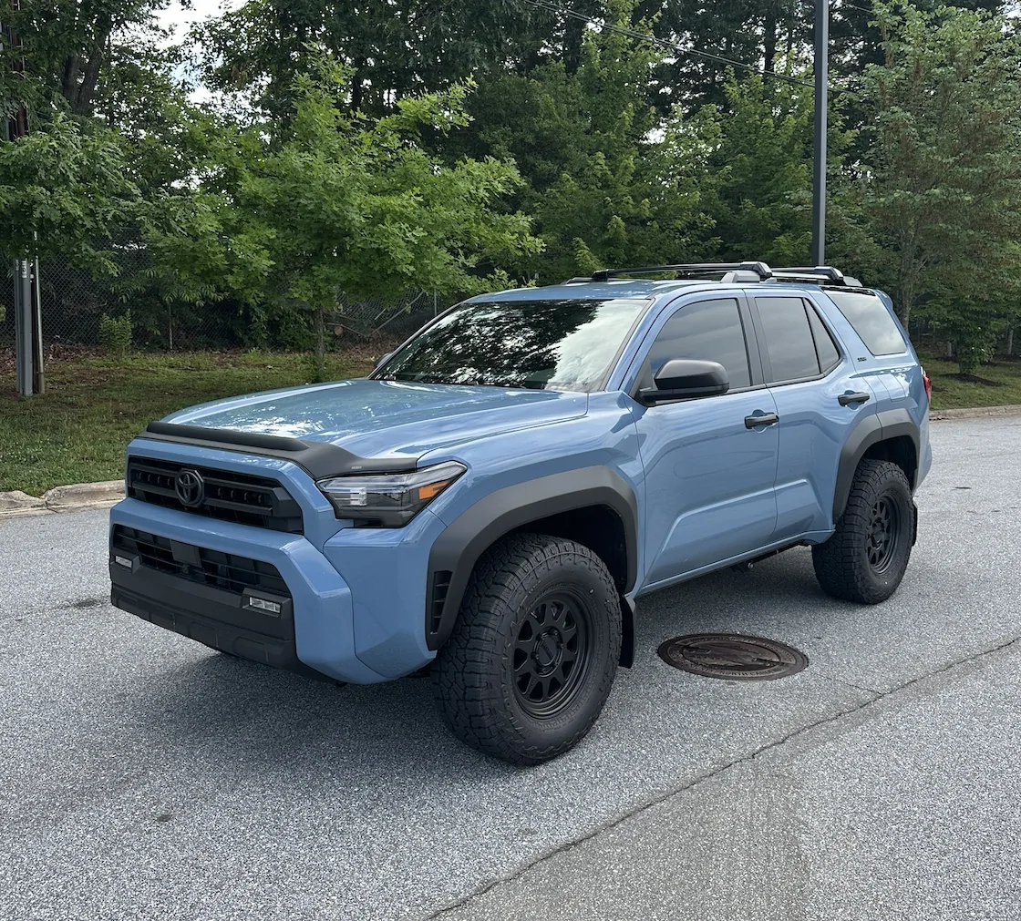

"UPDATE" lift installed. Didn't quit get 2.5" front and .75" rear but still lifted and leveled. Ride quality on OE SR5 shocks is great and exactly the same. Vehicle aligned up perfectly and I am genuinely happy. No more nose dive.

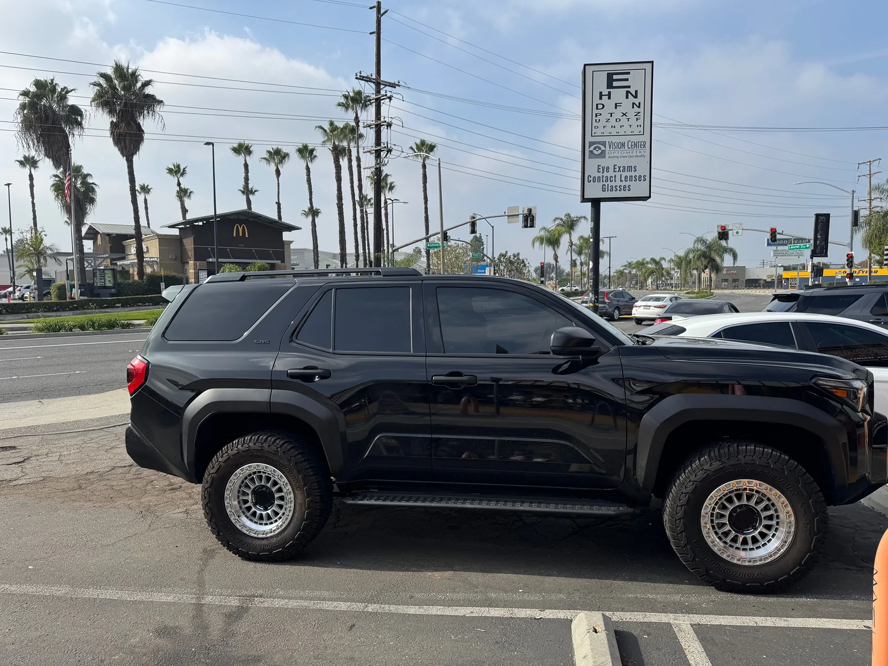

Same set up, westcott on oem. Actually feel like an improvement. I run 295/70R17 nitto ridge

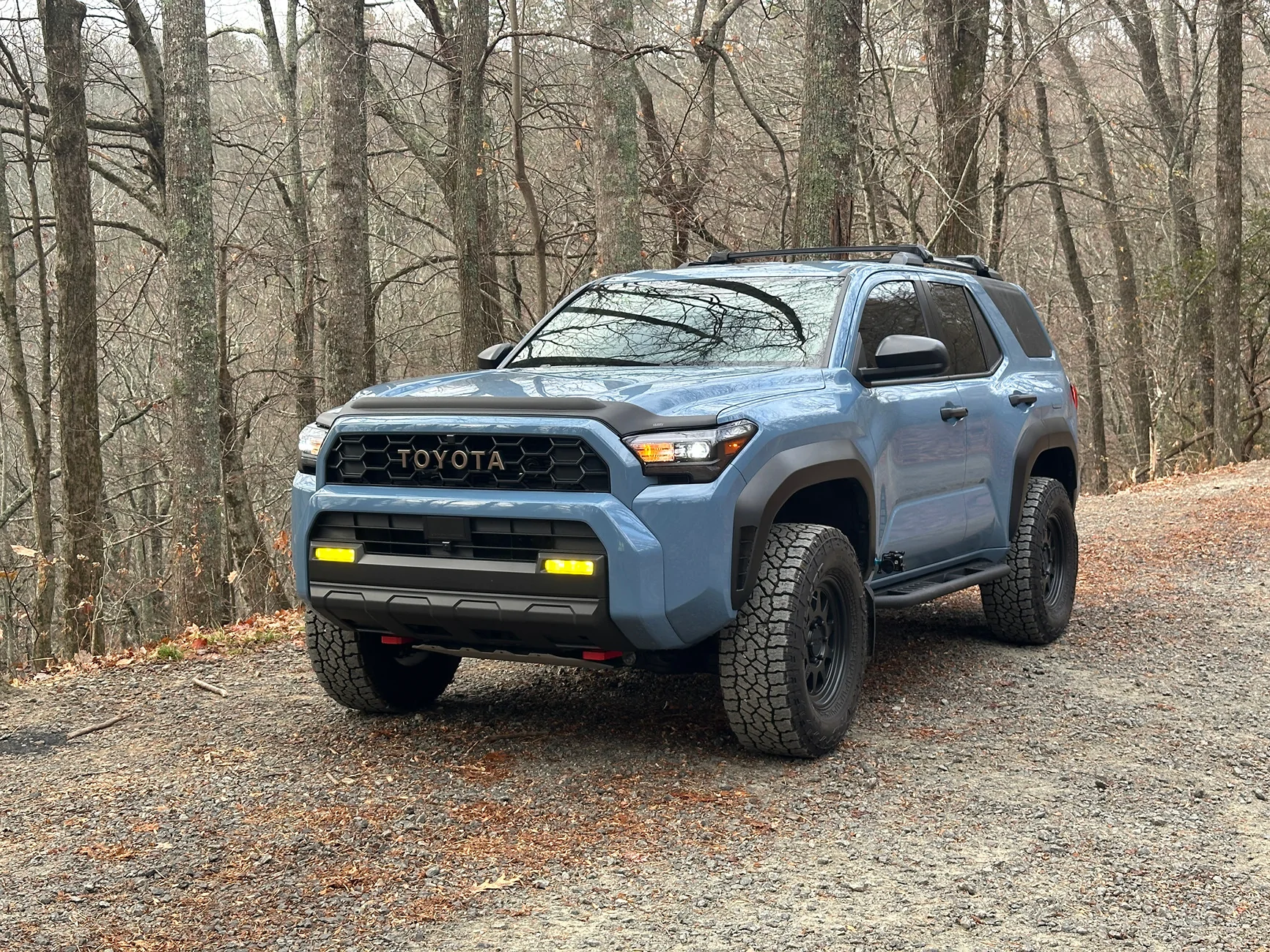

Same. I have been running this lift for maybe 2 months and love it. Went on a 6 hour trip from Southern California to Monterey California and it was great and comfortable. Just recently got new wheels too. I went with the lock off road Mojave 17x8.5 +25mm on Yokohama 285/70/17
