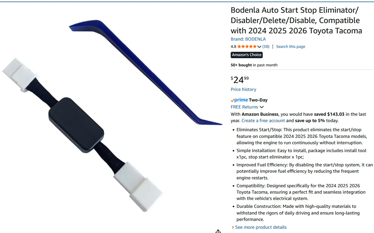

Thanks for posting. The reason I want to keep the engine running is that the start/stop is too clunky. It drives me nuts in traffic. I’ve tried the “shift to manual and leave er in 8” and it works well. Tow/Haul works well, too. I’m looking into one of the plug in bypass options as well.

agreed, it is a very clunky transition, let us know if you are able to find a plugin bypass option, IMHO that would be the best!
