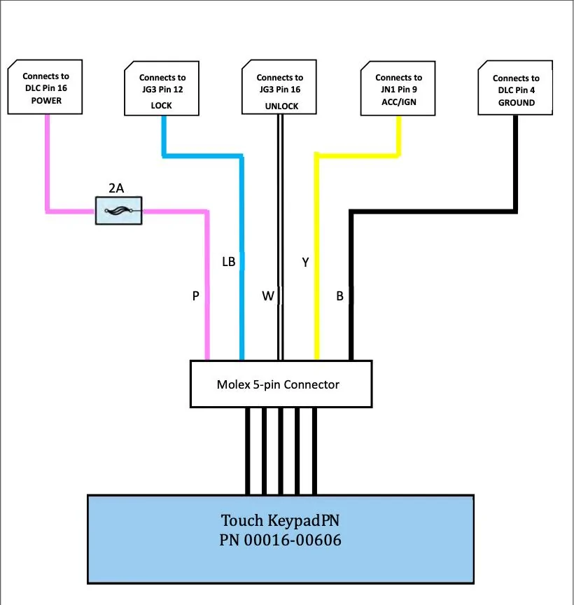

Hoping someone with more technical knowledge of Toyota's electrical systems can help me out and check my math on this. Or, may see an easier way to accomplish this.
I've been doing some research and have decided to get one to see if i can get it to work. I've been pouring thru the wiring diagrams on techinfo trying to compare the 25 4runner to the 24 4runner and even the 24 rav4 (since they mostly have the same tech). Here's what i have so far.

2024 Rav4
From Front Door with motor lock assembly LH
Connector JG3: Pin 12 / Lock / LG (Light Green)
Pin 16 / Unlock / G (grey)
From Outer Mirror Switch Assembly
Connector JN1: Pin 9 / Ignition / LG (Light Green)
Connector DLC: Comes with a premade jumper for power from pins 4 & 16

The outer mirror switch assembly is different on the 2025 so i'm searching for a place to pick up an ACC/Ignition wire.
Wire diagram for the touch keypad
