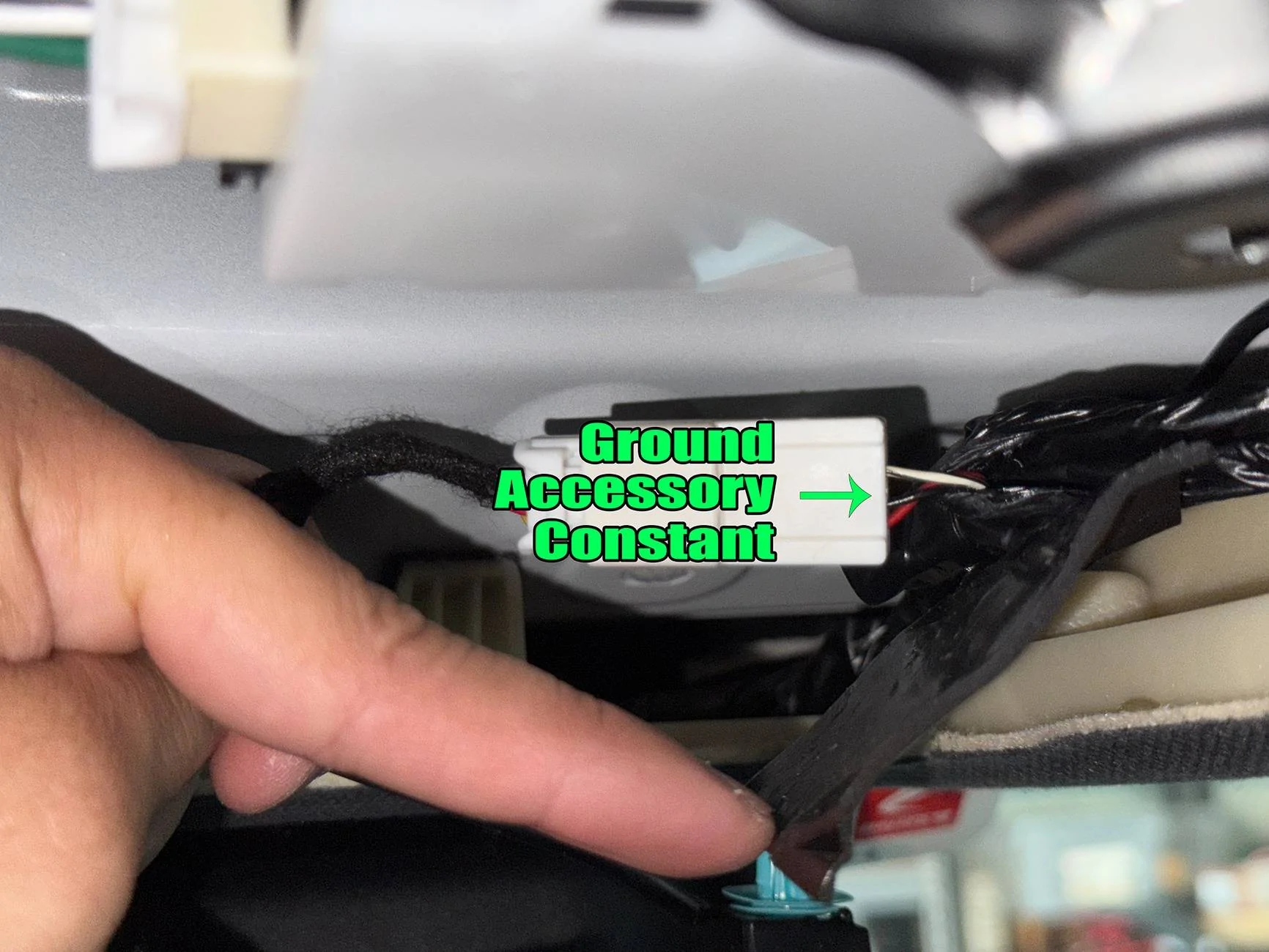

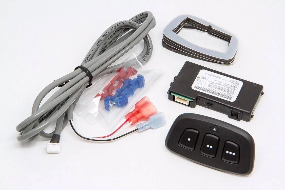

I've been contemplating installing on of these units on my Land Cruiser (removed OEM mirror that had Homelink and replaced with Wolfbox) and my SR5 4Runner (also has a digital mirror so no integrated option there).
https://amzn.to/442B2XX
It's pretty easy to wire up with these modern Toyotas due to the accessory power wire in the headliner. This 5 pin harness actually only has 3 wires pin use. The wire that is by itself is the ground, the wire in the middle is accessory power, and the wire on the outside is constant power. Of course if you are worried about people getting inside your garage, just wire it to accessory power.
It can be mounted on top of any plastic trim or the headliner.

I’d like to see a video. I’m struggling to get constant power from the 5pin connector. I was thinking it was my trim, but if you got it to work, maybe it’s something I need to talk to the dealer about.
