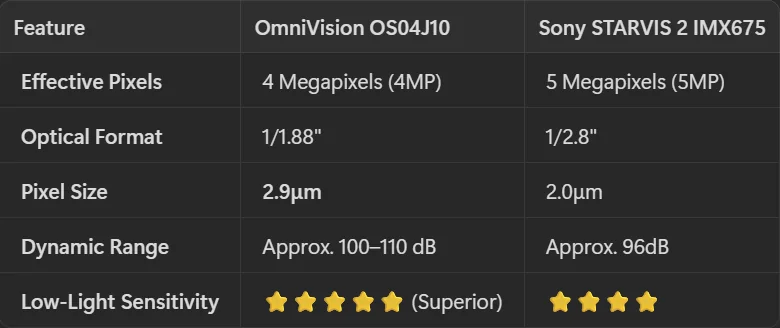

Here is a quick summary of the core specifications:
2025 2026 4runner 6th gen Sensor Showdown: Sony STARVIS 2 IMX675 vs. OmniVision OS04J10 - The Low-Light King? core specs
The Critical Factor: Pixel Size
While the IMX675 boasts a higher 5MP resolution, the analysis points to the OmniVision OS04J10's significantly larger pixel size (2.9μm vs. 2.0μm) as the key differentiator for dash cam performance.
Think of each pixel as a container collecting light (photons). In low-light conditions, the size of the container (pixel size) is more important than the total number of containers (total pixels). The larger 2.9μm pixels on the OS04J10 can capture more photons per unit of time, leading to three major advantages:
1.Brighter Images: For the same exposure time, the OS04J10 achieves a higher signal strength.
2.Reduced Motion Blur: To achieve the same brightness, the OS04J10 can use a shorter exposure time, which helps freeze motion and reduce blur from moving vehicles or your own speed.
3.Superior Signal-to-Noise Ratio (SNR): More signal and less noise means a cleaner image, especially in shadow areas. This is crucial for identifying details in dark corners of a parking garage or restoring license plate information in backlit scenarios (like a car with bright headlights).
The article suggests that the OS04J10's design prioritizes light sensitivity and dynamic range (up to 110 dB) over raw pixel count, making it a potentially superior choice for the challenging, high-contrast, and low-light environments typical of dash cam use.
