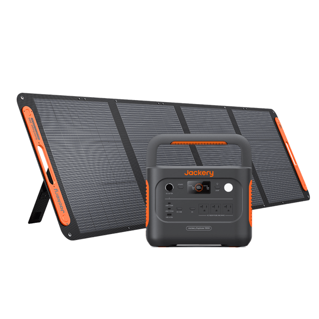

I remember someone posting that the output of the AC outlet was a non pure sine wave and that most power banks need clean power. I'm looking to be off grid up to 4 days at a time and will hopefully be picking up a starlink mini so will probably need to recharge and don't want to rely just on the solar panels. If anyone has a tips I'd love to hear them. The Jackery supports cigaret outlet charger but that takes 12 hrs. Normal wall outlet charge is like 1.5hrs to get full charge.
Thanks
2025 4runner 6th gen Looking to charge Jackery 1000 v2  in non hybrid jackery-solar-generator-1000-v2-6821809_650x

Your best bet probably to get an alternator DC-DC charger like Ecoflow or Bluetti That can have up to 800W (with the engine running) to charge your Jackery (if it can take it.)
