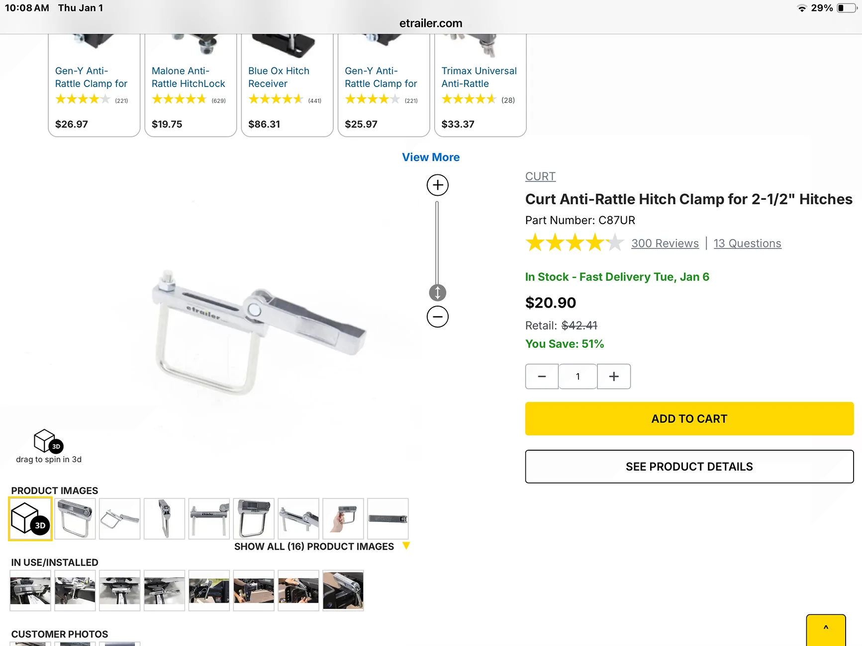

The hitch receiver on the new 4Runner is different and I’m wondering if a regular anti-rattle clamp will fit. Anyone as suggestions?

if the anti rattle clip straddles the attachment, with a u-bolt
and a plate... it'll work
if the anti rattle clip goes inside the attachment, and uses a threaded bolt,
you might need a longer bolt since the receiver on 4runner is extra-wide

Thanks, will go with u-bolt and plate style
