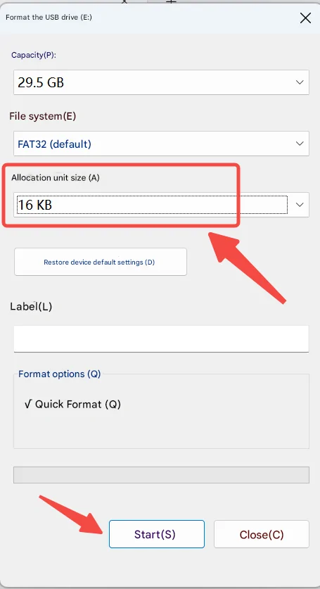

2. Prepare a 32GB memory card, connect it to your computer via a card reader, and format it to 16KB as shown in the attached image (Note: When formatting, select the FAT32 file system and set the allocation unit size to 16KB);
2025 2026 4runner 6th gen Firmware Upgrade Went Sideways? How To Unbrick Your Dash Cam G900 Tripro? Guide Here! 4e1d8748-7e4d-409f-a334-428266ee3e7f

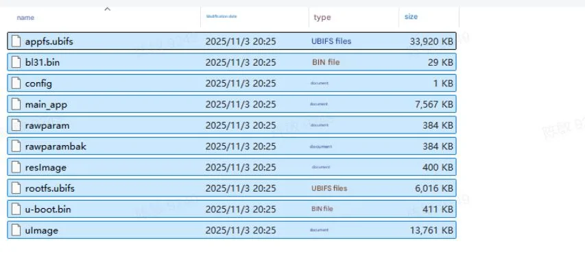

3. Keep the memory card connected to the computer (or reconnect it via a card reader), and copy all downloaded firmware files to the memory card. Refer to the attached image for instructions;
2025 2026 4runner 6th gen Firmware Upgrade Went Sideways? How To Unbrick Your Dash Cam G900 Tripro? Guide Here! 1c7669d8-cf7d-4c5d-9d50-f289877a6ae2
