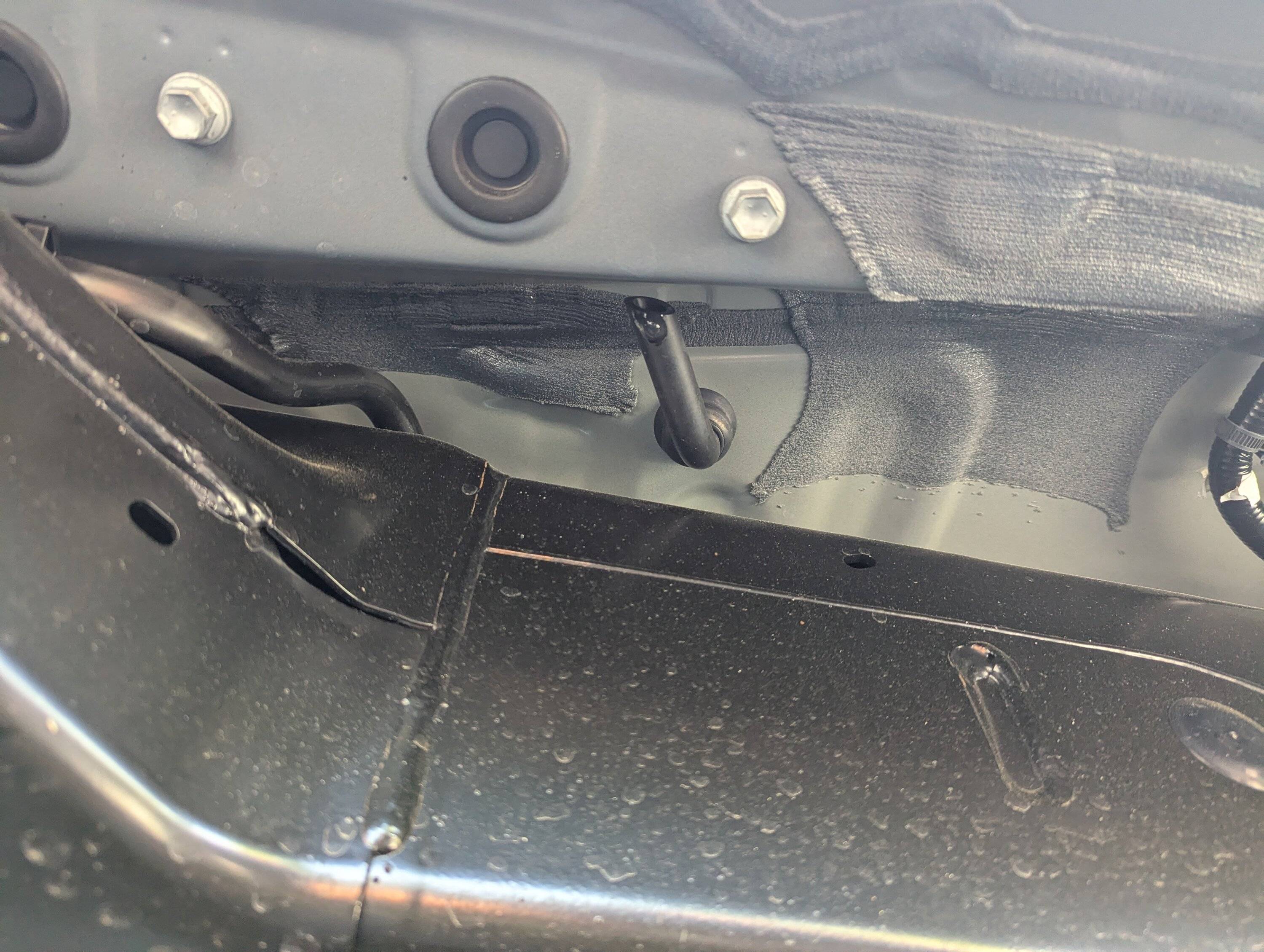

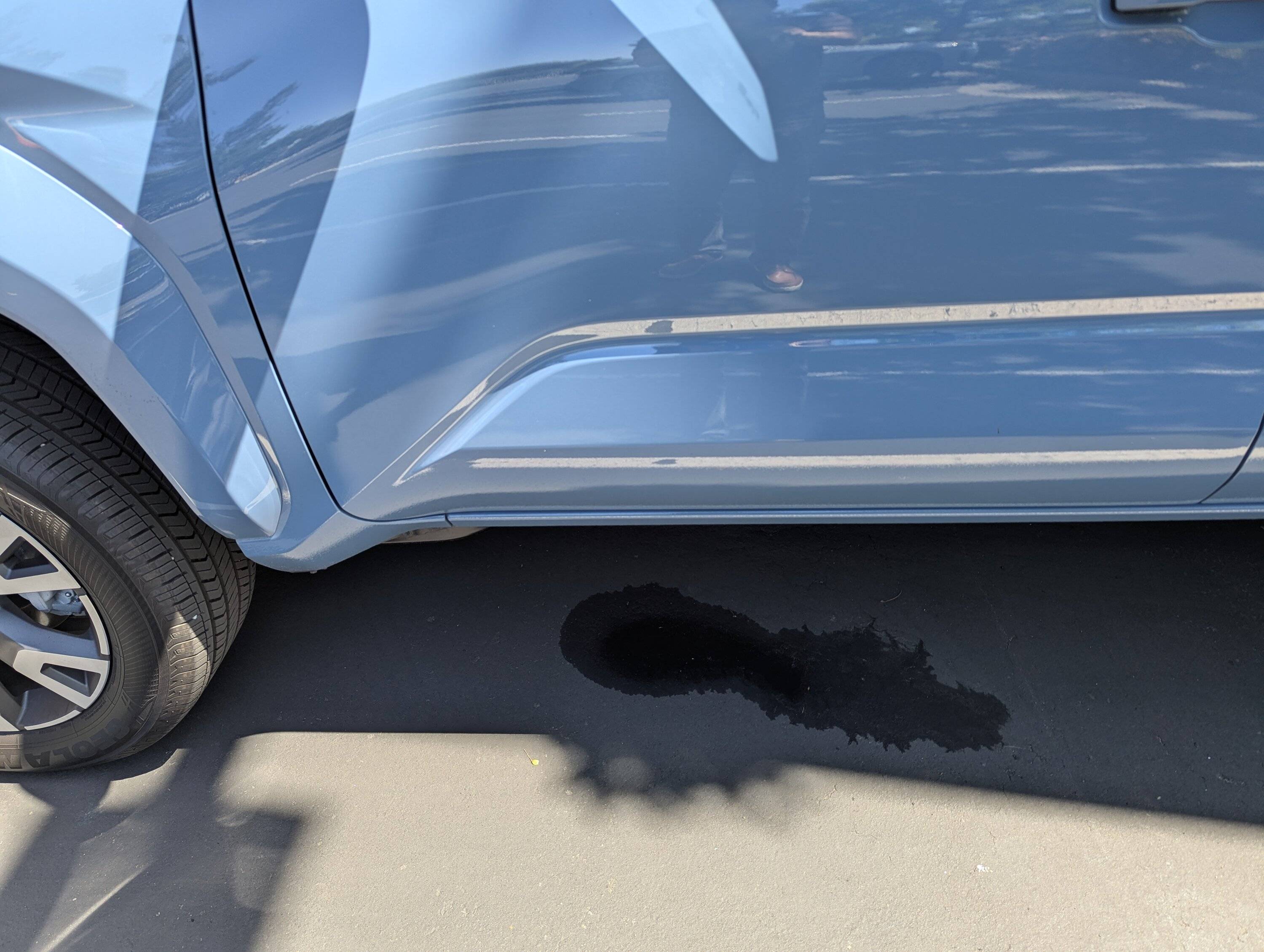

Noticed a puddle under the driver side so checked under and it looks like a drip hose. Is it for the AC condensation ?

looks like it. I think I remember seeing it in TCCN's tacoma or LC review, don't remember. Smart to not have it just gushing onto the frame

Could be sunroof drain. A/C is typically on passenger side.

Definitely looks like a A/C drain, in pictures the A/C lines go in the firewall on the driver's side. This seems to be the same on all the vehicles built on the TNGA-F platform.

I thought that might be it, but I found the TCCN LC1958 review again and he implied both left and right drains are A/C. Makes sense as that video 1958 vehicle had no sunroof. The whole hose drain looks pretty much identical on left and right side, locations too, 90 degree bend outwards to just clear the frame.
