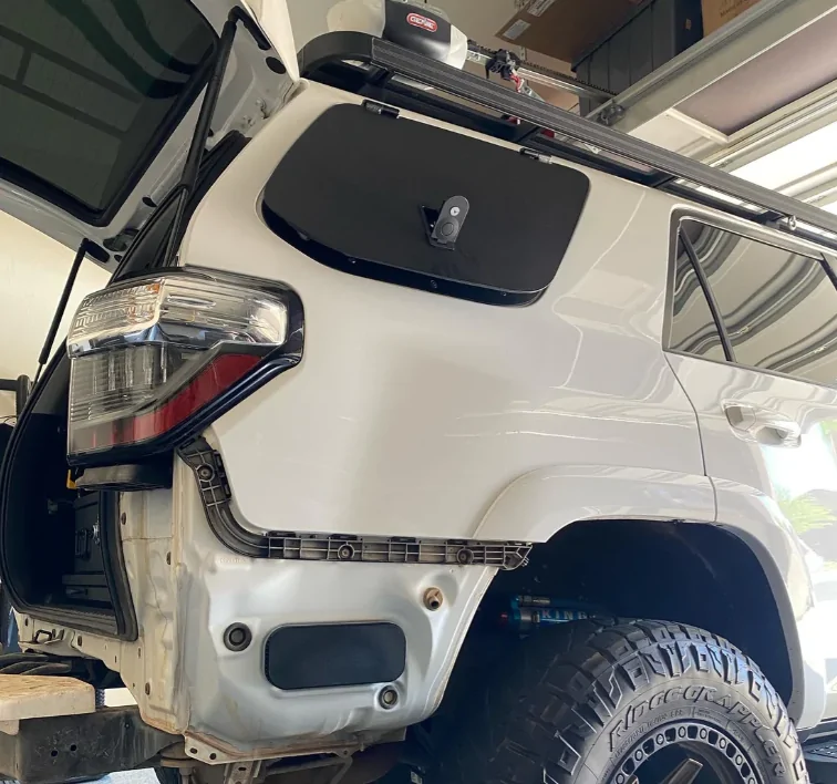

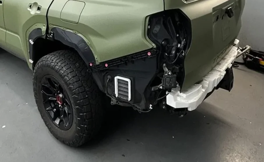

cabin pressure vent is called quarter panel vent and is located
under the rear bumper
Looking up behind the rear bumper cover.
Pulling back the inner fender liner in the rear.
I don't have a 2025 pic but here is where 5th gen has it
and it's gonna be similar for 2025
2025 2026 4runner 6th gen Cabin pressure relief (outflow) vents? 1762524506152-qd
