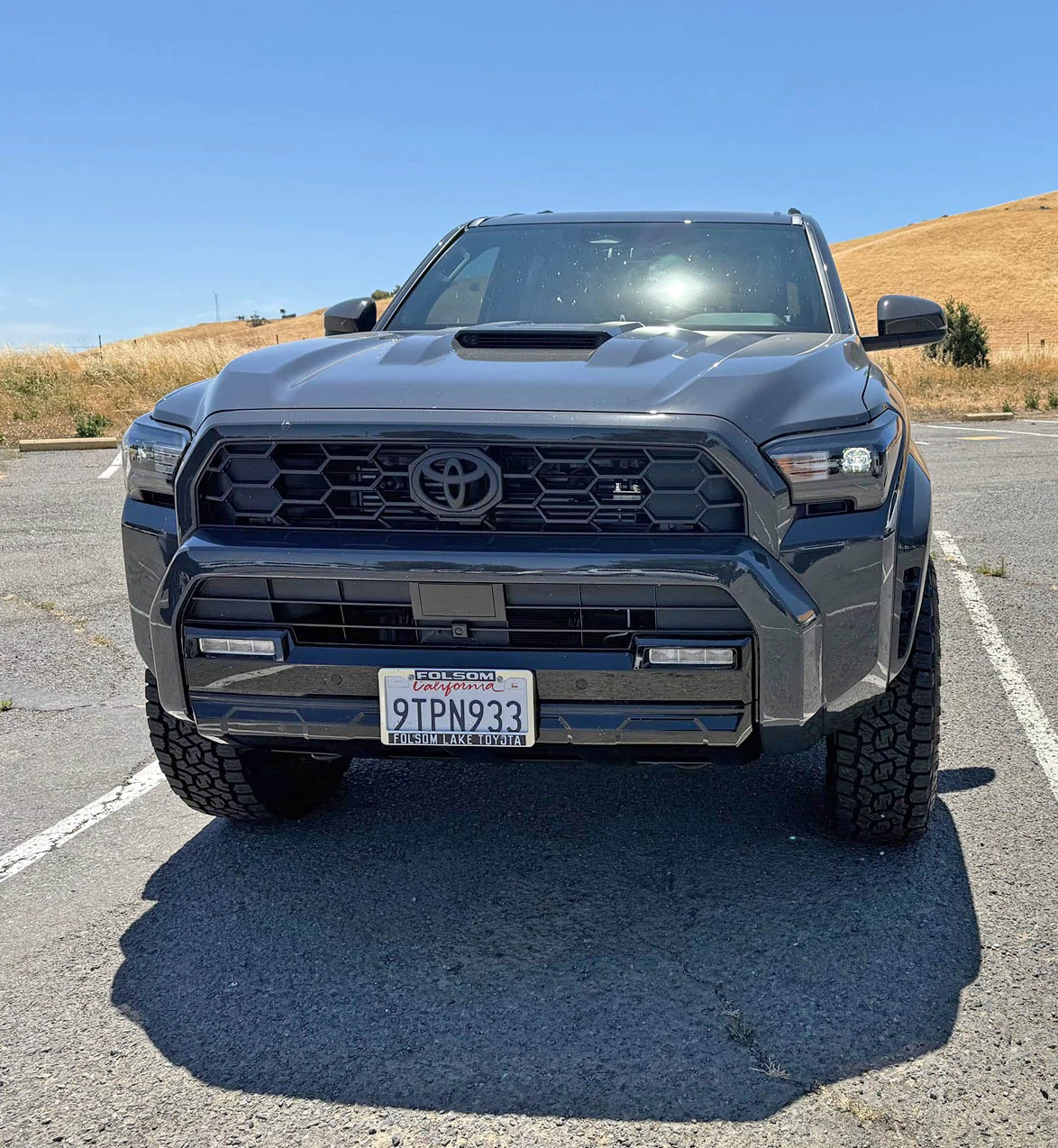

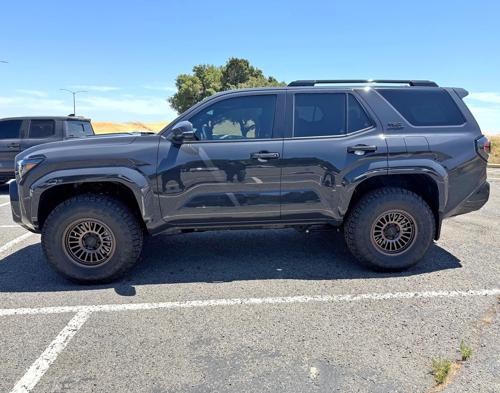

Westcot lift kit
RRW RG6-s 17x8.5 +25 offset wheels
Toyo Open Country AT3 285/70/17
Had to remove the OEM front mud flaps
How is the ride quality for daily driving? I have that lift in hand and getting it installed in a month.

My commute to work is a hr each way. It’s not bad.
My commute to work is a hr each way. It’s not bad. Gas millage went down from 20 to 15 at 73 cruise and 17 at 70mph on cruise
