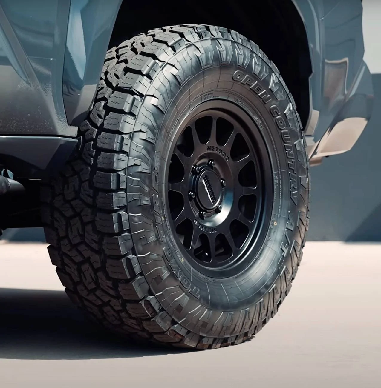

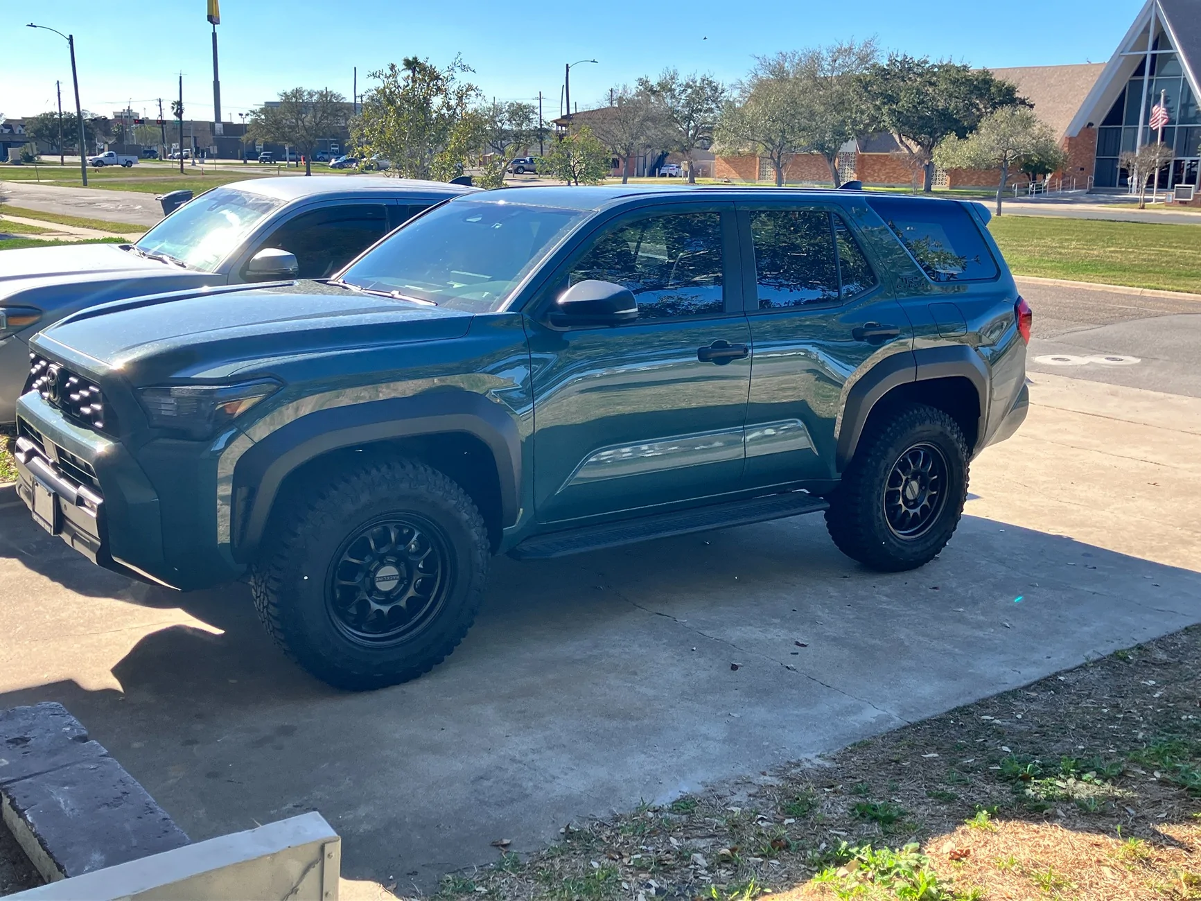

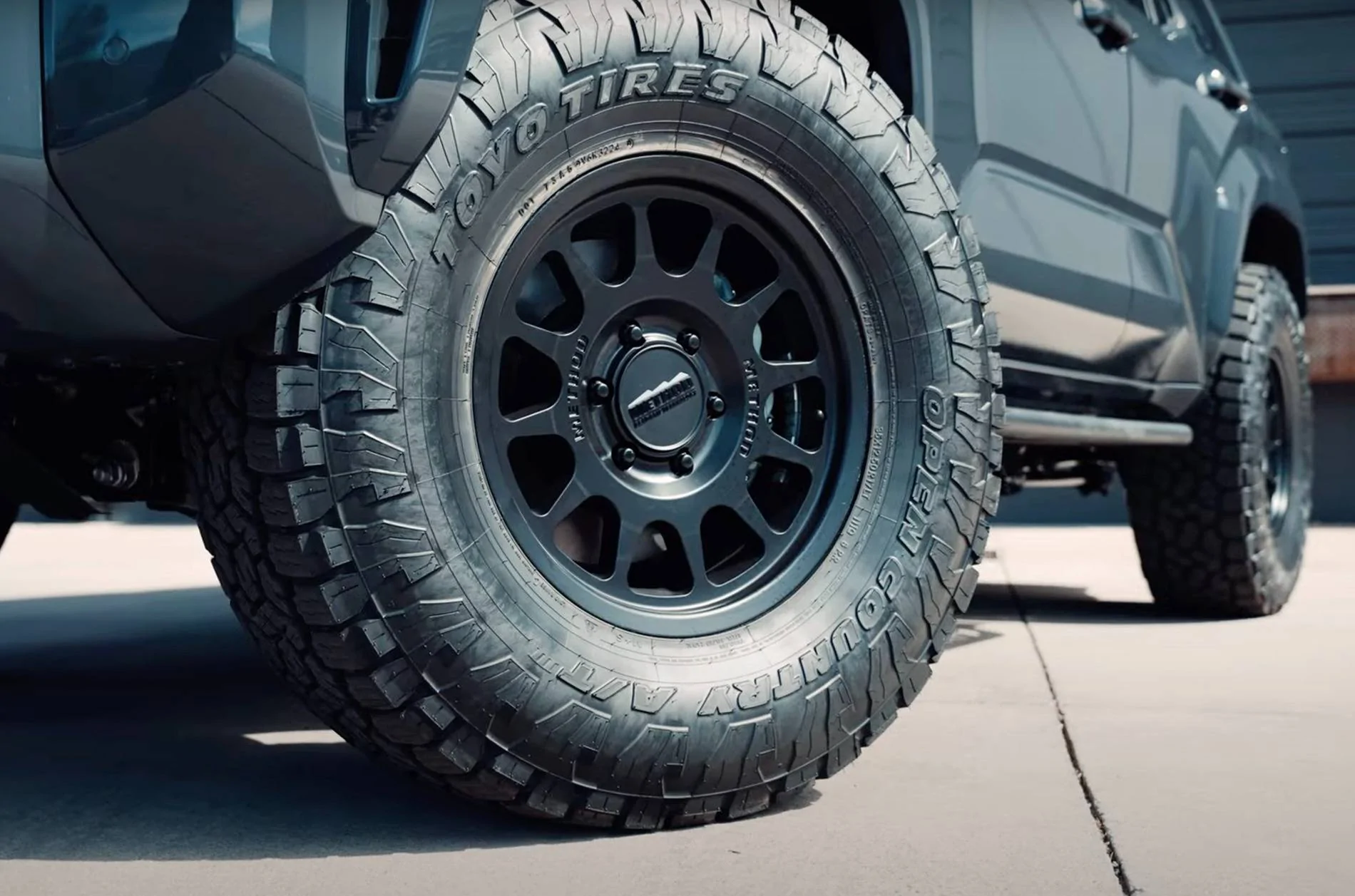

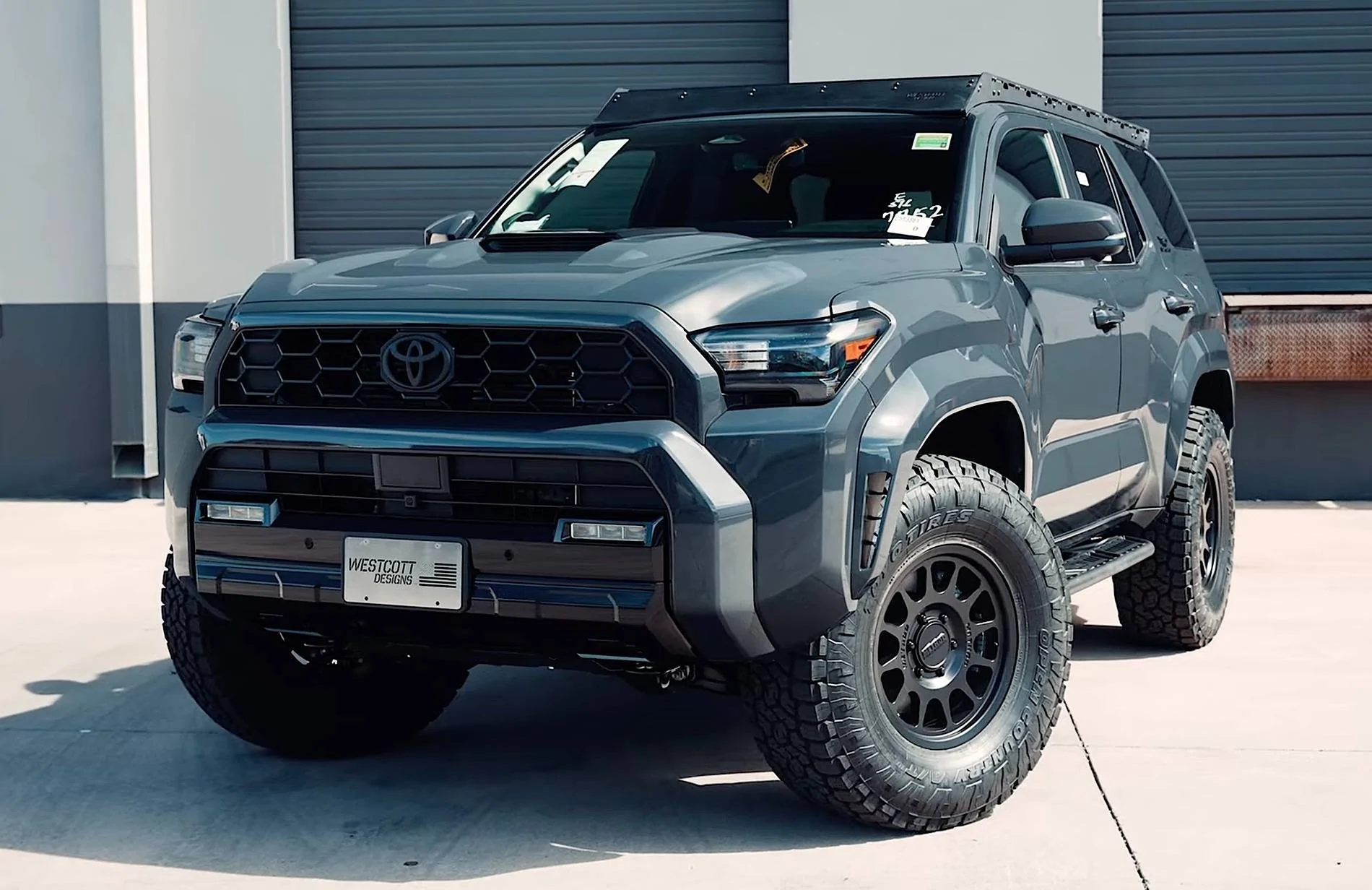

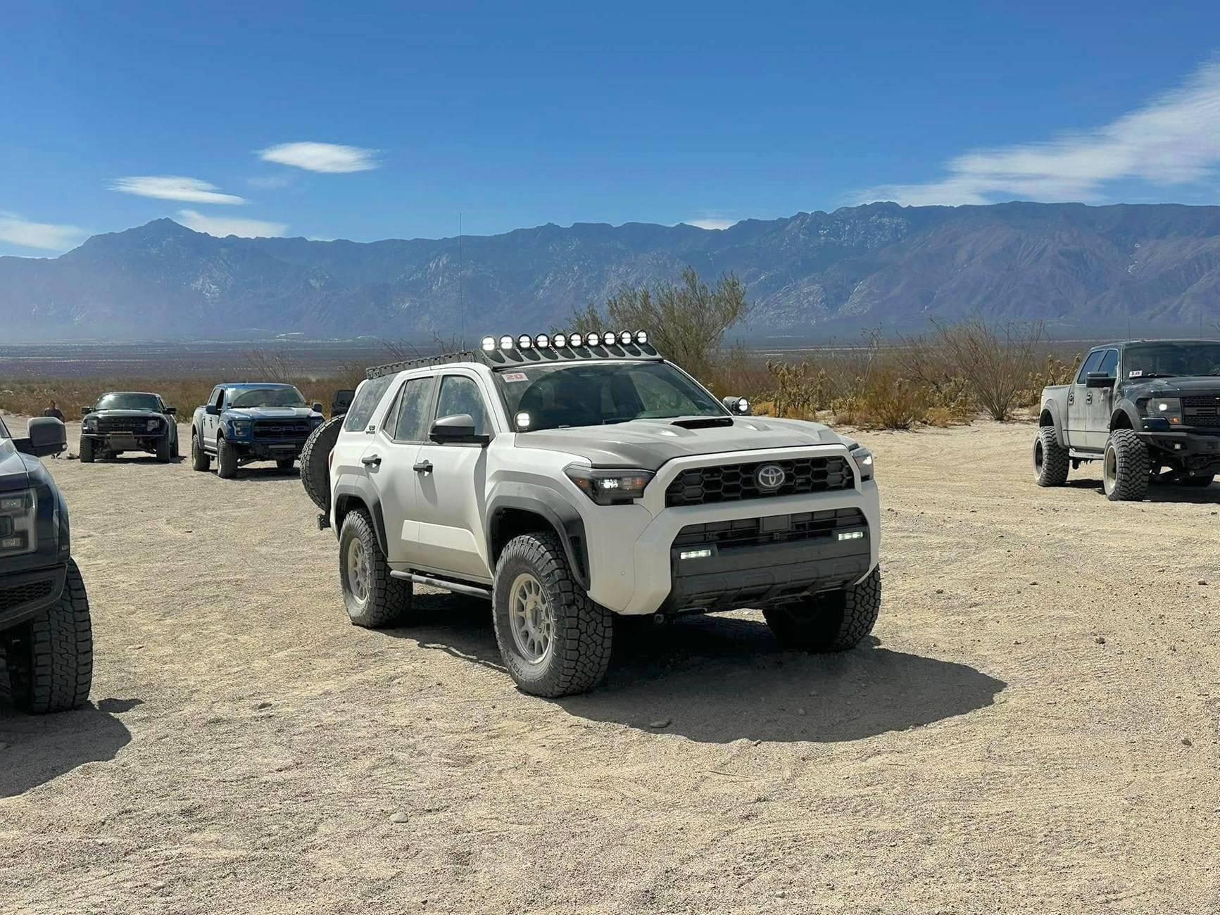

Here's a place to post pics of +35 mm offset wheels.
Method 703 wheels (17x8 +35 offset).
Toyo Open Country AT3 35x12.5R17 tires.

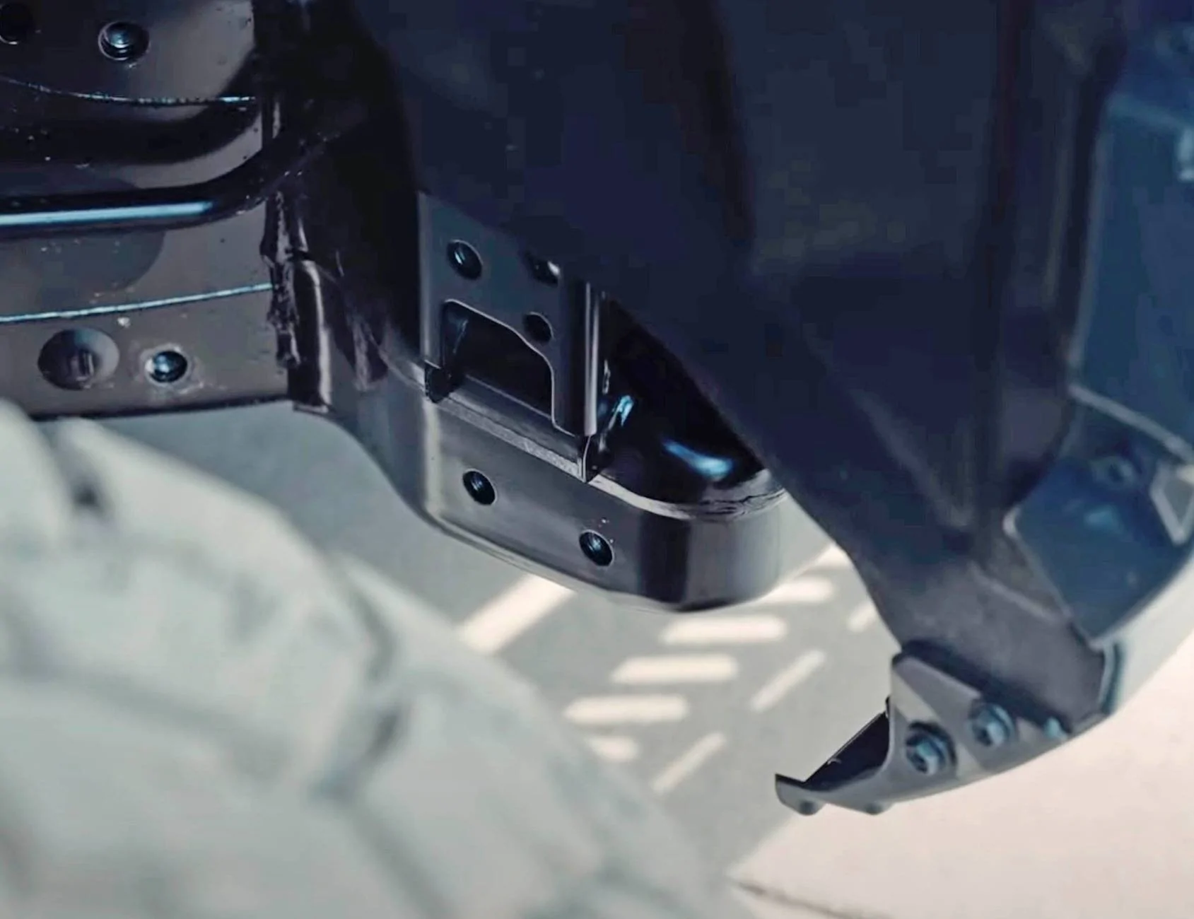

From this thread:
https://www.4runner6g.com/forum/thr...iders-low-profile-roof-rack-molle-panel.2449/

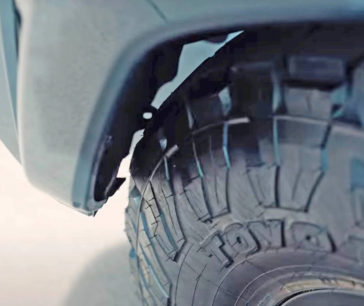

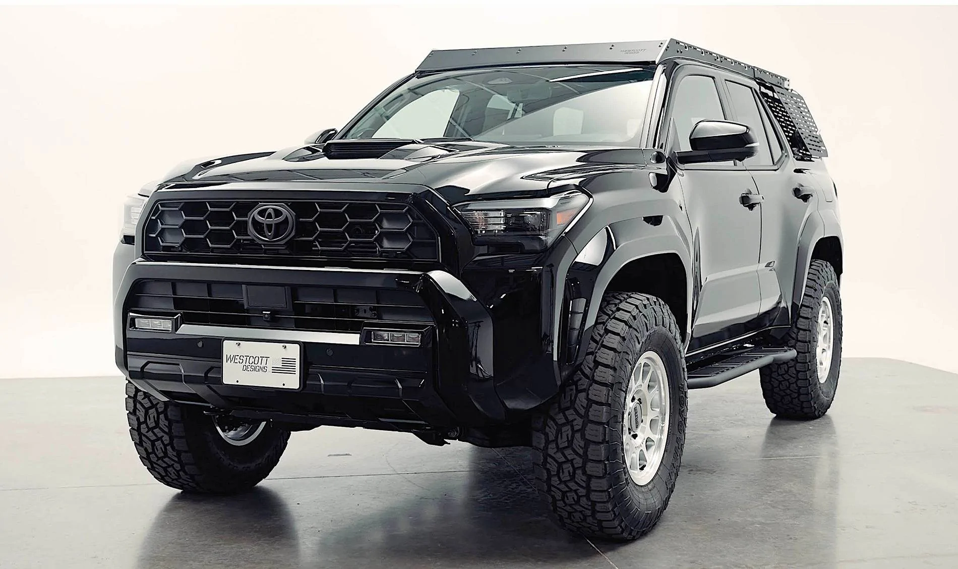

17" Method 703 wheels +35 offset
Preload collar lift with 0.5" top shim (lifts height 2.25" inches)
- Fender liner moved forward for extra clearance (to avoid tire rub at full steering lock)
- Removed carpet covered piece at back of front fender (to avoid tire rub at full steering lock)
Toyo Open Country A/T3 tires (35x12.50R17)

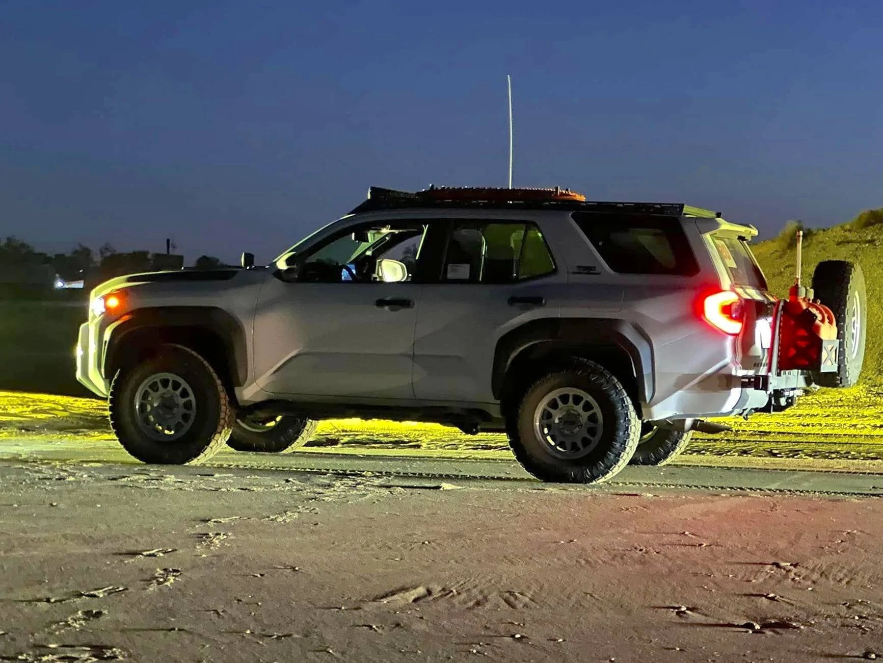

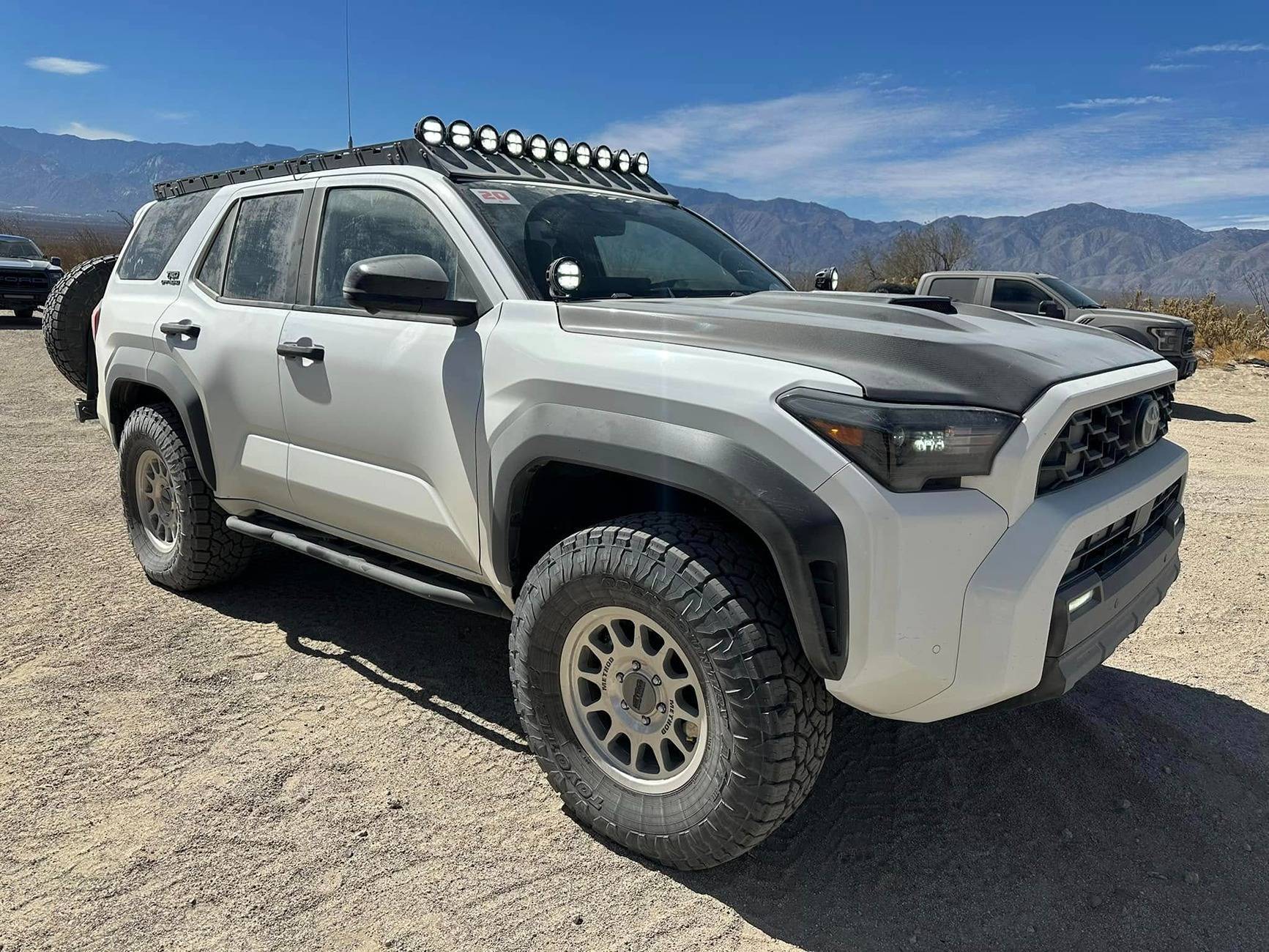

I joined the +35 club. Fretted over +25 or +35. For a while. I didn’t want the thread to stick out because I’m driving dirt road daily. The thread of front and rear tire line up with the inside lip of the plastic fender. The budge sticks out past the fender. I tried to show it on the last pictures because that what I was trying to see when scouring the internet. I’m happy with the outcome.
Here’s the details.
TRD ORP stock height
Raceline Rogue 17x8.5 +35 offset
Toyo at3 sl 285/70r17
