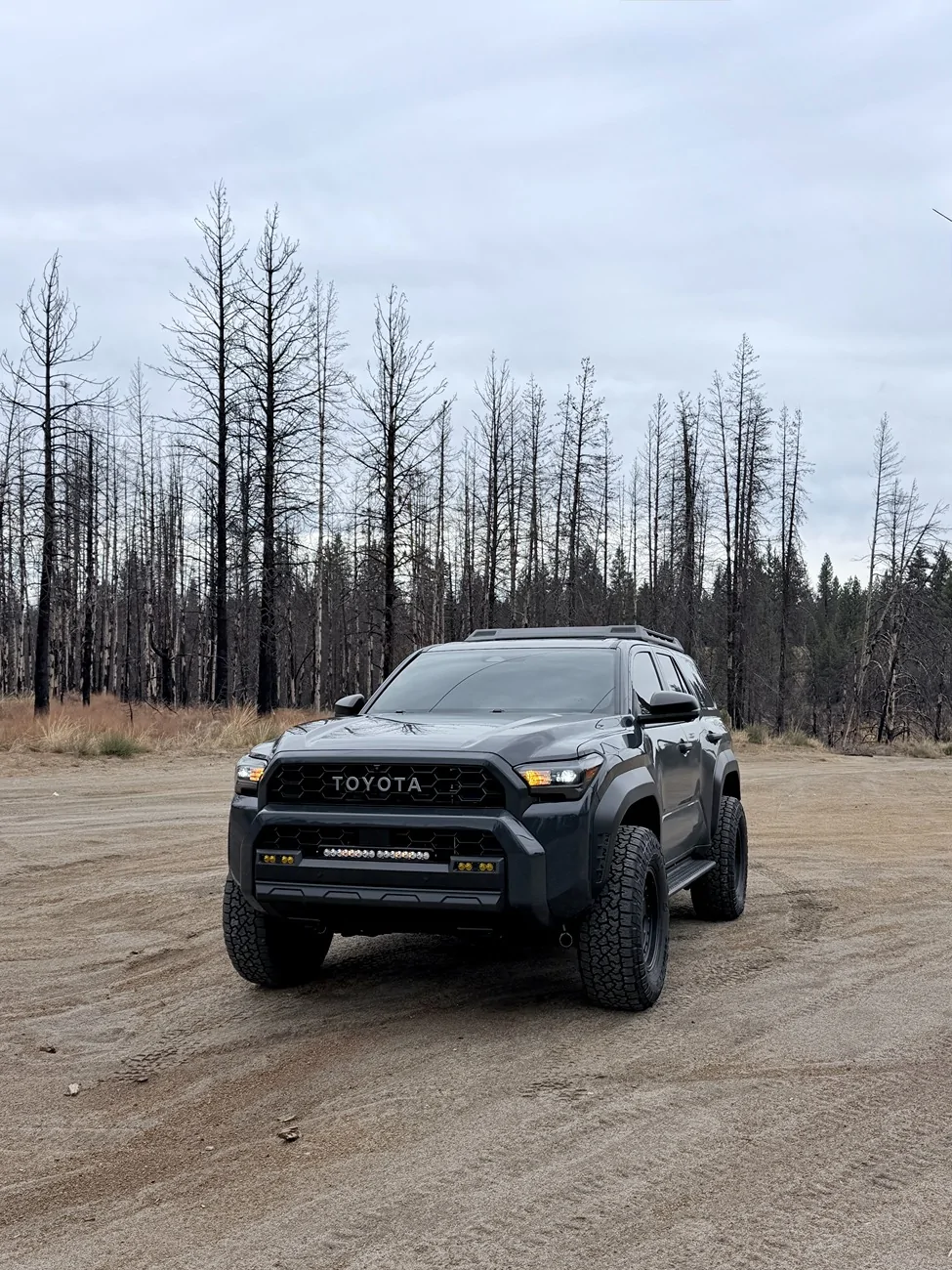

I am currently planning to install the BD fog pocket brackets.
Because I’m extra, I will be wiring:
-Pair S2 Sports to the factory fog wires.
-Pair S2 Pros to AUX4
-And when I get brackets, ditch light position Squadron Sports to AUX3
To make the set up easier to service, I will be using the BD 2 pin connectors on the LO pigtail. I cannot think of what to use for the AUX5 (on with car) connection.
I will try to post pictures of the brackets with the lights installed.
I really only want to pull off the front bumper once so any tips on how to orient the lights onto the fog adapter bracket are welcome.
How have you aligned the lights?

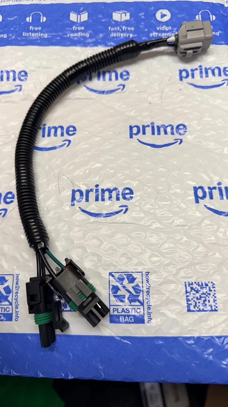

LO AUX pigtail now set up for install.
I thankfully had a lot of leftover plugs allowing me to pin the correct leads.
The AUX5 wire was just folded and hidden in that plastic conduit stuff.
Had to solder a split on the ground wire.
