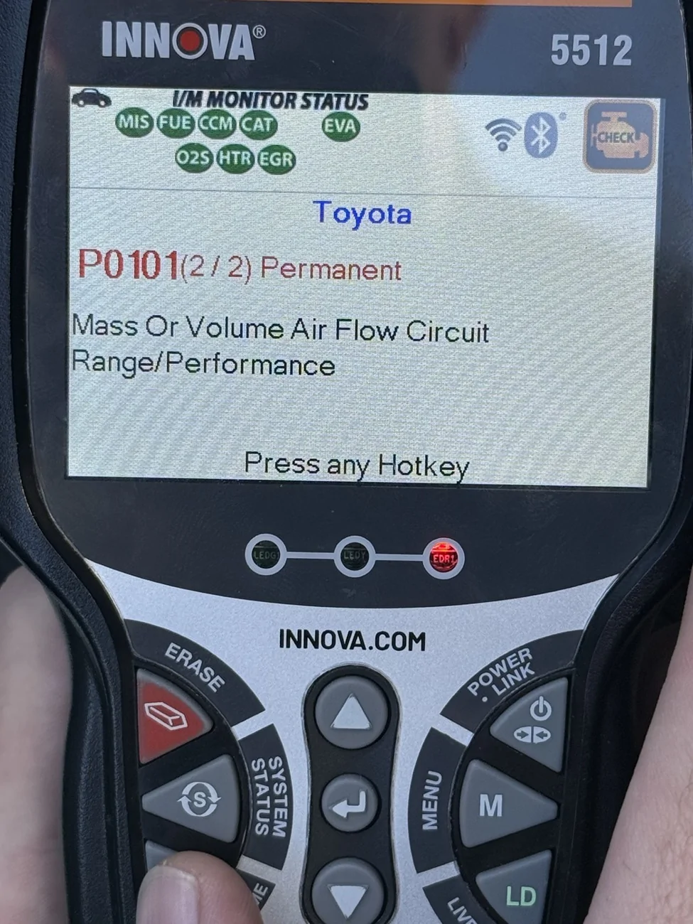

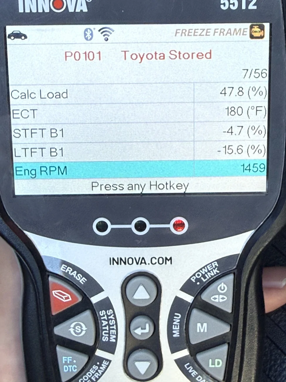

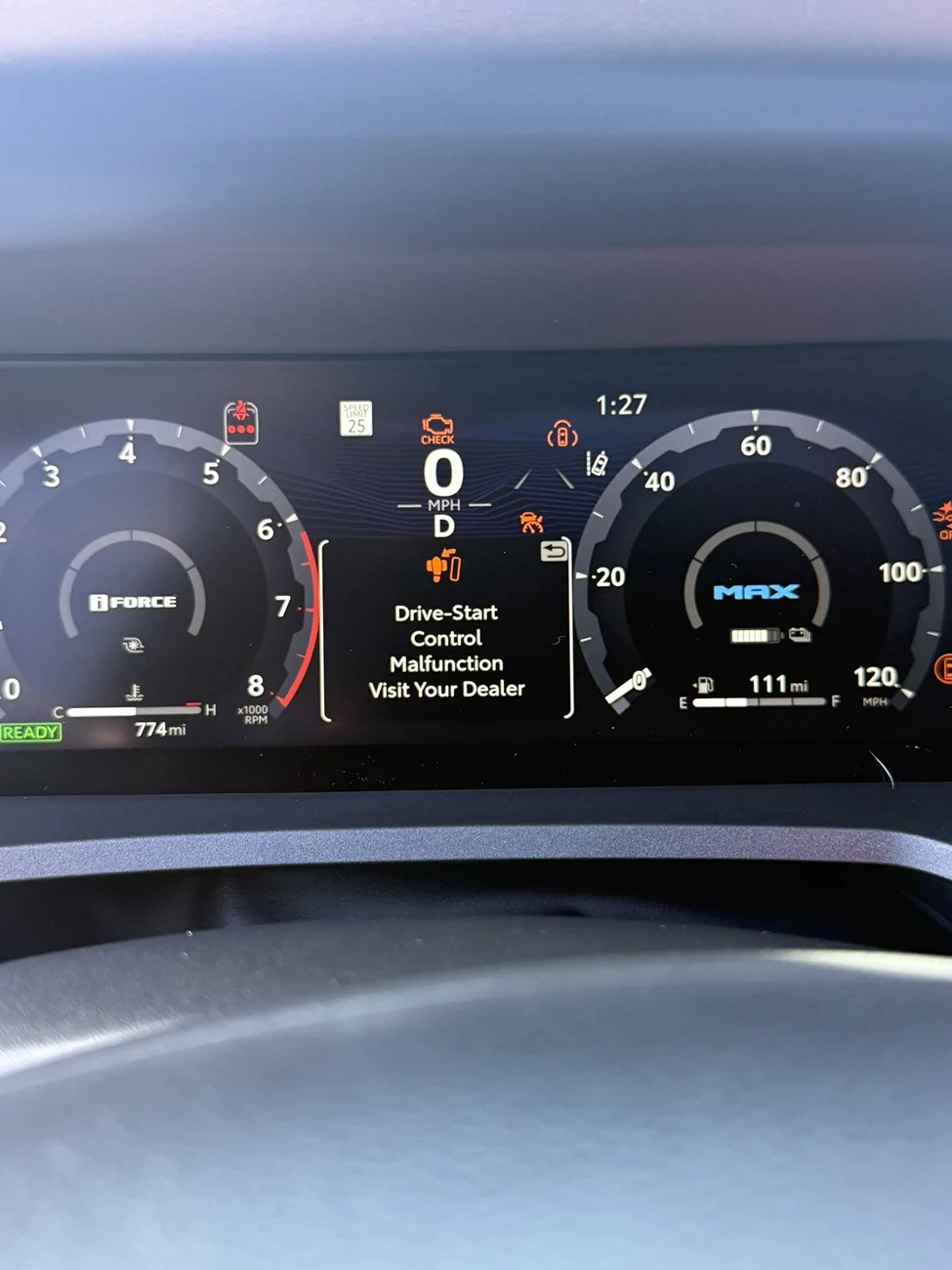

Hi Guys,
Anyone have any issues after installing the cold air intake from 6th Element? I am getting a ton of error "Mass Airflow Sensor" popping up on the diagnostic test when I hook it up which is making every warning flash on my dash and putting car in "limp" mode. The tech said its needs to be tuned, given there is so much air now passing through the sensor, but not sure if that is correct.
Any help is much appreciated.

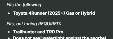

If you have a pro, it needs a tune (looks like you have a Pro). If you don't, it should not cause a code without a tune. The tech explanation is a poor one because it does not bring any more air in at idle than the factory intake does. However, if the diameter of a tube is larger or smaller, it will skew how the ECU interprets the data from the mass airflow sensor. This causes high or low fuel trims and can result in a check engine light. In the case of a Pro, the factory diameter is larger than the one on the SXTH intake, so the same amount of air reads as higher airflow to the ECU through the smaller diameter. The ECU sees that additional air and adds fuel to accommodate it. This results in a rich air-fuel ratio in the exhaust, and the O2 sensor then trims the fuel negative, which you see on the scanner. The only way to fix this on a Pro is to tune it, and I have tuned many of them on Pros with that intake. Directly from the SXTH page:
