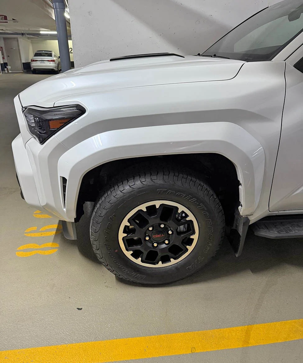

Did you get the 17” Wheels for your 4Runner? Wondering how it went.
I located a set of 17” 2025 Tacoma TRD Off-road wheels for my TRD sport, but looking for some confirmation on brake clearance before I pull the trigger on them.

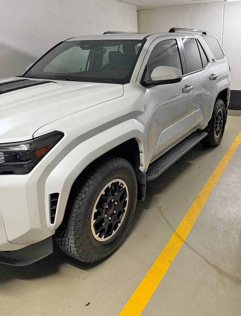

I can confirm the 2025 Tacoma TRD Off Road 17” wheels fit the 2025 4runner. Just put them on my TRD Sport today with 265/70/17 BF Goodrich Trail-Terrain T/A tires.
