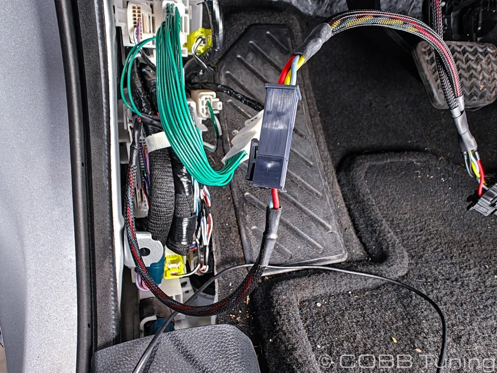

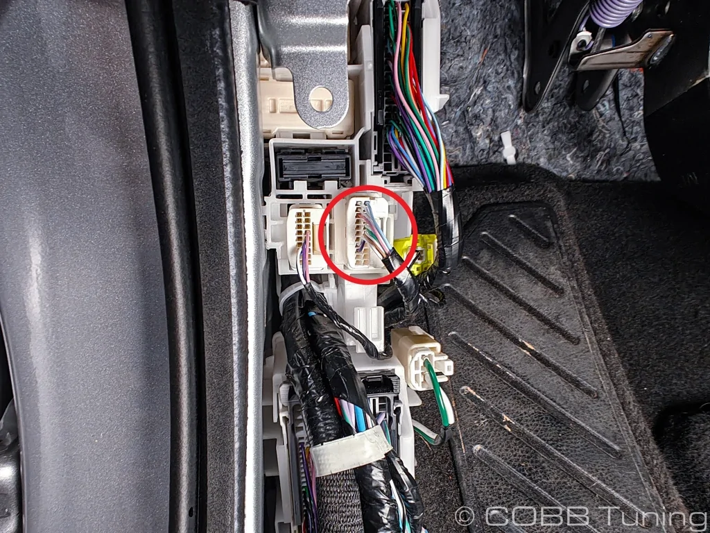

You. Is there a video link for install of harness etc?
CAMTuning
Cam
Nov 14, 2025
134
209
NM
2025 Tacoma TRD OffRoad
that’s great. Rhank
I do not have a video on the 4Runner, but these images from the Cobb install page (https://cobbtuning.atlassian.net/wiki/spaces/PRS/pages/4141940776/Toyota+Bypass+Harness+Installation) are very clear. I have some photos from a customer 4Runner I did recently, but they're not better than these ones. I feel the 4Runner is easier than the Tacoma because the termination block on the Tacoma is a lot harder to get to than this connection.
