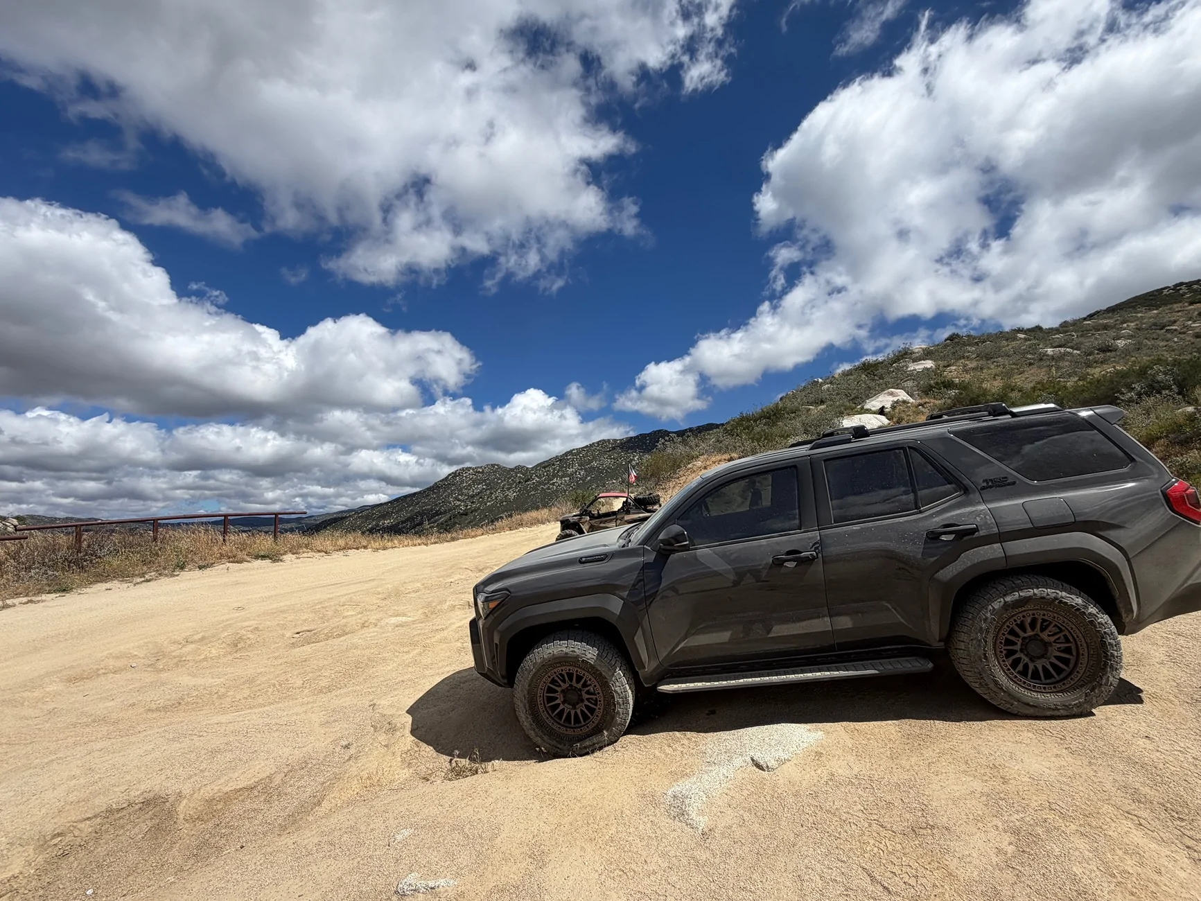

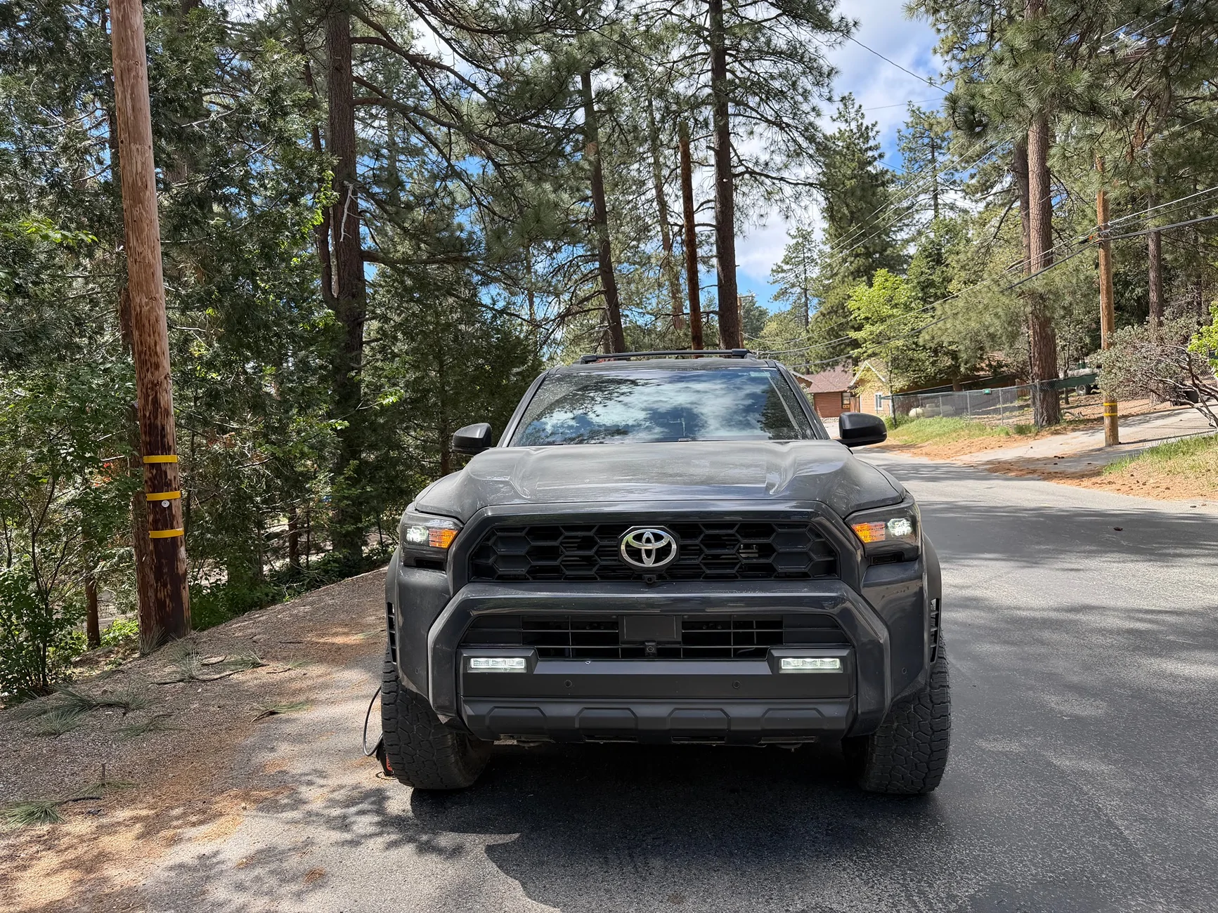

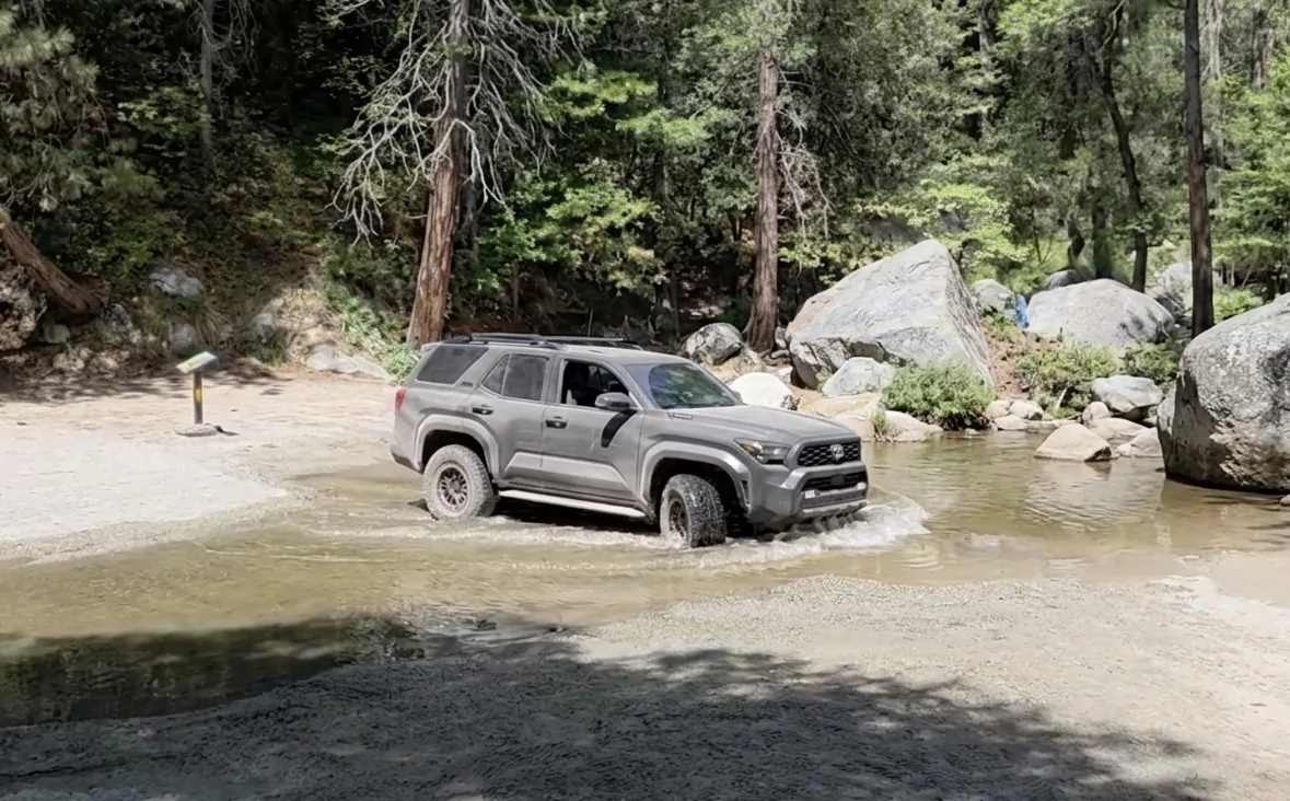

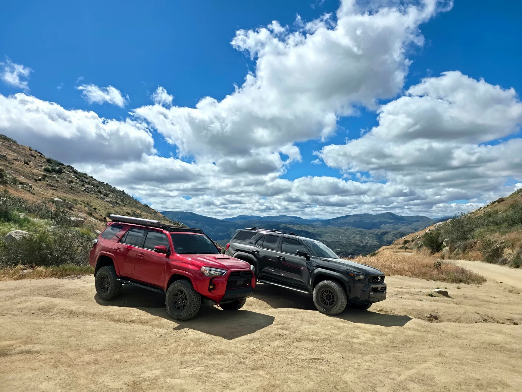

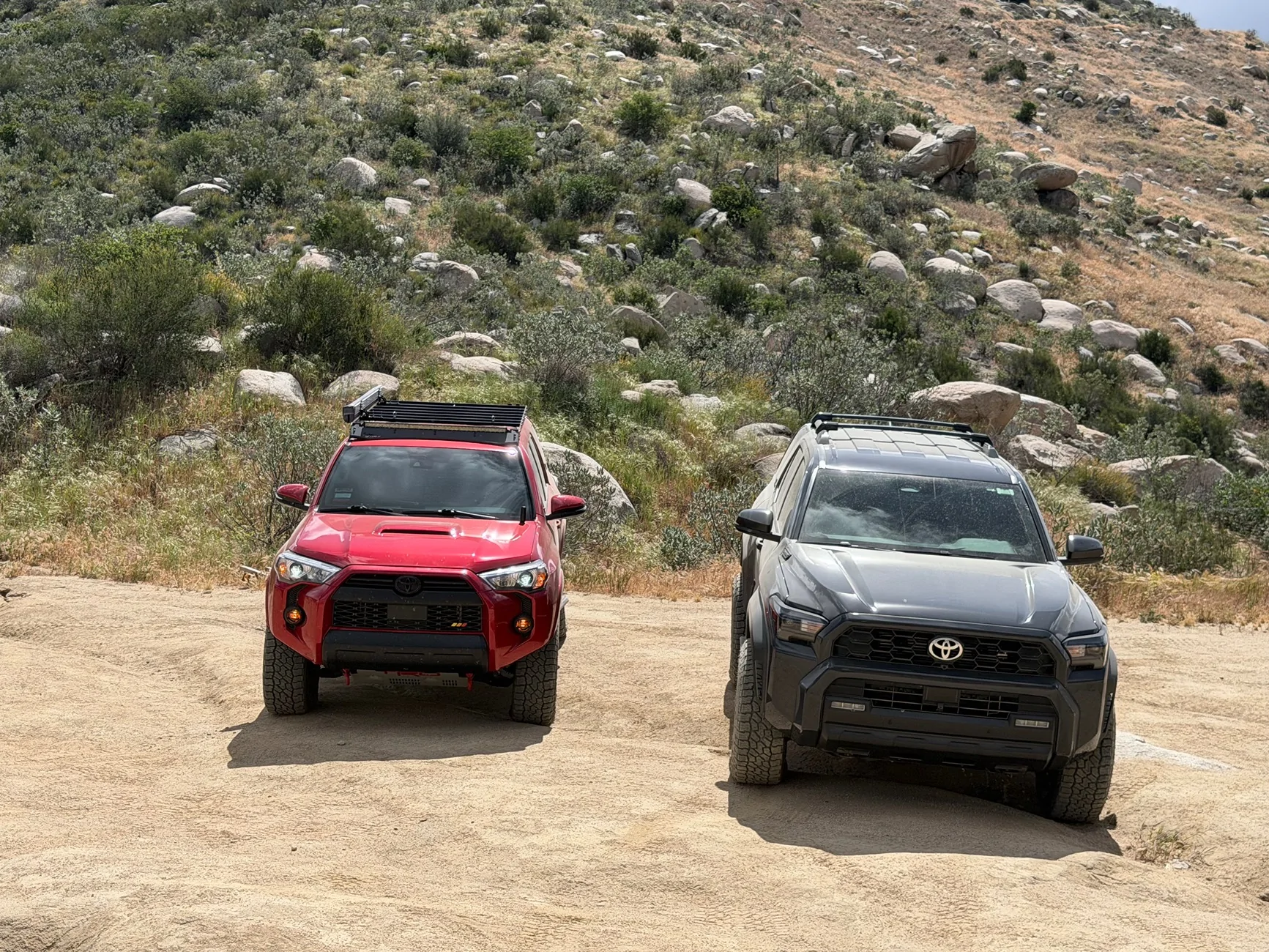

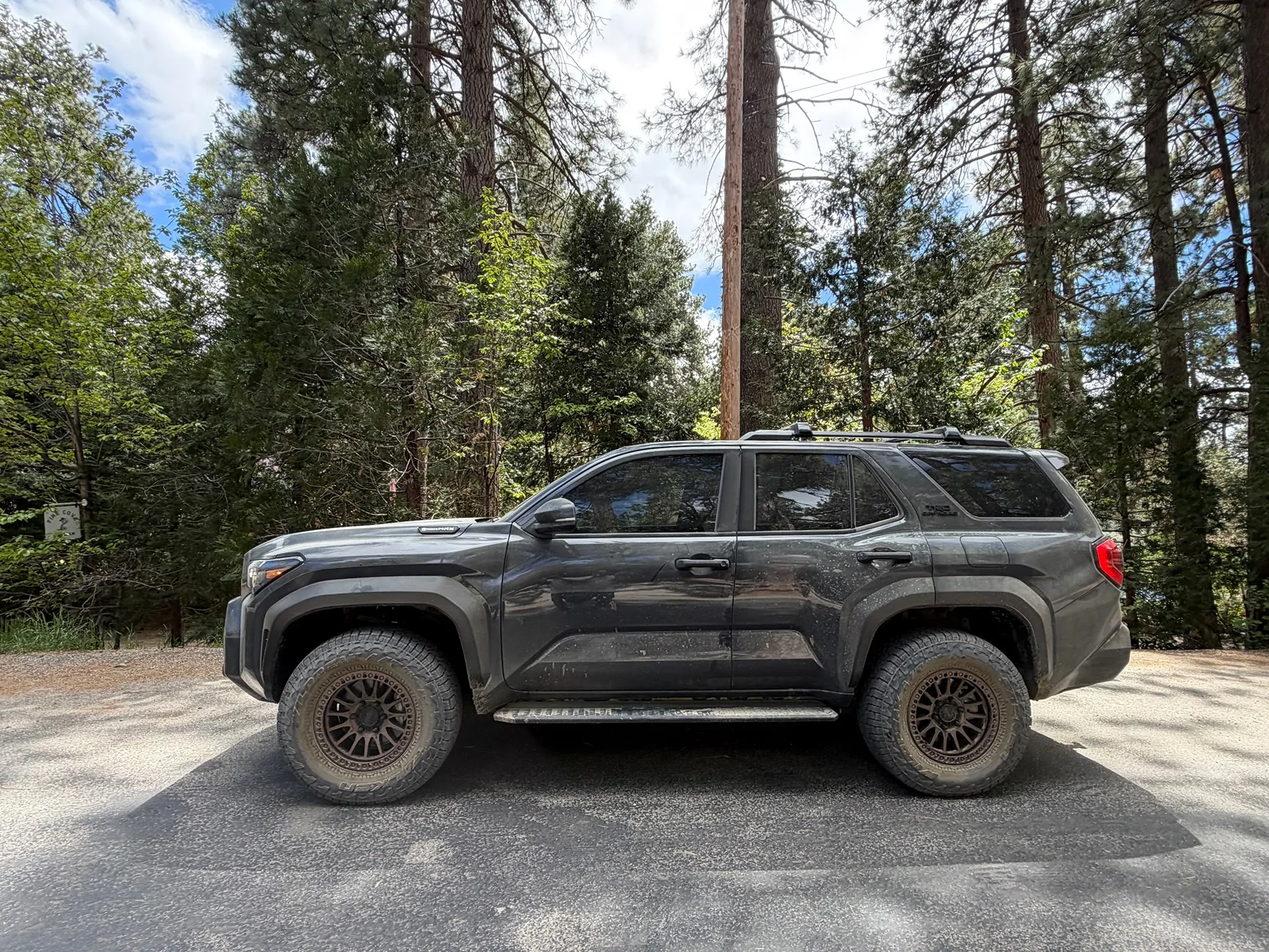

Using RRW RR7-V 17x8.5 +25mm offset wheels and AT4W 285/70r17 tires with a 1.5-inch ready lift at the front only, I observed no rubbing whatsoever, even when executing full side-to-side lock, three-wheeling, or navigating downhill turns at speeds of 50 mph or higher.
