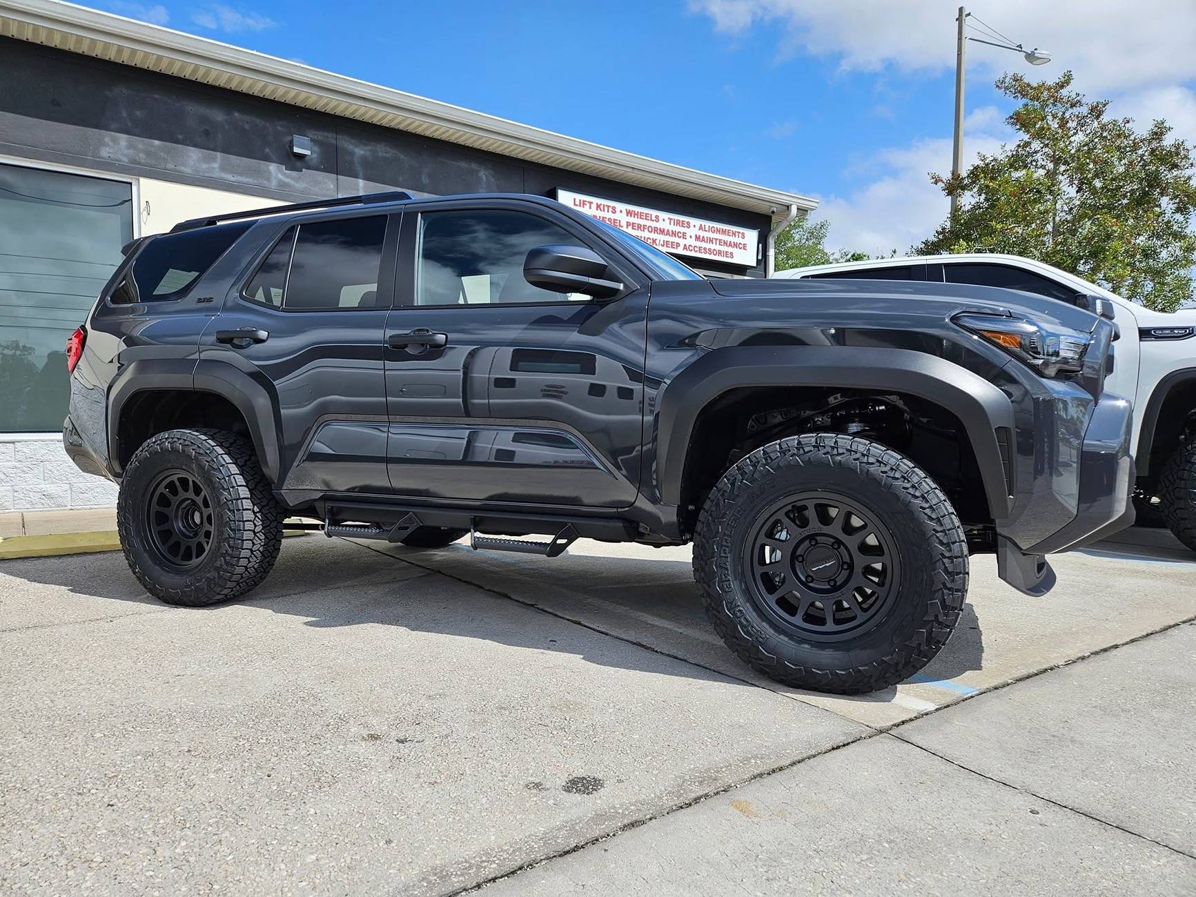

Those are 33s, could have fooled me at first glance! Very nice!

Thats a lot of weight you added to the truck. Sure looks good though

Not sure about this setup but mine is similar with method 703s on 285/70/17 33” Nittos. I am only up 20lbs per wheel so for a net of 80lbs it’s even not noticeable
2025 4runner 6th gen Underground TRD Sport on 2.5" / 2" level lift, +25 offset Method 305, Open Country R/T 295/70r17 (33's) IMG_8114

That looks great! Just curious with the lift did you consider 35" tires or do you prefer the 33"?

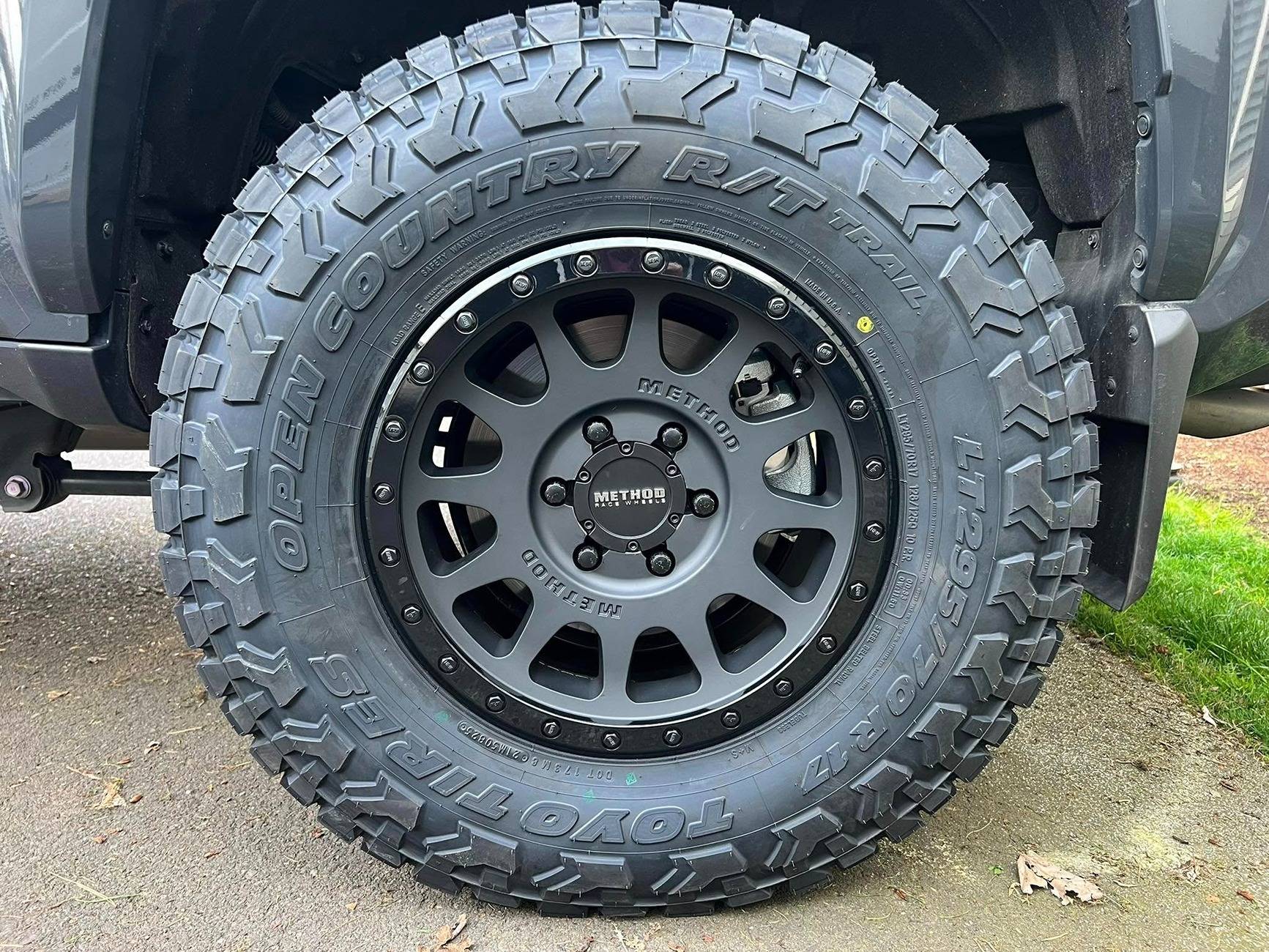

Underground TRD Sport on:
Westcott level kit - 2.5" front lift / 2" rear lift
+25 offset Method 305 wheels
Toyo Open Country R/T tires (295/70/17) - 33's
Barely any trimming required
2025 4runner Underground TRD Sport on 2.5%22 : 2%22 lift, +25 offset Method 305 wheels, Toyo O...jpg
Are those the Titanium centers? Looks like a good match with Underground! Brake clearance is still good obviously with a 17", not sure why Toyota went to an 18", no good D rated sizes in 18's.

2” lift in rear? Any topping out in the rear? Not sure if that shaft is long enough to not clunk over speed bumps
