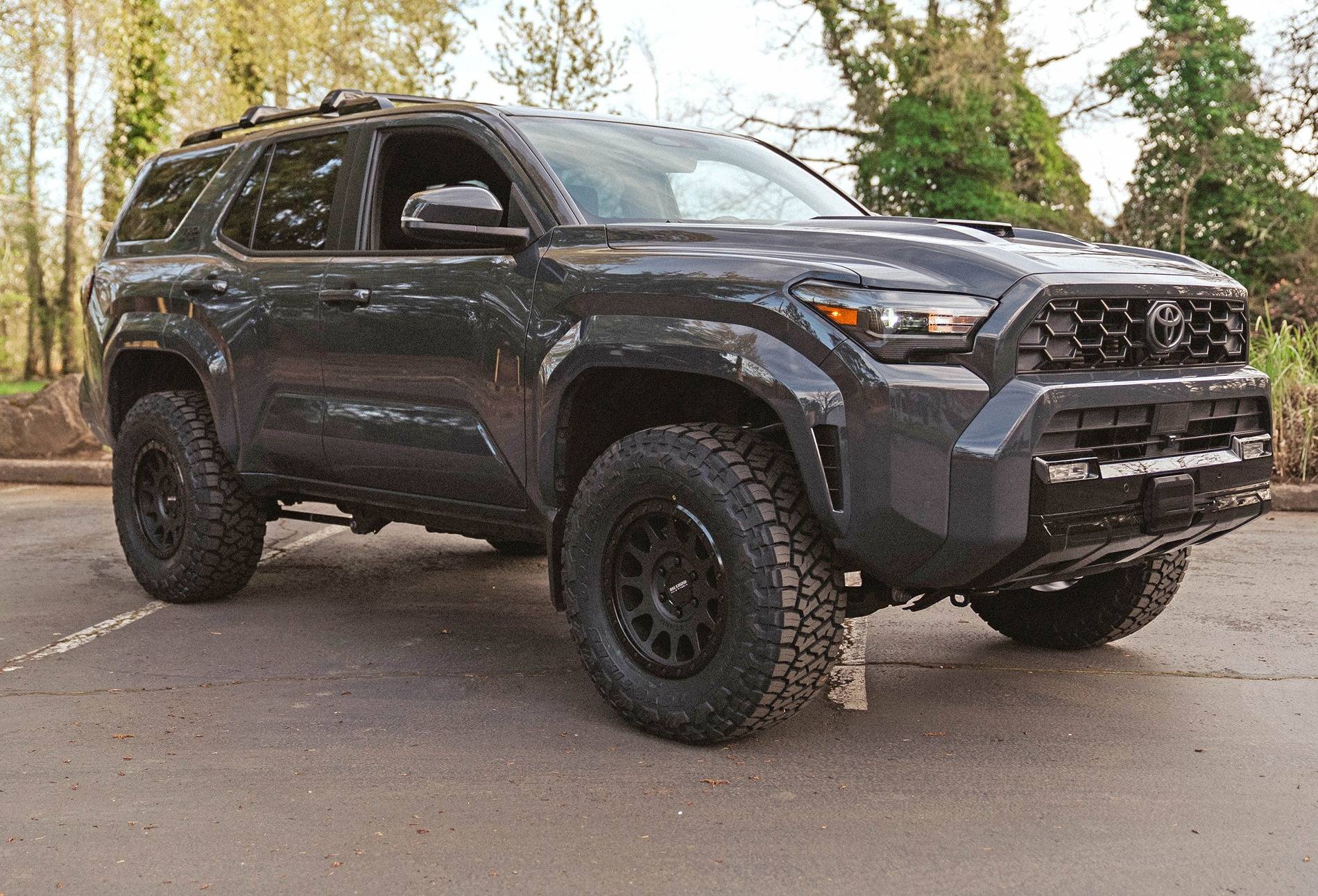

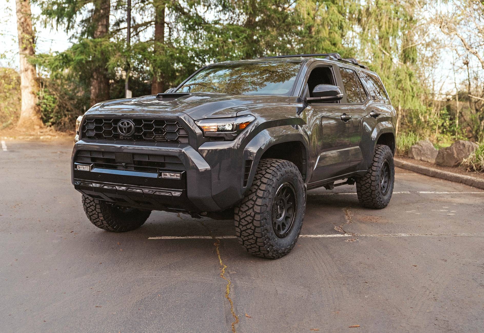

2025 4Runner TRD Sport build by 8RunnerOffRoad
  • Westcott Designs Leveling Kit (6th Gen 4Runner)

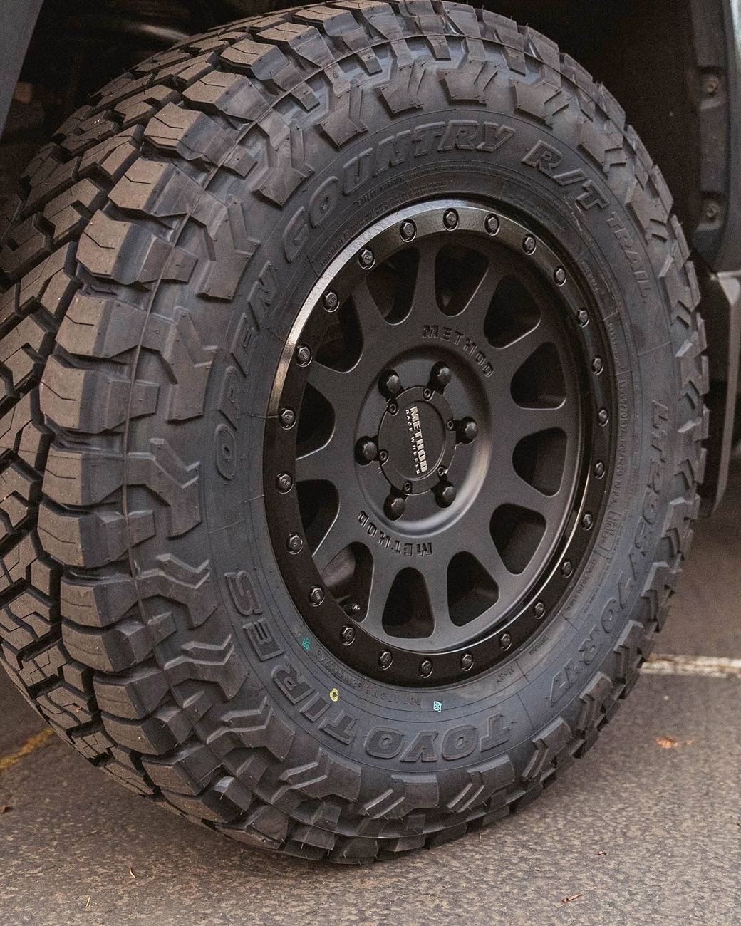

  • Toyo Open Country R/T Trail Tires – 33x12.5R17LT (285/70R17 equivalent)
  • Method 305 NV Double Black Wheels – 17x8.5 +25 Offset (x4)
  • Method Race Lugs
  • OEM TPMS Sensors

very nice! The leveling kit just raises the front with the rear remaining at stock height, is that right?

Westcott preload collar lift raises the front 2.5" and the rear .75" to achieve level.

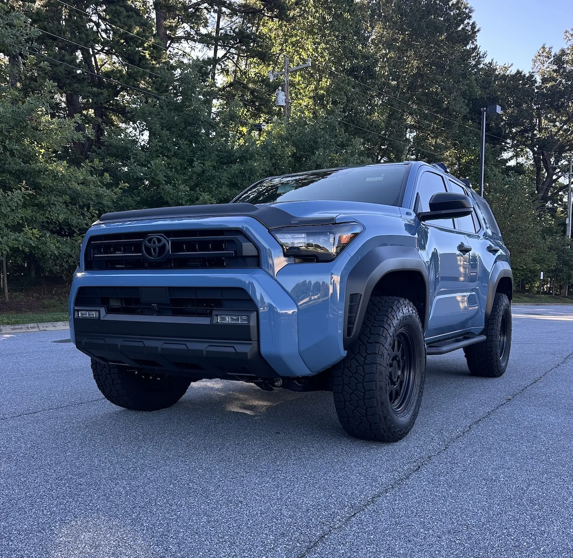

Any rubbing? Is a leveling kit required for no rubbing or just to equal it out?
Depends on tire size and tread design. I run 275/70/17 Falken Wildpeak AT4s and they did not rub before lift or after.
