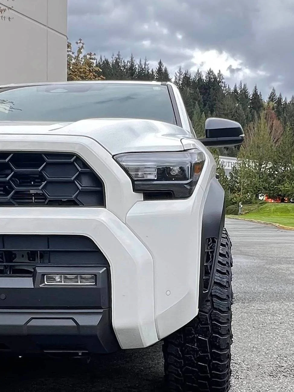

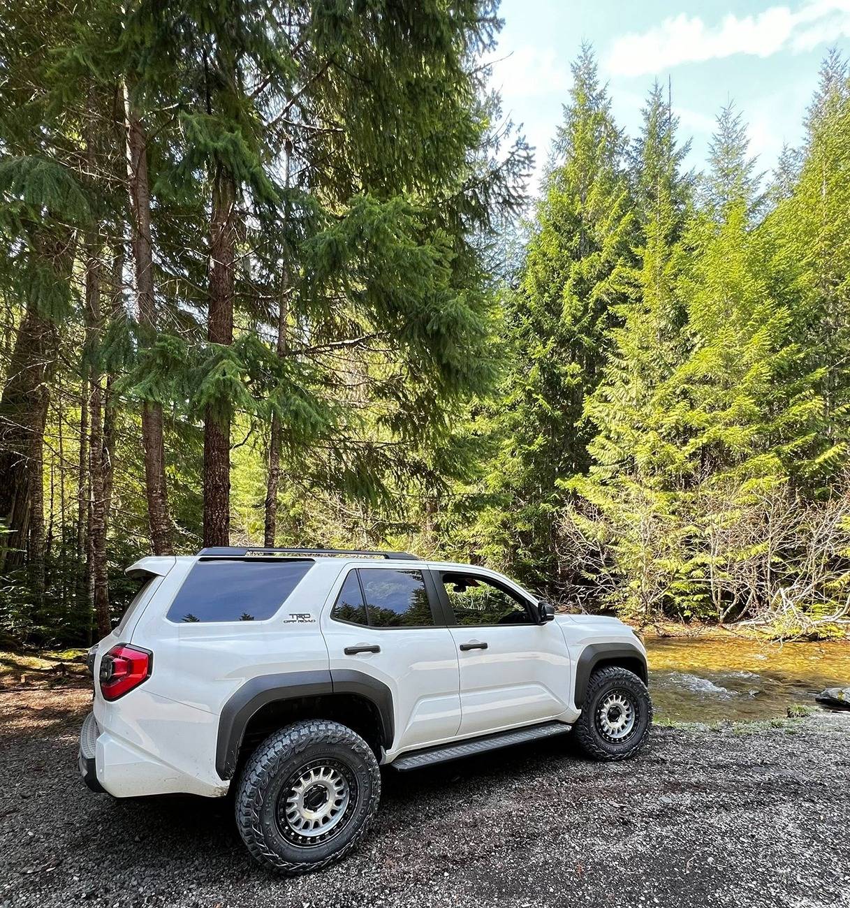

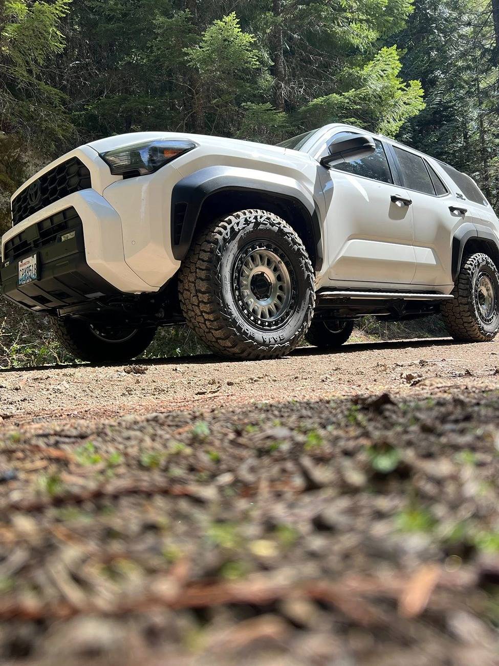

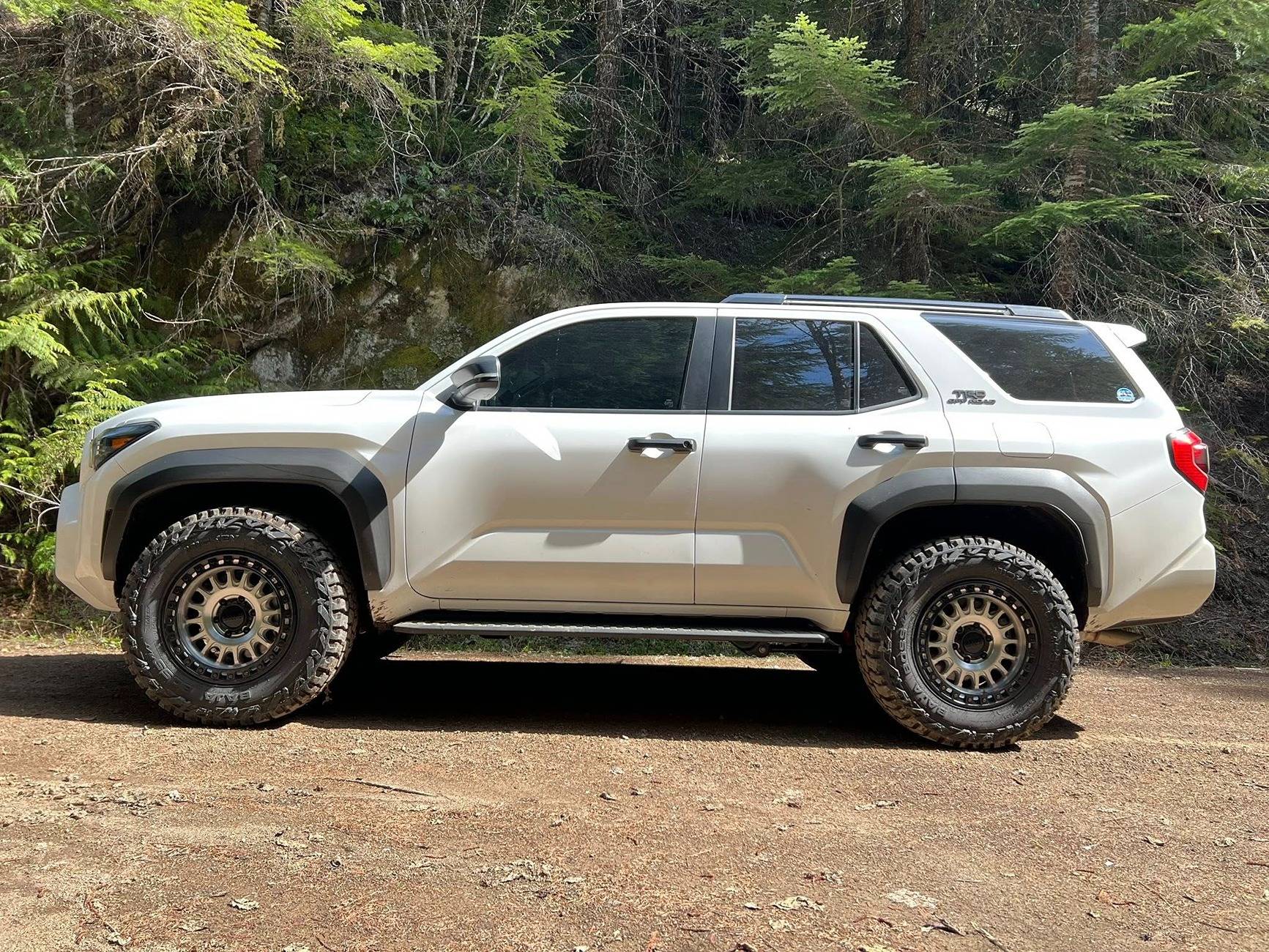

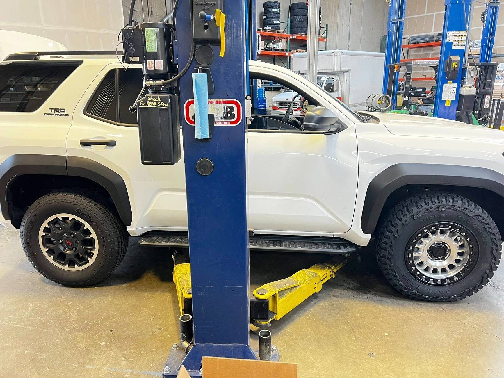

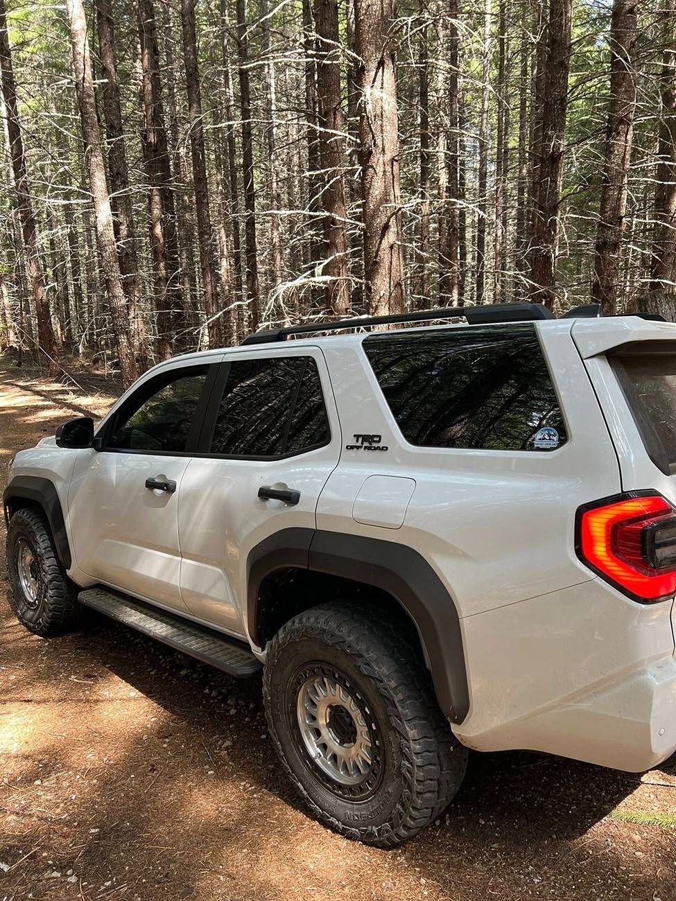

Another wheels & tires setup for reference on a TRD Off-Road Premium ORP. Not mine, but I'm liking this build!
Aftermarket wheels & tires setup:
KMC IMS 18x9 wheels +30 offset
Mickey Thompson Baja Boss A/T 275/70r18.
Stock suspension, no rubbing. Owner says it's close but no rubbing.

Looks good. Just got the same exact build yesterday. Been trying to decide on what to do with the lift as I want to add new wheels and tires, but don’t want to cut or rub.
How Is the ride? Do you have load c?
No rubbing in all drive modes? I have read a few posts where people have had rubbing in Sport mode. Not necessarily your set up, but curious.
Any big changes in mpg?
