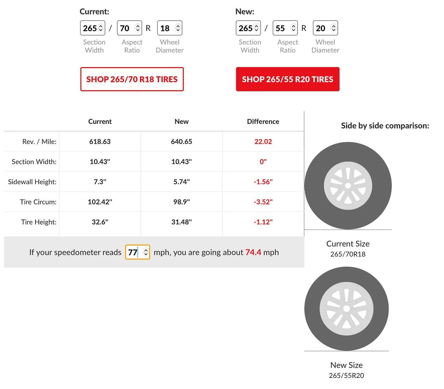

As the title reads, I think my speedometer is off my +2 MPH. I set my cruise control to 77 MPH and I discovered the possibility of it being off by 3 different speed readings that I'll list in order of discovery.
  1. Waze App. I noticed that my Waze was showing me at 75 MPH not 77. I don't know how accurate Waze is but considering it's GPS, I do have confidence it's accurate.
  2. Construction radars on FWY. There was some construction speed limit signs that had radars. I came across 4 of them and all clocked me at 75.
  3. Tachymeter on watch bezel. I have a Citizen watch that has a tachymeter. I measured my speed and yep, 75.
I'm curious to know if anyone else has observed something similar or is it just me? Could it be specific to the tire/wheels I have? Running the 265/55/20. If it is off by 2 MPH, can the dealer recalibrate it to read accurate?

Any way I been running tire 2” taller on a vehicle over 6 years. The speed odometer is off in every speed. At ten mph its doing 12, fifty mph it doing 52mph. We talking about 2mph just drive two mph slower. The average person drives over the speed limit more than 2mph every day. If You have brand new tires 33” tall their is a rotating speed. At 40,000 miles of driving wear and tear your speed odometer will be off a little. Those 33” tall tires are now 32.5 or 32 inch tall.

I was wondering about calibrating myself. When I went to 35" tires on my Tacoma I used the Rough Country Speedometer Calibrator. It was worth the expense because it was so far off. The speedometer would say 75 I was really going around 81. Currently my speedometer is within .5 mph of everything I tested it with. I have a TRD Off-road with the stock 265/70R18 and I am going to be replacing them with some slightly larger BFGoodrich KO3. It's possible that this is basis that Toyota sets for all of the 4Runners regardless of tire size. When you calculate the size of the tires you have and compare that to what I have you will run around 2mph slower. I had this issue with my mini Cooper when I first purchased it. I replaced the tires with a slightly larger diameter and it was dead accurate afterward. I was annoyed because when the speedometer reads slower you're racking up miles faster than you actually are and will skew the gas milage numbers.

In particular I'm somewhat worried for SR5 as it's on the order of 7% difference between 30.5" and 32.6" - even if 32.6" was spot on that's still like 5mph difference at highway speeds. I have my doubts that Toyota, with a history of lazy one-size-fits-all speedo programming, cares enough about the single significant outlier model to correct the speedo for SR5. Just gotta throw away that 245/70R17 trash asap I guess

The Limited trim comes stock with 265/55/20 so they are the OEM tire/wheels. I believe the Platinum trim is also running this size as well as the TRD Sport as @theo mentioned.

@RollingRocker mentioned this in a reply above and it went over my head but now that both @Vincenzo and @spyder40 mention it again, it clicked. I wasn’t too worried about the speedometer being off, I just figured I'll drive a bit faster so I go my intended speed but if this is going to impact my milage warranty than I'll look to getting it corrected. Wondering what the dealership will say, I have a feeling they'll try to brush it off as a minor thing.
