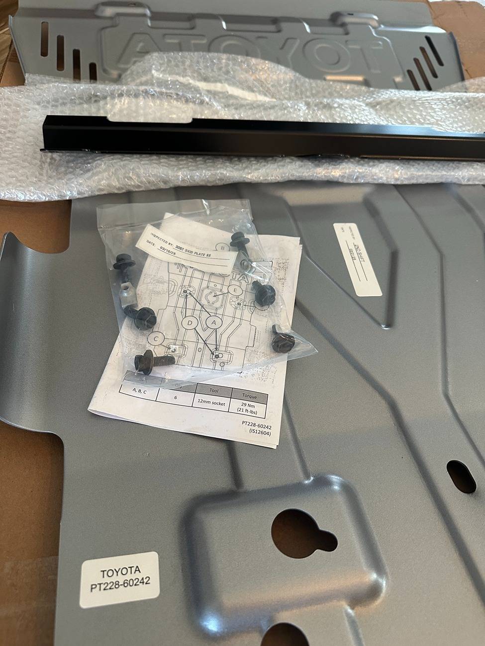

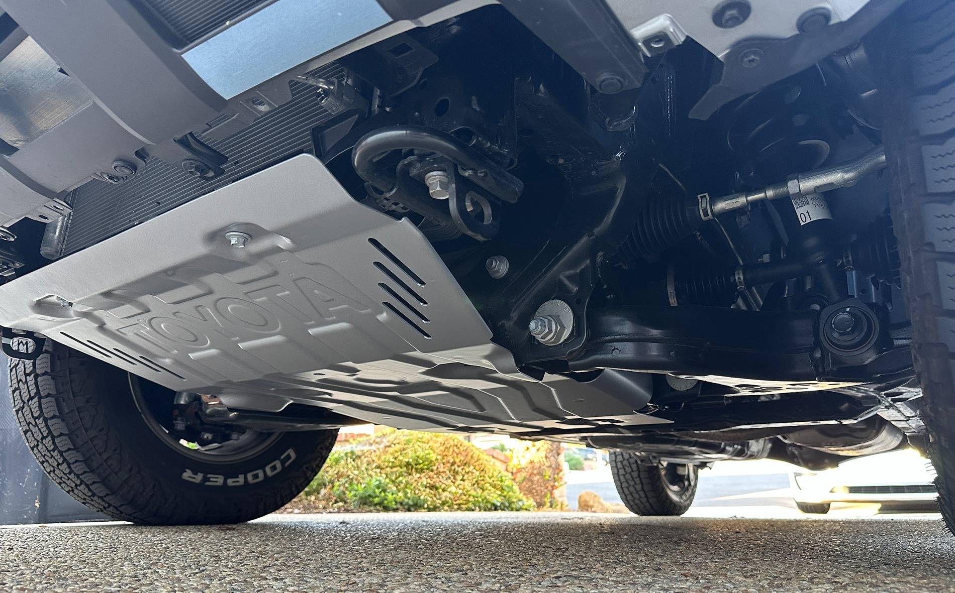

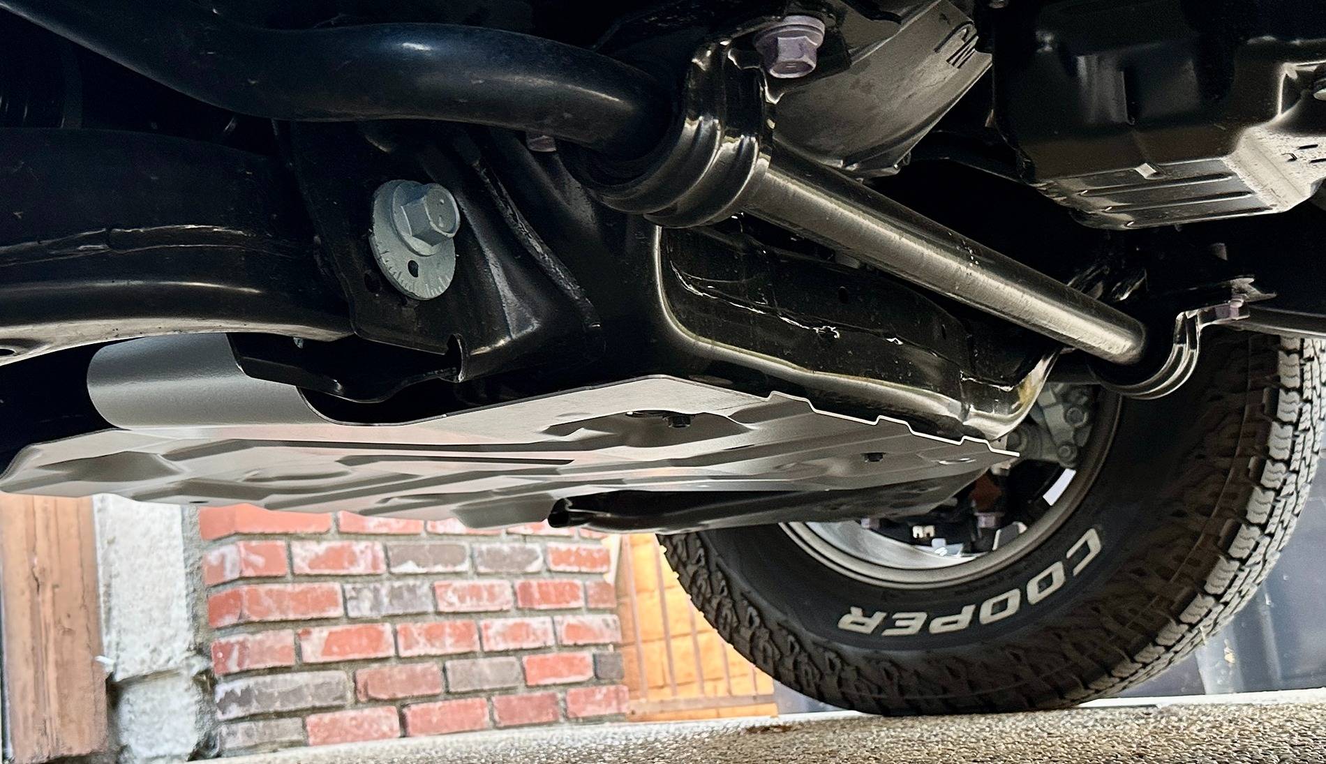

I had the same question about the garbage skid plate... Someone just confirmed with a photo that the Tacoma skid plate will fit the 4Runner. I'm on the fence now between the OEM skid or an aftermarket. I found this to be quite a deal on Rough Country's website.. $149 to replace the crap Toyota put on there.

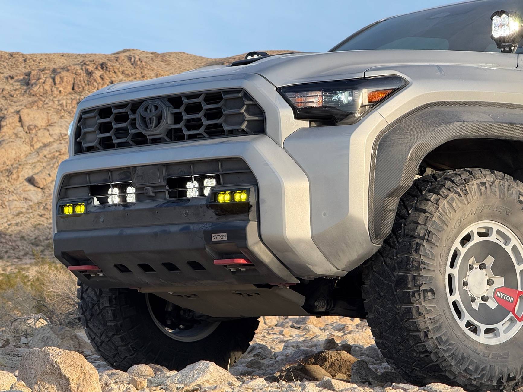

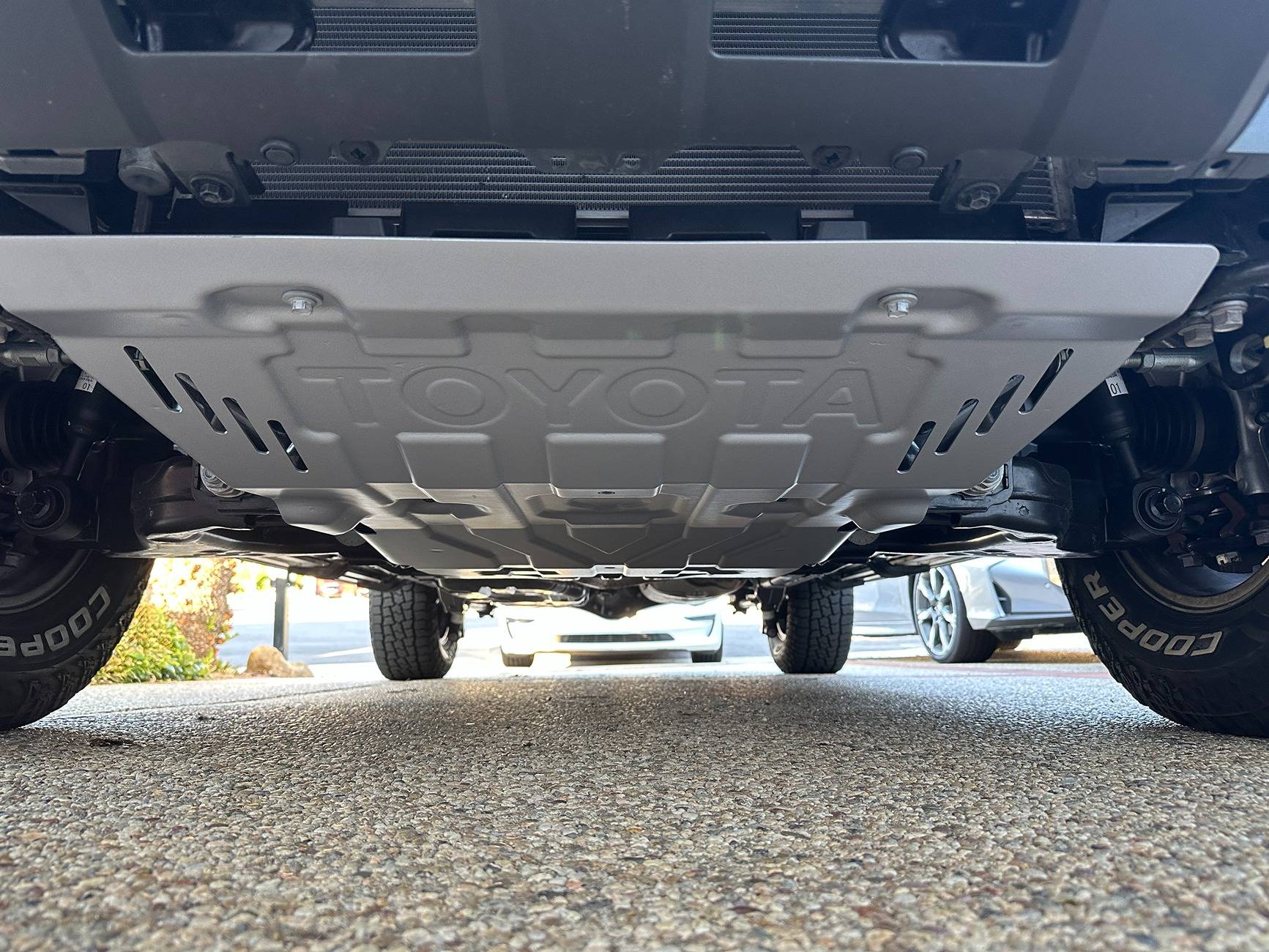

Hi all! The 6 Gen 4Runner ALL come with the front crossmember, no matter what trim level (unlike the Tacoma). They are ready to mount any skid plates.
Thank you very much for your post! That information really helps. I really like that bumper also! Is it a part that a novice can install at home?

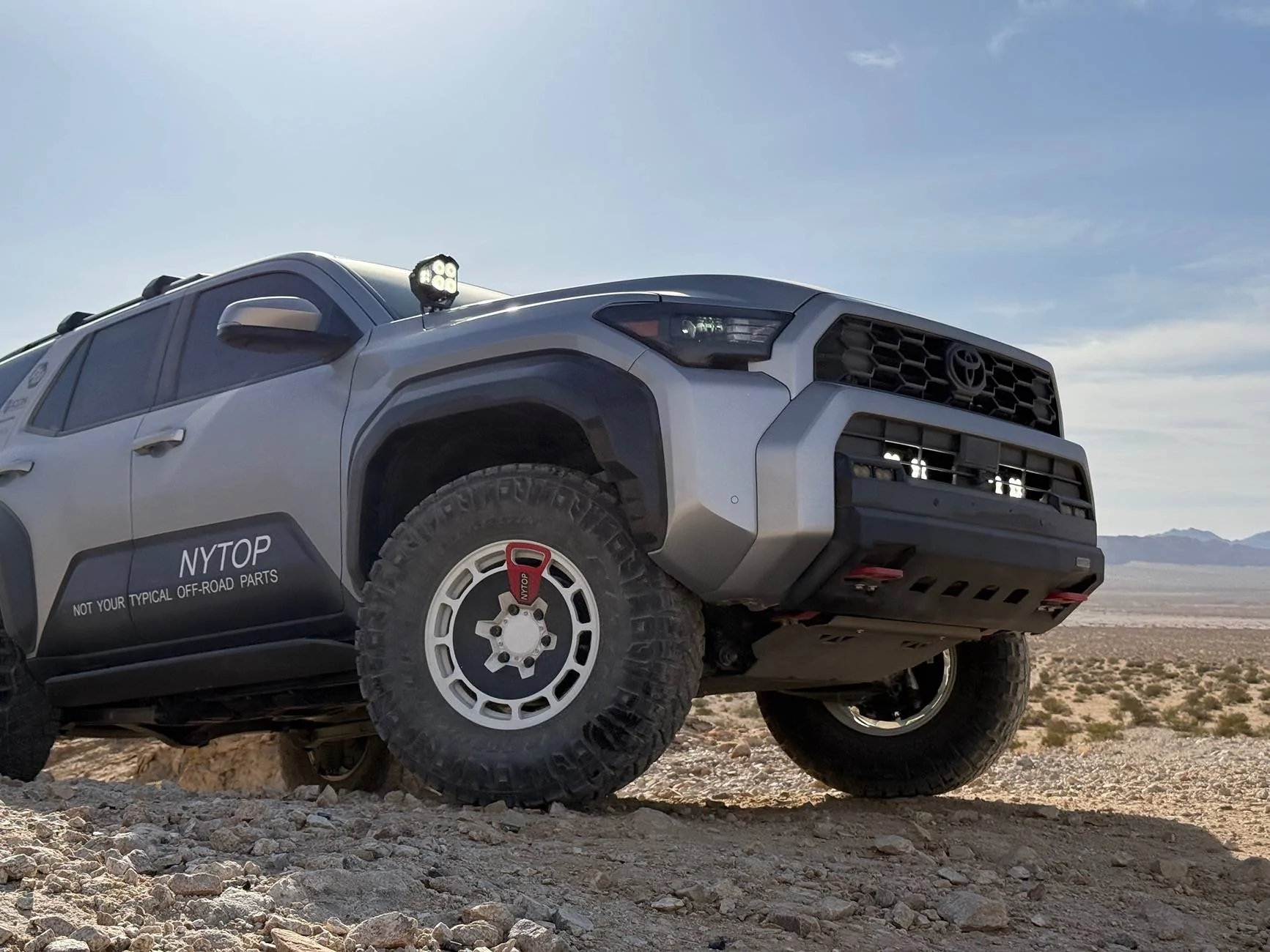

Thank you very much for your post! What information really helps. I really like that bumper also! Is it a part that a novice can install at home?
Yes, our parts are all very DIY friendly!

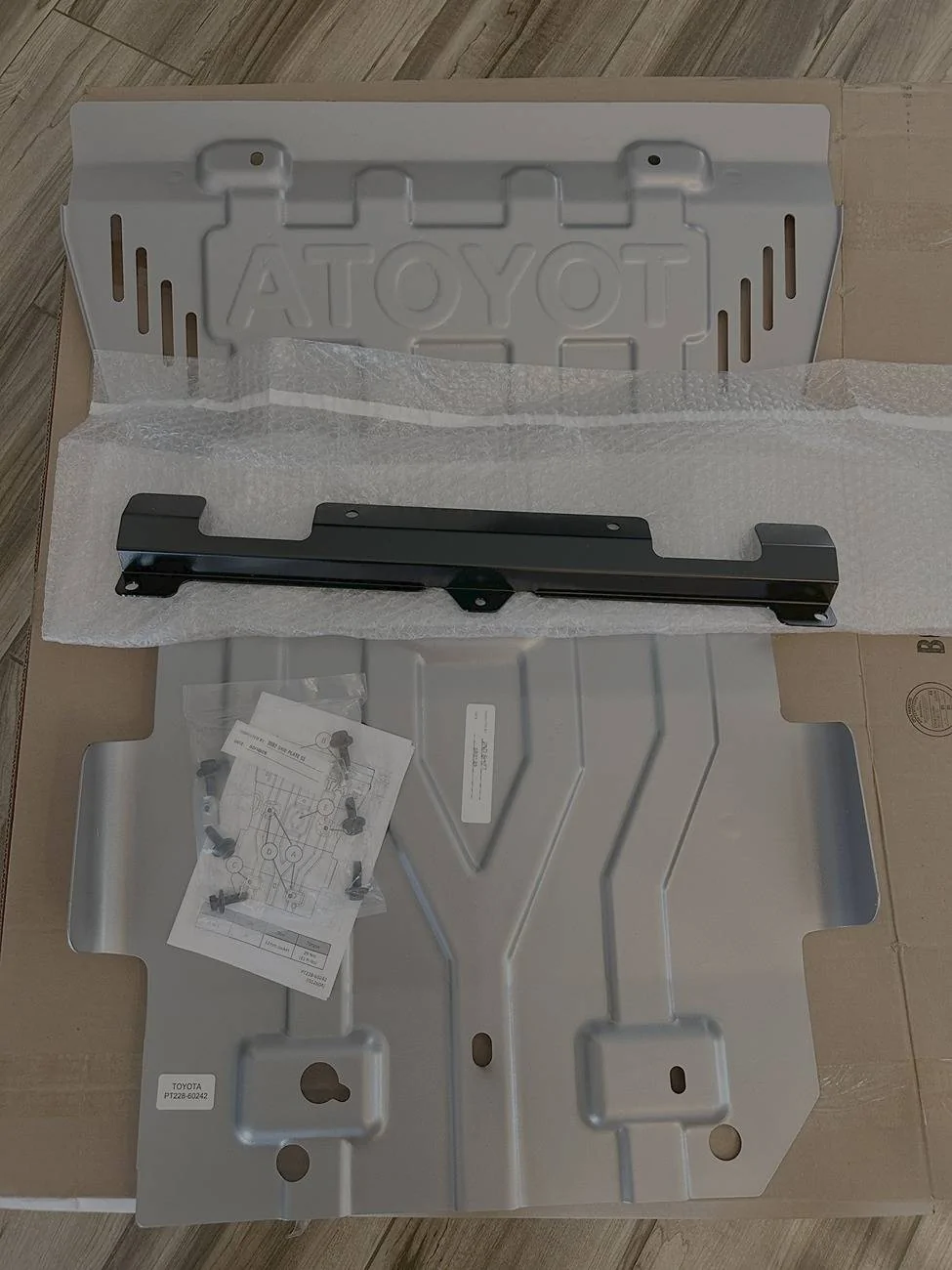

So you were about to confirm that this fits on the 6th gen 4runner?
The OEM ones and our NYTOP ones will fit because both are designed with a slotted hole in the middle crossmember area, to compensate for slightly different bolt hole locations between the Taco and the 4R. The RC one doesn’t look like it does. So most likely you will have to drill new holes for those ones to fit.
