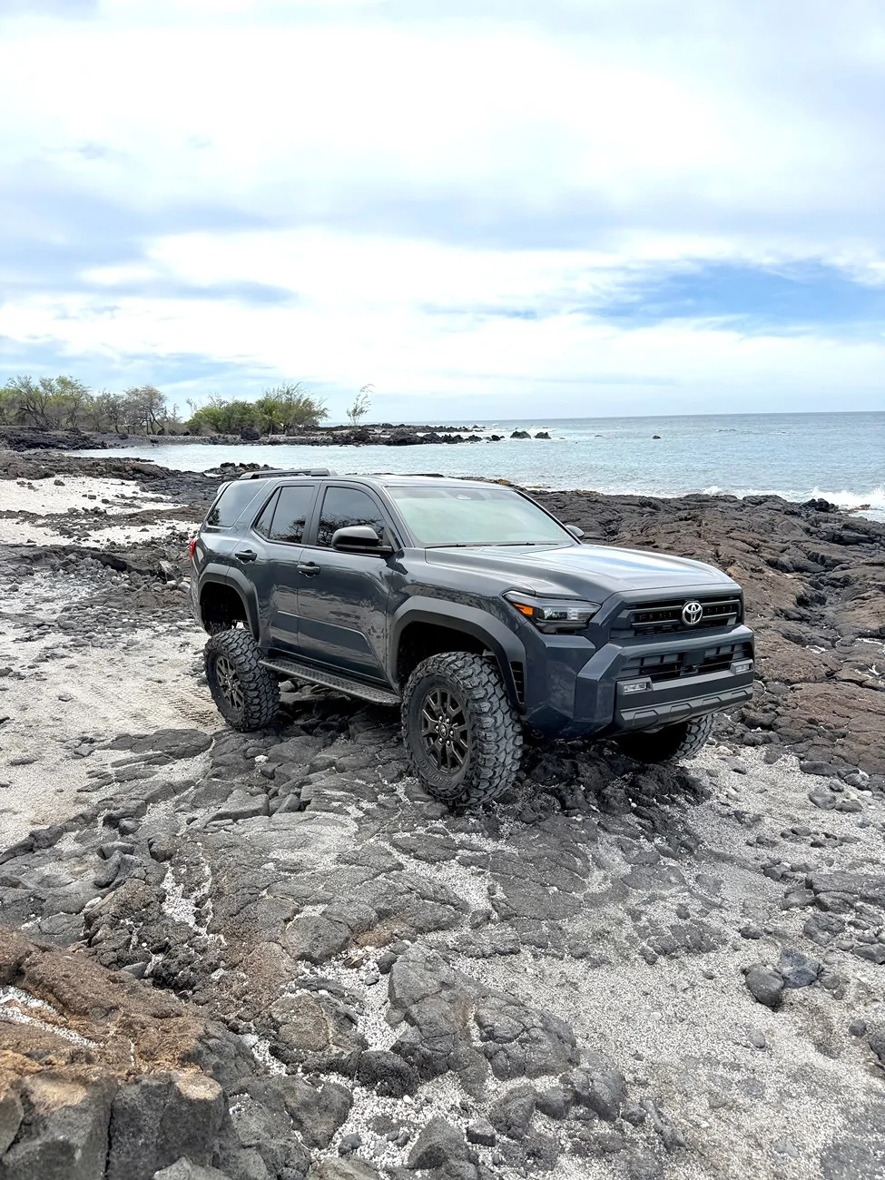

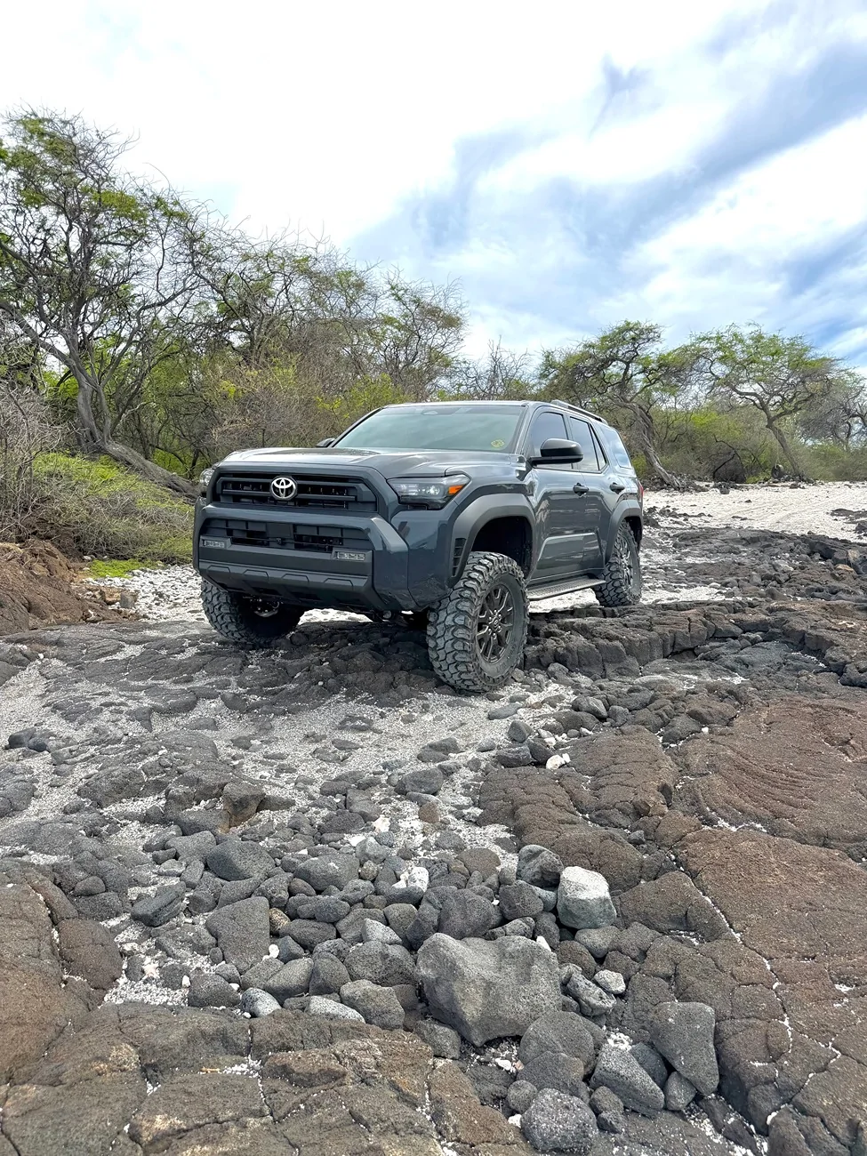

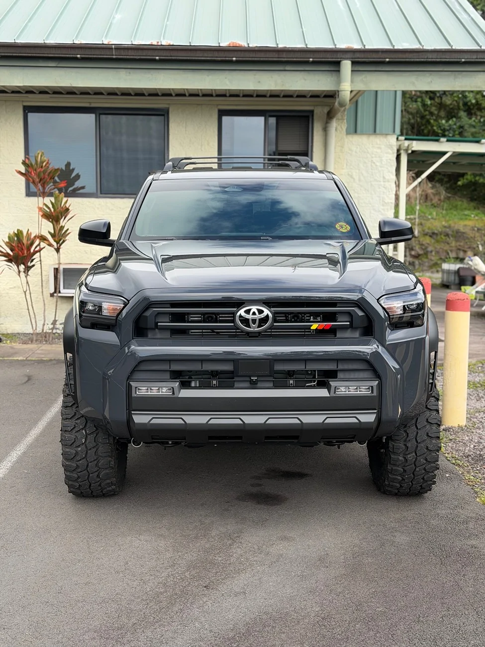

RSPNDCO Active member First Name Matthew Joined Apr 11, 2026 Threads 3 Messages 28 Reaction score 50 Location Kailua-Kona, Hawaii Vehicle(s) 2026 Underground 4Runner May 7, 2026 #2 I got the M1 coil overs put in, but not the reservoirs. I figured the reservoirs were not needed for what I’m doing.

RSPNDCO Active member First Name Matthew Joined Apr 11, 2026 Threads 3 Messages 28 Reaction score 50 Location Kailua-Kona, Hawaii Vehicle(s) 2026 Underground 4Runner May 8, 2026 #5 I am running 295/70/17 No trimming and no rubbing even off road The ride is smooth. But with my load range E tires it firms it up a bit. Overall ride would be softer if you ran a lighter duty tire. Also running a 1” wheel spacer to clear the upper control arm with the stock wheels
OP OP 1stRunner Member First Name George Joined Mar 24, 2026 Threads 4 Messages 22 Reaction score 5 Location Ohio Vehicle(s) 2026 4Runner TRD Offroad Premium May 15, 2026 Thread starter #6 Awesome thank you so much, yours looks SWEET!
