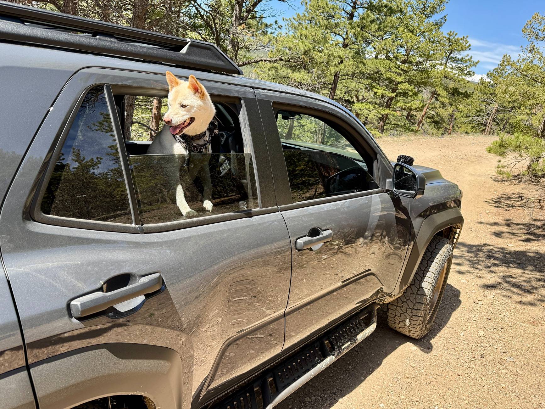

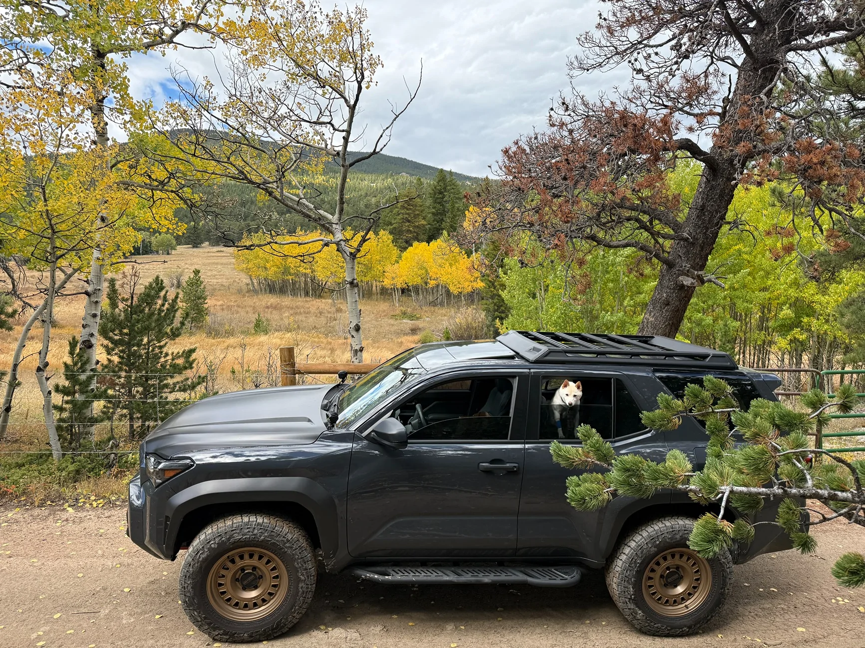

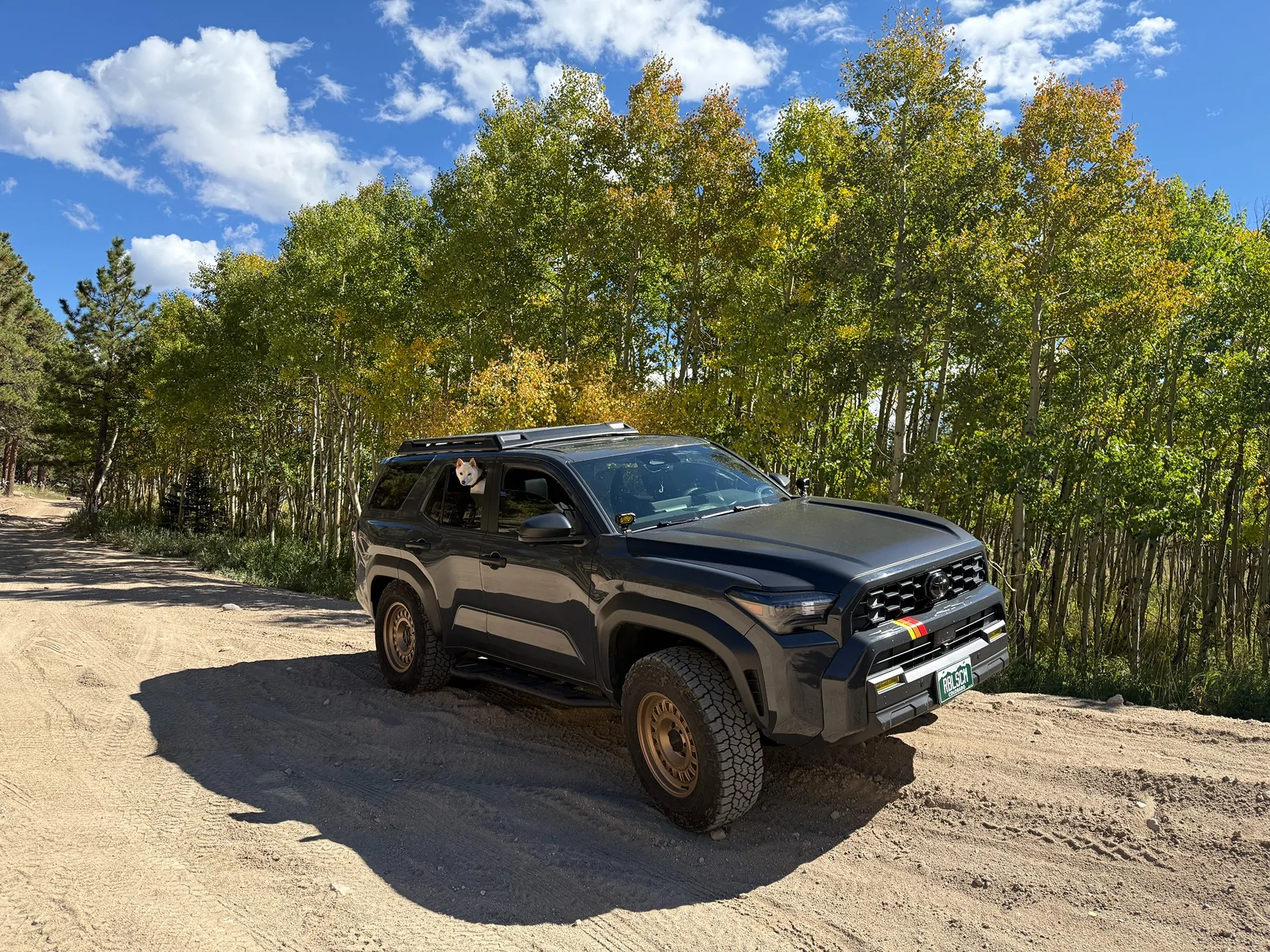

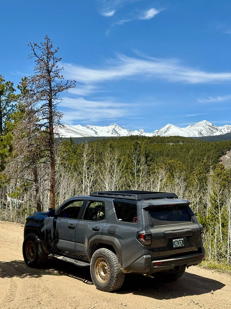

Been building since February and I've posted most of these in different places here but thought it may be helpful to consolidate in one place. Happy to answer questions, take photos of specific mods, so feel free to ask. Here you go!
(Total: ~$8,700 give or take)
Exterior & Lighting
  • Illuminated dark chrome front emblem (Toyota)
  • Matte black & bronze badge inserts (Toyota)
  • 3M hood wrap
  • Pro tail lights (Toyota)
  • LED front turn signals (Lastfit)
  • Sequential mirror turn signals (Tacoma Lifestyle)
  • Auxbeam ditch lights + CBI brackets
  • Window tint (Scorpion)
  • Marker/Raptor lights
Protection & Recovery
  • Front skid plate (Toyota)
  • Westcott rock sliders w/ kick-outs
  • Recovery points (Toyota)
Performance & Handling
  • 1.5” front lift (Rough Country)
  • OTT tune (Colorado Toyota Tuning)
  • Method 320 bronze wheels +18 offset
  • Falken Wildpeak AT4 tires (275/70R18)
Interior & Tech
  • Garmin Mini 3 dashcam
  • Dongar Pro harness
  • Instrument screen protectors
  • Floor mats (Lastfit)
  • Rear cargo area lighting (Toyota)
  • Hood struts (Redline Tuning)
2025 Toyota 4runner RELLIMS build thread (Full List) - Off Road Premium (Underground) IMG_7715 2.JPG
2025 Toyota 4runner RELLIMS build thread (Full List) - Off Road Premium (Underground) IMG_7729 2.JPG
2025 Toyota 4runner RELLIMS build thread (Full List) - Off Road Premium (Underground) IMG_7718.JPG
2025 Toyota 4runner RELLIMS build thread (Full List) - Off Road Premium (Underground) this one
2025 Toyota 4runner RELLIMS build thread (Full List) - Off Road Premium (Underground) IMG_7723 3.JPG
To head off the "Why didn't you just get a Trail Hunter" comments, it's simple to me. Built my way for exactly what I wanted, not bought with things I didn't care about or dislike (think snorkle). The 2 Trail Hunter upgrades that will happen in the future once the after market catches up and I pay it off this year are suspension upgrades and full under body armor.

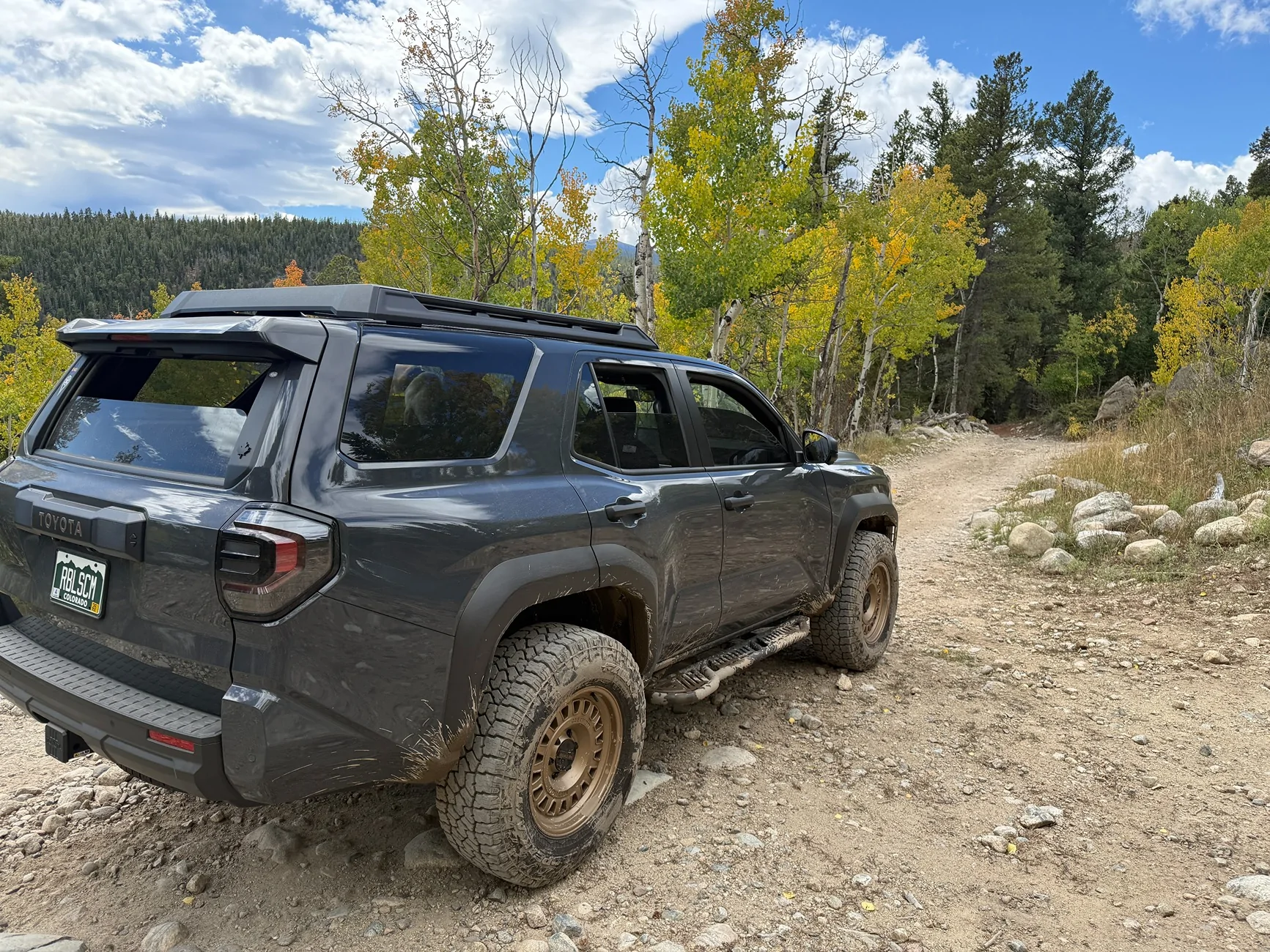

I`m looking at getting some +18 offset wheels with my current 275`s ...Are you haveing any rubbing at all on the front?
Are the rear tires tucking into the fender well under articulation?
Rellims
Rellims
Sean
Jan 14, 2025
393
467
ORP - Underground
The front tires rubbed slightly on the front side at full lock when I had no lift. Once the 1.5" lift was installed no rubbing. I've done some mid level trails with some articulation and didn't feel it hitting the fender well.
